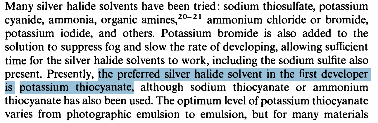

Potassium Thiocyanate has been the preferred halide solvent in professional B&W reversal processes including Kodak, Agfa Scala and Orwo. Dr5 is an exception, but they don't use a halide solvent in their first developer apparently and nobody has complained.
Haist, Vol 2, page 319.
