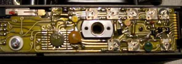

Hi
I have Pentax ES camera. Of course I bought it as a used one. The guy who made CLA of the camera said that someone had to intervene in the electronics before. It looks like some wires connected to the main plug are mistakenly soldered.I mean the black plug from the bottom of the camera.(you have to remove bottom cover, electronic PCB is inserted in the plug).
I looking for any picture of that plug. Could you help me please?
greetings
JW

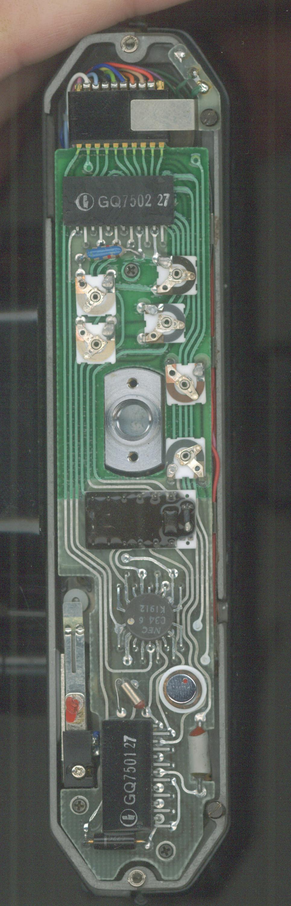

OK here you are. This is an ES, not an ESII.
Dec 13, 2012
9
THANK YOU VERY MUCH!!
I think it is exactly what I was looking for!
I'll check the connections in my ES this evening
greetings
JW

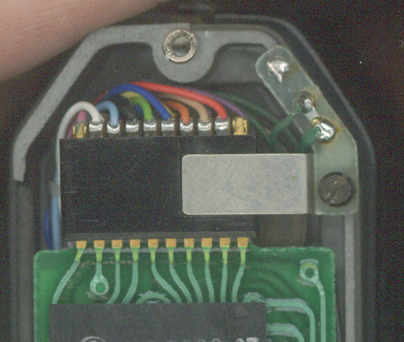

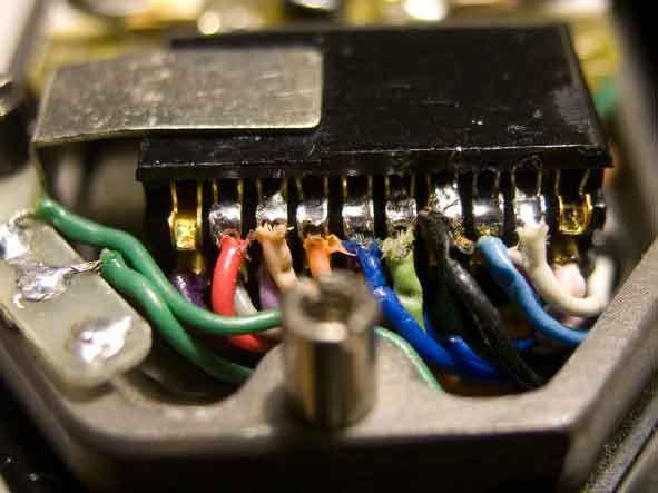

Dec 13, 2012
9
So, It looks like the wires are ok. (at least the top row, I can't see the bottom)
I wonder why these is completely different PCB in my Pentax?!
(By the way.The problem in my camera is that in manual speed mode the shutter is electronic controlled all the time unless the battery is removed.)
Anyway thank you very much for your help
JW View attachment 74055 View attachment 74056
Boy, that's a mess. Some boob has been in it for sure.
