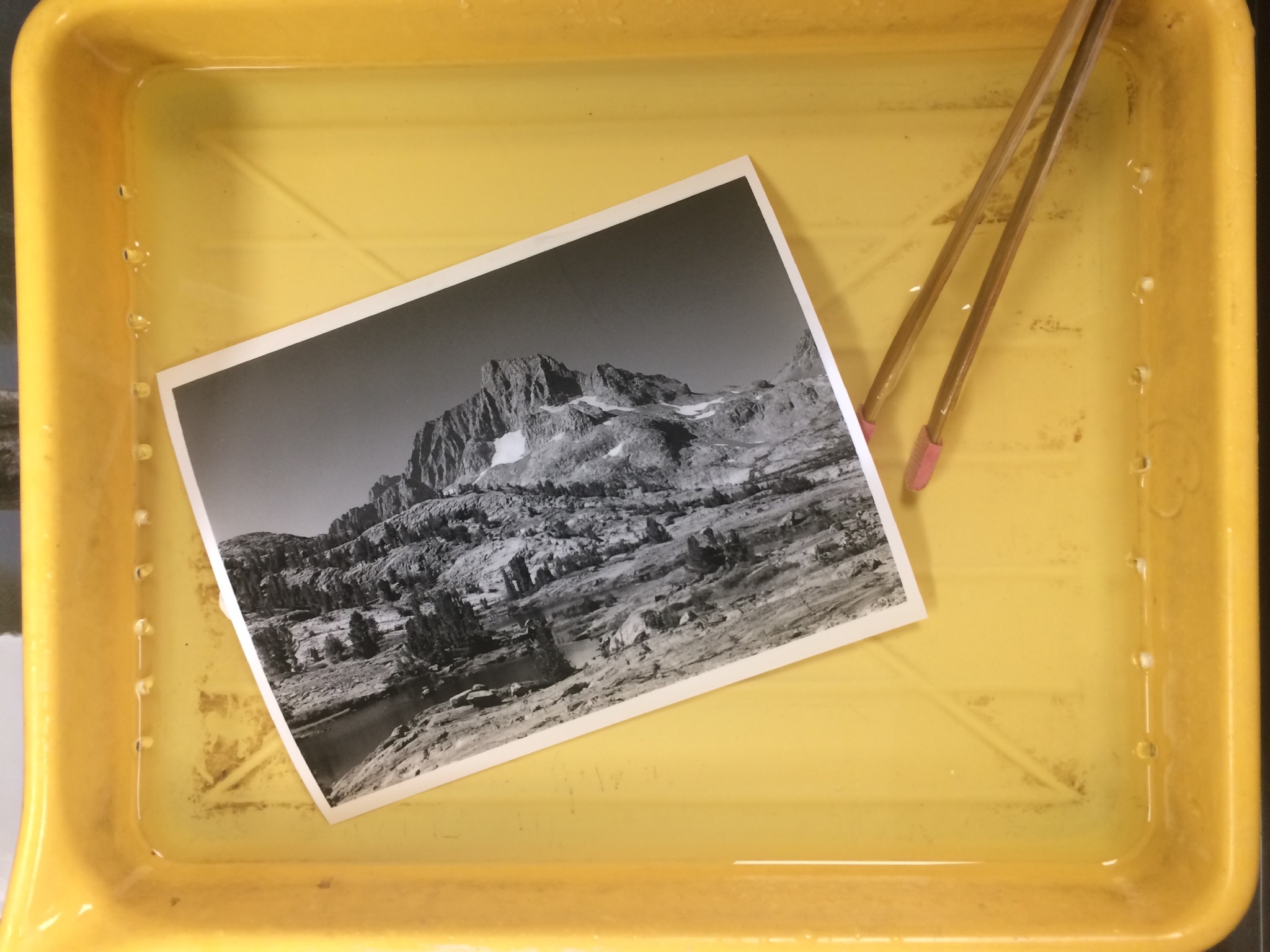

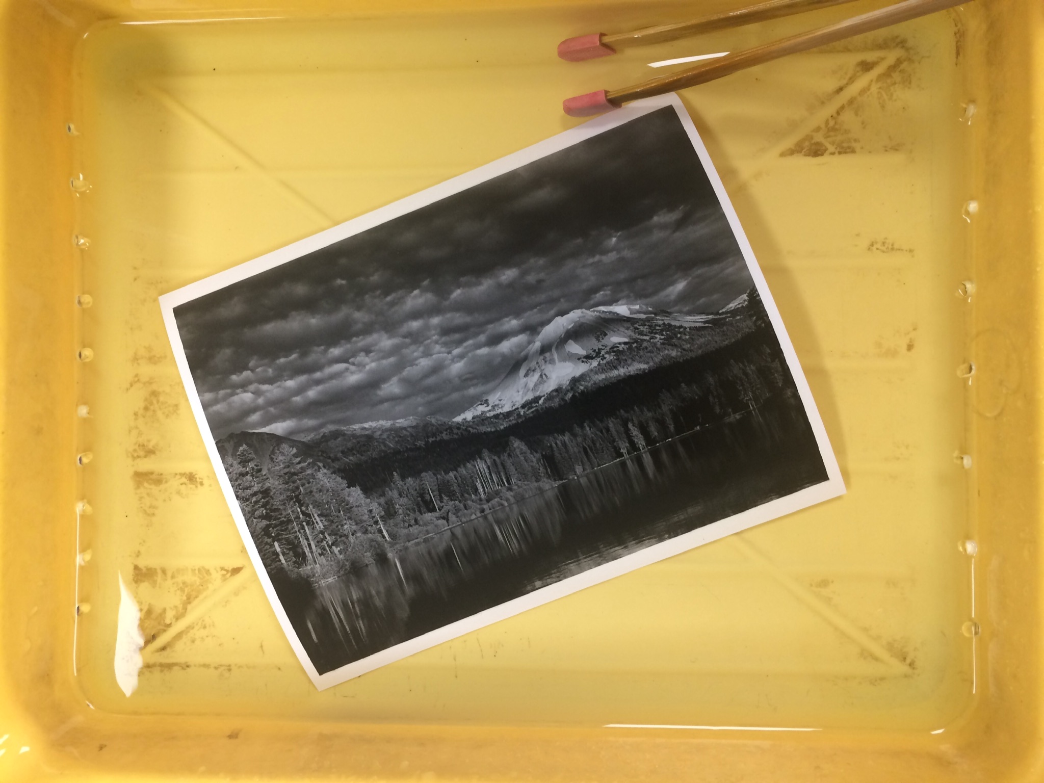

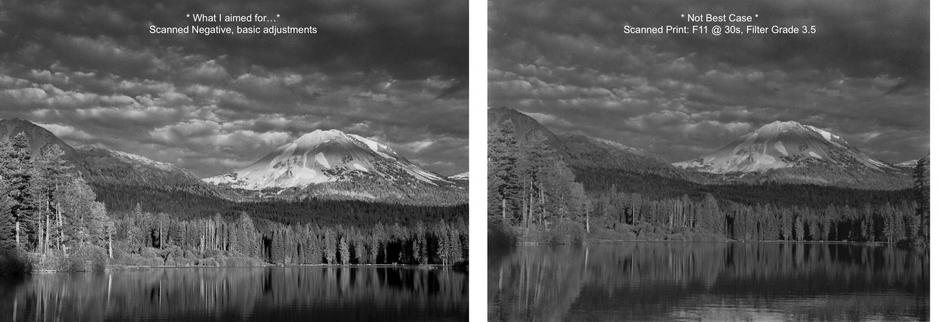

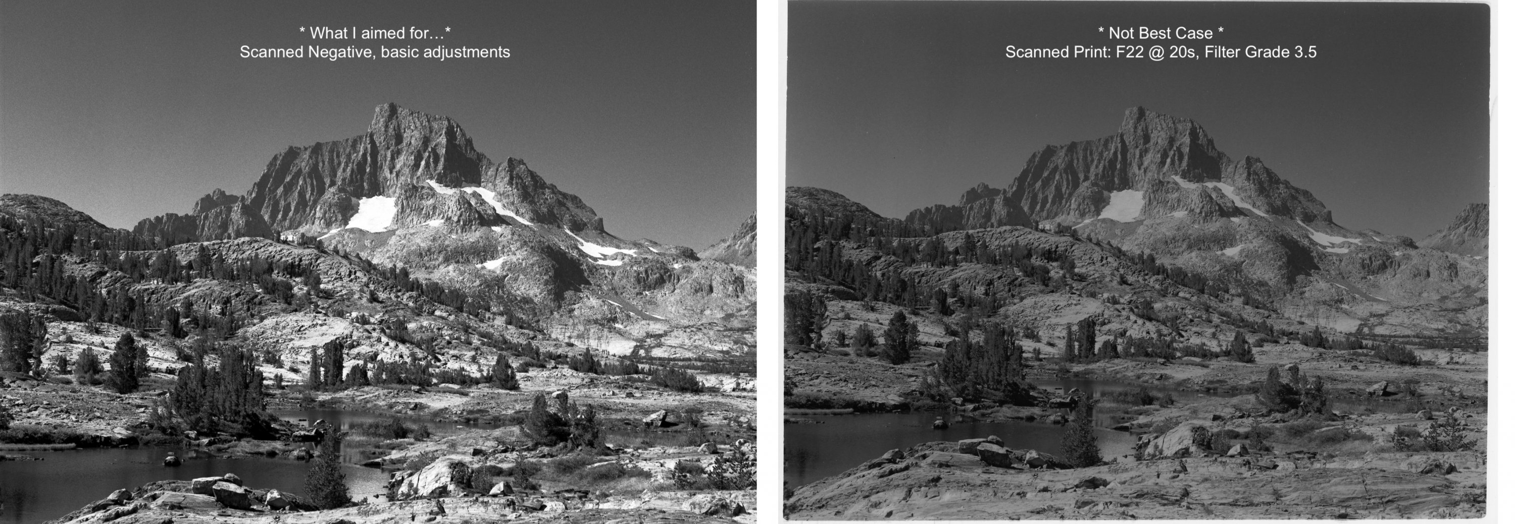

The above images are the images I was working with. The left side is what I achieved by scanning the negatives and doing basic adjustments in Lightroom with contrst, brightness, curves, etc. They are what I was aiming for (more or less) with my darkroom prints. On the right hand side are the scanned prints I made in the darkroom.
The enlarger I used had built in filters and it maxed out at an equivalent filter grade of 3.5. With a filter grade maxed out at 5, would I have been able to better "rescue" the whites/blacks? Is there a large jump in contrast, usually, from 3.5 to 5?
Be sure to check the safelights with your paper. Your prints do look slightly fogged. And if the negative is normal, you shouldn't need a higher than 3.5 filter to get unfogged results.
That being said, you can increase the contrast by adding a below the lens 4, 4.5, 5 or 5+ filter. And there is a definite difference between 3.5 and 5.

Try to match the highlights of the digital prints in your darkroom prints--if they cannot get that light, then the paper is either fogged or being fogged during your printing session. You could also develop a blank sheet as normal and if it comes out grey, then it is fogged.
If you can match the highlights and the darker tones are too light, then you need more contrast. But I suspect with the good tonality of the digital prints that the negatives are good and the issue is with fog. Maybe you have light leaks in your darkroom or maybe the safelights are not safe enough. I prefer red safelights for modern variable contrast papers.

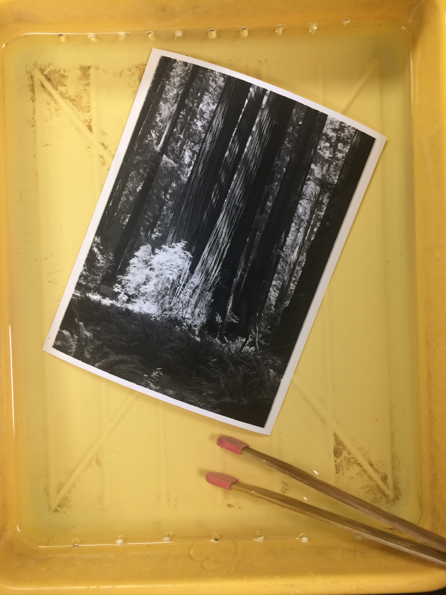

I've found out my problem (user error)... I didn't realize the enlarger I was using had a lever to engage and disengage the filter. I've never used enlarger filters so I didn't know what the light was suppose to look like (there's a big difference between no filter and filtered). So the entire time I had the filter disengaged which is why my prints lacked contrast.
I also dimmed the safelights more, just in case (though this probably wasn't my problem).
The results I'm getting now are much better.
