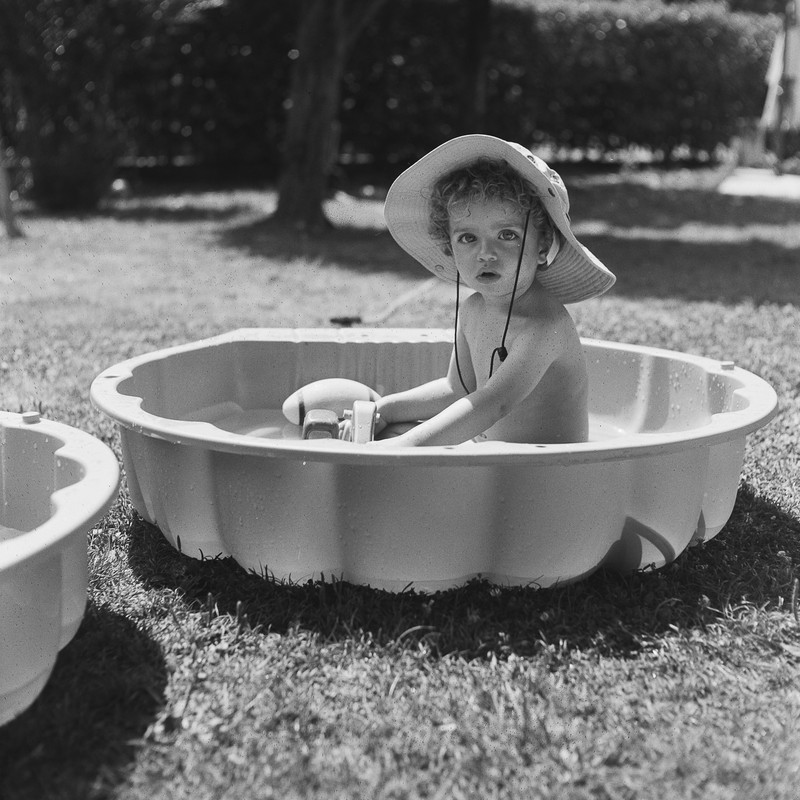

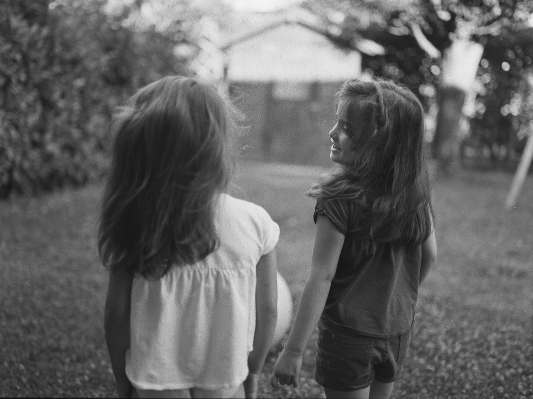

I have a bulk roll of FOMA 200 still in one loader (Computrol), that has not felts, and it has a long longitudinal thin scratch that shows in the prints. See the picture below, right across the shoulder of Beatrice. Also with 120 format I had problems with tiny spots that also appear in the prints.... they can be seen enlarging the pics below
Therefore, I believe that the issue raised by the OP might be related to the inconsitent quality between batches of film. If not already suggested, to exlude problems with the bulk loader, you might load a cartridge by hand a check the resulsts.

Every time I watch the print I swear at FOMA! Maybe time has come for me to learn spotting and retouching.... :smile:

As @Nitroplait says, it's very useful. But sadly, the kind of line/stripe you've got in that marvelous portrait is very difficult to remove. Low-density marks (such as dust etc) are far easier to patch up. Getting rid of a high-density line is far more difficult. One approach is to apply farmer's reducer or (better) highly dilute rehalogenating bleach (ferricyanide +bromide) with a small brush, followed by fixing. If you take the bleaching too far, you can at least redevelop the spot and try again after a thorough wash. With farmer's reducer, there's no going back and you'd have to add dye if you take it too far.

I will for sure try out spotting since I recently started printing on fiber base paper and, given the efforts, I agree that is better retouching then reprinting. A little different with RC paper where I often reprinted in case of dust spots..
I also understand that it will be very difficult to intervene on a dark scratch as in the case of the picture of my daughter. Anyway, there are plenty of other my prints that need spotting... :smile:
@Don_ih , yes for sure digitally must be easy to fix that scratch. I literally suck at photoshop, I will have to ask somene to do that for me!

I'd like to say it took a few seconds but, when you zoom in on the photo, there are 4 or 5 scratch lines through it - above the very prominent one. But:
