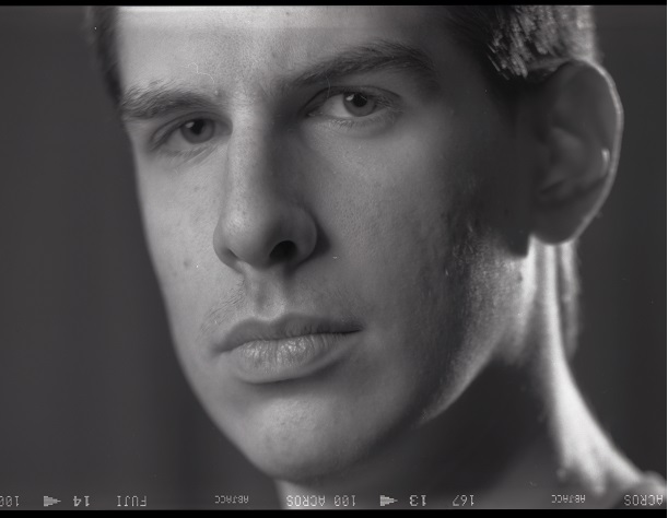

For those of you with Jobo or Unicolor film processors, I'm curious -- do the film edges get overdeveloped? I've been experimenting with rotary processing on a Unicolor (reversible) motor base, but I'm using regular Paterson reels either in a tank or a Unicolor print drum. This works just fine -- good even development -- except that the edge of the film that sits in the tracks of the reel gets over developed (see contrast- enhanced picture). Since I'm doing some work where the film gets exposed all the way to the edge, this is a concern. It also creeps into the edges of regularly exposed frames as well. I've only experimented with 120 thus far.

I don't know anything about Jobo processors but in looking at your scan it seems like only the area that isn't normally exposed which would be the negative border with info is lighter. Could this possibly have something to do with the capture or the emulsion? What camera are you exposing this film to the edges with?
looks a bit odd. I can't see it on bottom of image and top edge it seems to only be there in the highlight of the forehead and not all the way across.

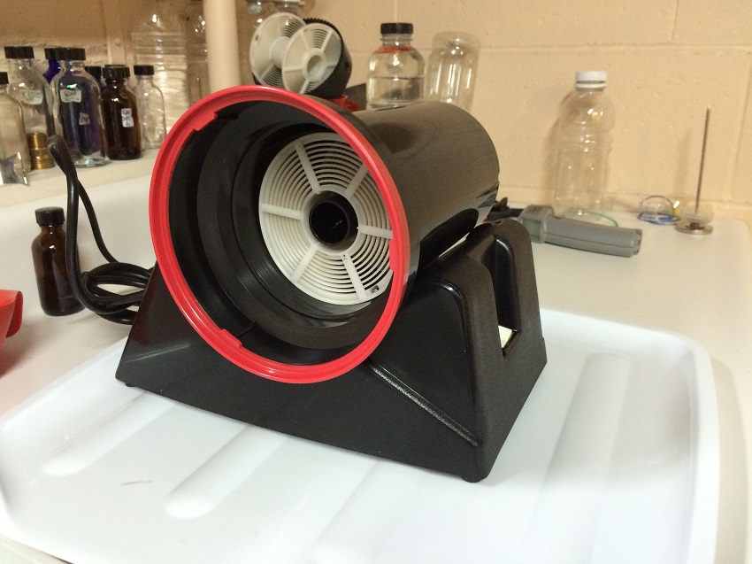

It can't be leveling. I should have provided more details, as I'm kind of improvising while I see if this works for me. The reels go in the Paterson tank, and the tank sits on its side on a roller base (see photo). Unicolor makes a drum and reels specifically for this, which I'm looking at, but it's the same in principle.

You are aware that paterson tanks were't designed for roller bases. The 4 reel tank and I think the 2 reel tank don't have parrallel sides. They are slightly conical in shape and that means that if you put it on a normal rotary base and the base is leveled, the tank will not be levelled and the narrow end of the tank will have deeper/more developer in it than the wide end. Measure your tank diameter at top and bottom ends to verify.

Thanks everyone. Yes, I'm aware Paterson tanks weren't designed for this, but as mentioned, the sides are parallel, and the base is level. Mechanically, it works just fine. In any case, I was doing two inversions by hand every minute, followed by switching the direction of the tank on the base.

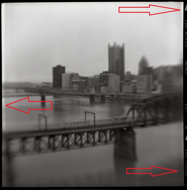

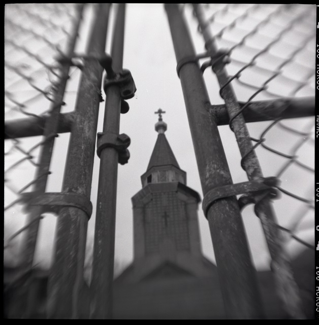

Do you see the same effect on a 120 roll that was exposed normally - in a 120 camera?
The sharp demarcation between the darker and lighter parts make me think that there is something other than enhanced developer activity happening here.
These were throwaway shots from a Brownie -- frames from two different rolls of Acros 100. They were processed in the same tank.
This film was rotary processed as described above. Same thing.. It's less obvious on the right side, but the I think that has more to do with the overdeveloped area landing in the gutter (the frame's not perfectly centered on the film).
This film was processed conventionally (using lateral agitation, 60 seconds initially then every minute).
