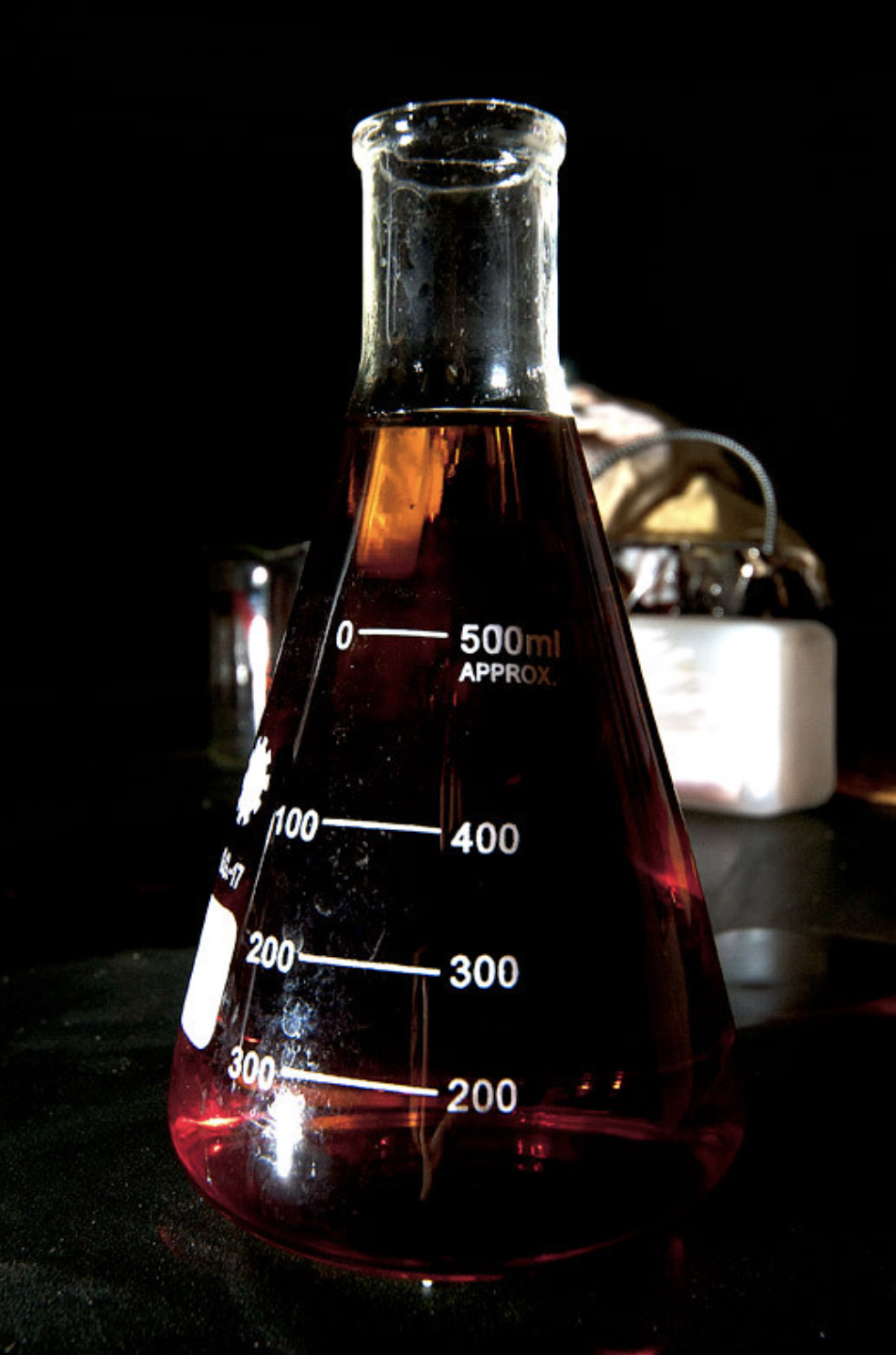

As in the other thread on Parodinal, I have been doing some Covid time wasting with my available household ingredients. Whilst developing one film I had left the leader in some Parodinal (my version) and by the time I'd developed my film, the emulsion on the leader had softened and detached itself from the film base. It was swimming on fluid. I wrangled that onto a piece of RC photo paper and let it dry as ART. Another day I purposely did it to the leader (different film) and it did the same. After pushing that around on the film base I let that dry as ART too. It reminded me of a polaroid emulsion lift, however it ended up looking like ART not a negative. I decided I didn't want to progress my ART in that form!
So although it didn't "attack the base", it certainly did a number on the emulsion. Some of my 'properly' developed (ie diluted Parodinal) negs turned out ok although my recipe didn't like being diluted more than about 1:10
