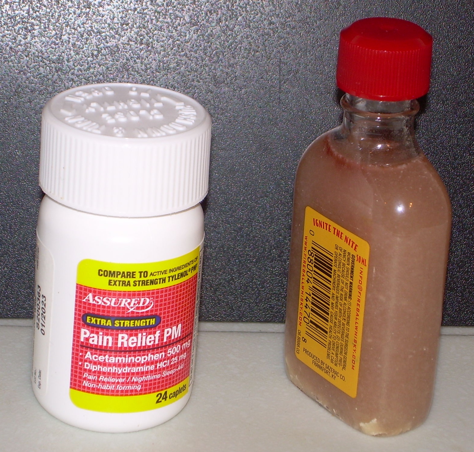

Each caplet has 500mg of Acetaminophen PLUS 25mg of Diphenhydramine HCI. Does this second ingredient do anything positive or negative to the Rodinal experiment?
It's a chemical that has found no use in photochemistry. Be the trailblazer and let's know what you discover.

I mixed a total of 50mL today. I am waiting three days for the 'fine wine' to become of value. I made 50mL of 'Rodinal" this way:
six 500mg caplets of the Dollar Tree acetaminophen. This is 3 grams of the acetaminophen. I got 24 caplets for a whole $1!!! Yes, these caplets also have the diphenhydramine (25mg each caplet).
5 mL (yes, by volume) of sodium sultife, anhydrous.
8 mL (yes, by volume) of sodium hydroxide.
WTM 50mL.
I crushed the caplets and used very warm water (which became yet warmer after the sodium hydroxide was added. About three hours after I mixed this, I put a tiny edge of B&W photo paper into it and it became immediately jet black. I will try film on Sunday, after it becomes 'vintage'. - David Lyga

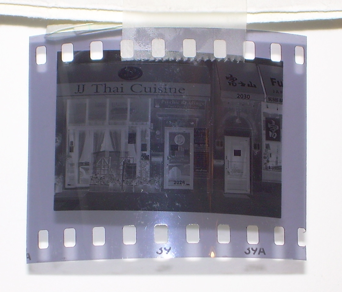

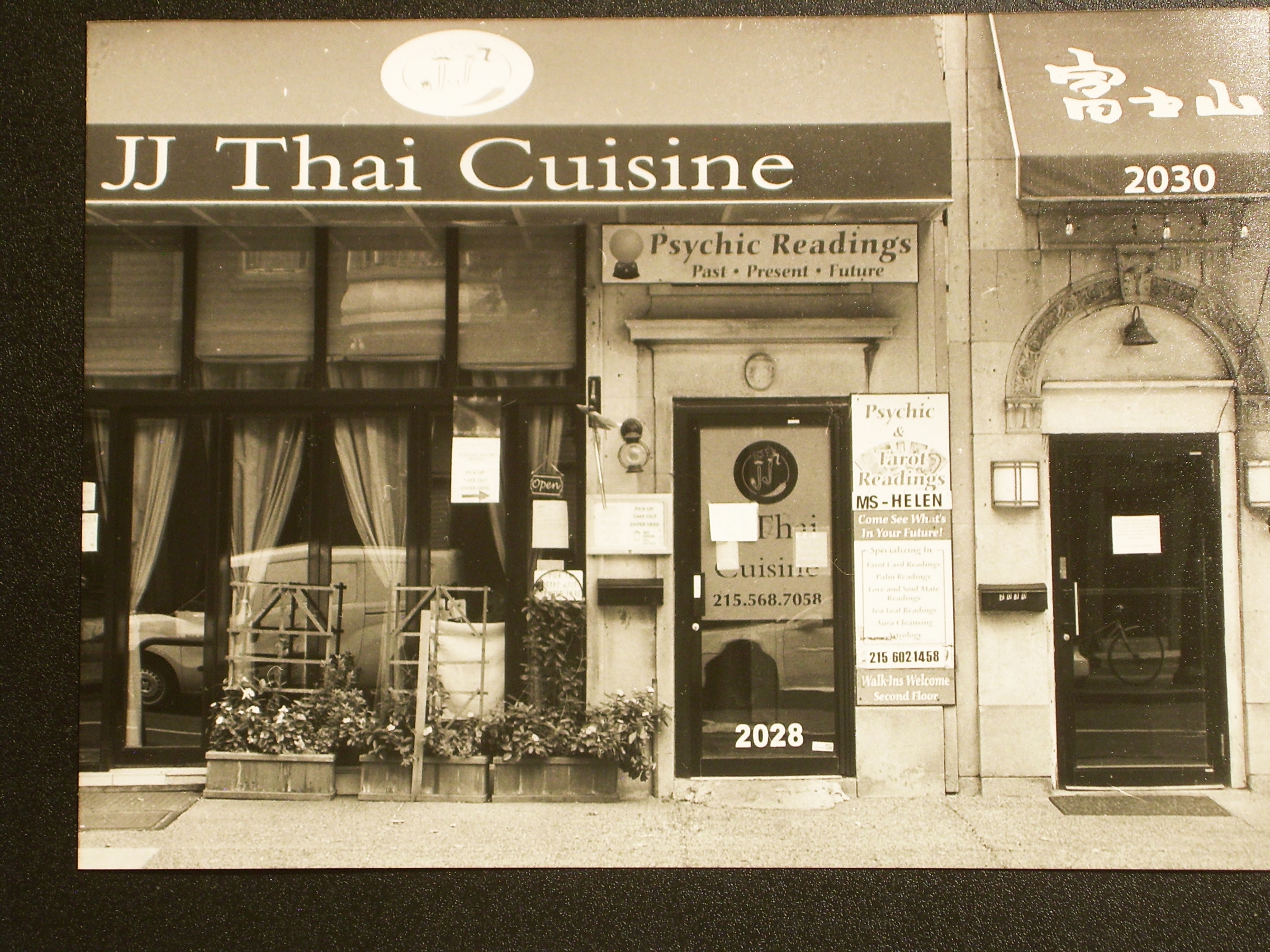

OK, I took Donald Qualls's advice and did not wait the three days. It is pinkish orange and looks absolutely disgusting. But it works, and seems to work well. My exposure and development data for this picture are:
I used a VERY old Arista 50 (sold by Freestyle more than a decade ago, and I believe it to be rebadged Pan F+). EI that I chose was 32, so it has not lost speed. In fact, I think the negative is even slightly over exposed! Dilution was 1 + 49 and the temperature was 75F. I merely cut about two inches of film from the spool, inserted into the back of my Chinon CS (the film was placed a bit skewed, as you can see from the picture of the negative's borders). I developed the negative in a film can and constantly turned it around and around for the development time of 7 minutes. My precise working solution was .25 mL of "MY RODINAL" plus 12.25 mL water. This agitation method is somewhat similar to the Jobo method whereby constant agitation is done. The day in Philadelphia was very overcast and about 8:30 AM. My exposure was f4 and 1/30th. Again, it seems slightly OVERexposed. Maybe the film is actually about 50 or 64 in speed which says a lot for the longevity for old, SLOW film.
I have a very cheap digital camera so everything might not look extremely sharp. However, that negative is razor sharp and I tried to find grain but there was none to see.
Having said all of this, I stress that I have NO IDEA how long "MY RODINAL" stock solution will last. I highly recommend (HIGHLY RECOMMEND) that before drawing any liquid from the stock, you shake that solution so that you will be pulling representative components in the liquid. Again, that liquid looks truly disgusting.
I made a total of 50 mL of stock solution using the formula which I had posted earlier. I warn you that if you get any of this ugliness stuff on anything, it will stain mightily once dried.
The cost for me to make the 50 mL of "MY RODINAL" was about 40 cents. This, times ten would be $4, which compares favorably with $16 for the genuine article (since that comes in 500 mL sizes). The other ingredient along with the Acetaminophen, Diphenhydramine, seems to be inert as regards photo developing. - David Lyga
No surprise there, as I said. At most it will be acting as an additional accelerant due to it possessing a basic group, but given the very minor amount present and that you are already using excess sodium hydroxide (a much stronger base), this effect will be essentially nil.
All the undissolved solids in your mixture will probably be the excipients used in the pills.
Yep, that looks like a success. Generally, the slower the film, the less it fogs as it ages, and less fog == less loss of speed due to age.
Get the plain acetaminophen next time you buy, and good to go. As suggested earlier, plain APAP (acetaminophen/paracetamol) is almost certain to be cheaper per dose than that PM formula.
