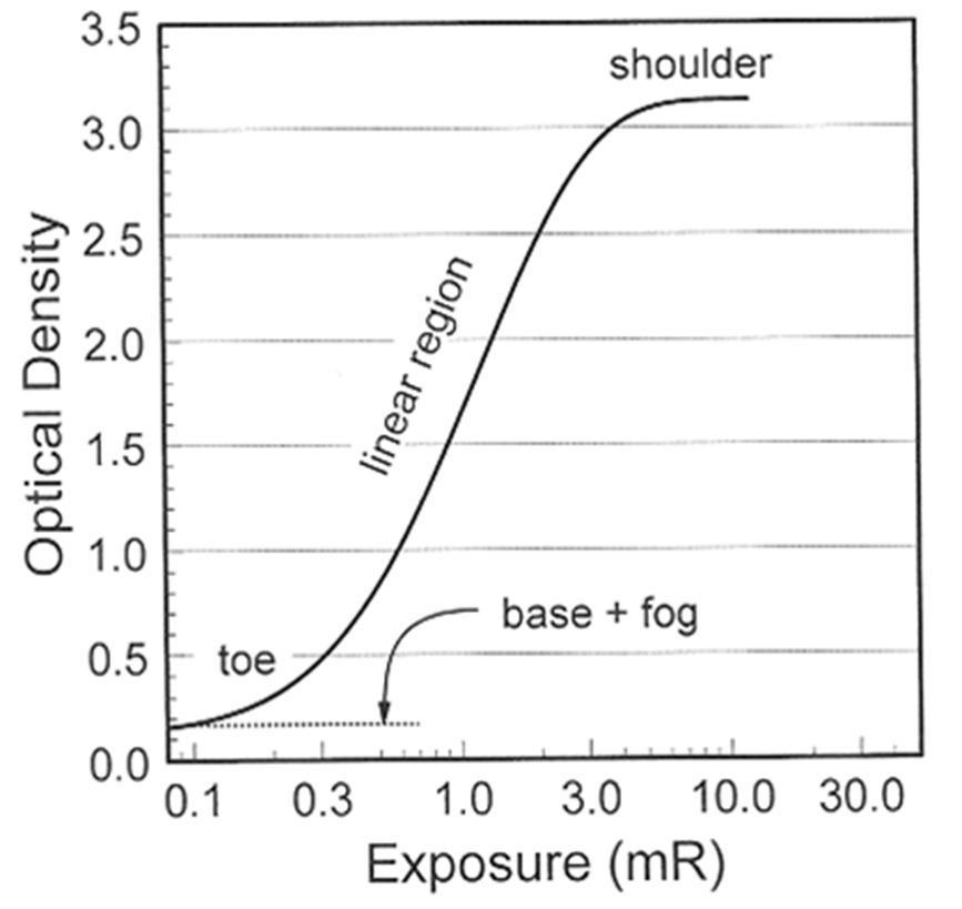

Changes in exposure move your subject right or left on the curve. Changes in development make the right hand portion of the curve higher or lower.
