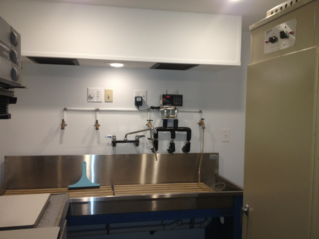

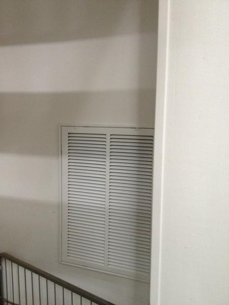

Im building a new darkroom in my house and am not sure about the ventilation. I have a simple bathroom fan that is more than enough for my smallish 11'x11' darkroom. My question is about the louver I will need to install in a wall opposite of the exhaust fan.
Do I need to purchase a special light tight louver such as this? Or is there an easy way to make a simple household louver air tight?
I have two of the 12 x 12 light tight louvers on the "inside" wall above and below the intake which is opposite the louvers on the "outside" surface of the same wall. I have an A/C filtered register to keep dust out of the darkroom. I have two louvered fans directly over the sink on the opposite wall as the intake. Ideally, I would have the fans on the back wall at the sink level but that was not possible due to space constrains. I've included some photos below. L
Filtered Register on the outside of the wall

Exhaust louvered fans 400 cfm each over the sink with a speed control to dial down as required. Fans are on a fur down with an exhaust pipe to the outside of the building.
