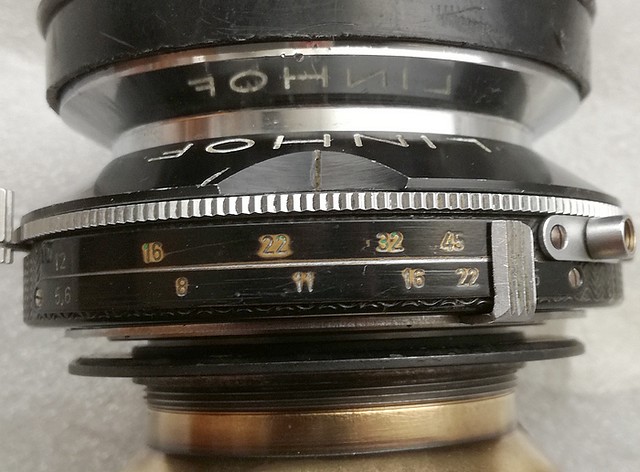

Allow me a question concerning this Large Format lens.
It is a Schneider-Kreuznach Technika Symmar lens. On the front element ring it is engraved 1:5,6/240 and 1:12/420. There are two aperture scales one from 5,6 to 22 and another from 12 to 45 (with the same cursor)
I am interested in using the lens indoors as a 240 mm lens.
From my ignorance, I am asking : Why two scales ?? Can I use only the 240 mm scale and ignore the 420 mm ?? Was this lens with double scale designed for some specific purpose ??
Symmar 01 by João Avelar, on Flickr
Symmar 02 by João Avelar, on Flickr
Thank you in advance for any clarifying explanation
Joao
These are "convertible" lenses. You can remove the front cell and use the lens with only the rear cell as a 420mm lens. Then you must use the 420mm scale. Schneider made similar 100/175, 135/235,150/265. 180/315, 210/370, 300/500 and 360/620 mm lenses.

One can do this, as them name already suggests, these lenses are nearly symmetrical.
With later models Schneider advised not to do so, for image quality reasons, thoug the lenses still being fairly symmetrical. But worth a try.
You'll get the best results from using it as a 240mm lens. If you remove/unscrew the front element, you'll get a less sharp but perhaps more pleasant portrait lens.

It looks like yours is from the mid 1960s, Linhof always got the best Schneider-stuff, have fun with your lens!
Thank you all for the clarifying answers. I was not aware of the possibility of having two scales in the same lens
