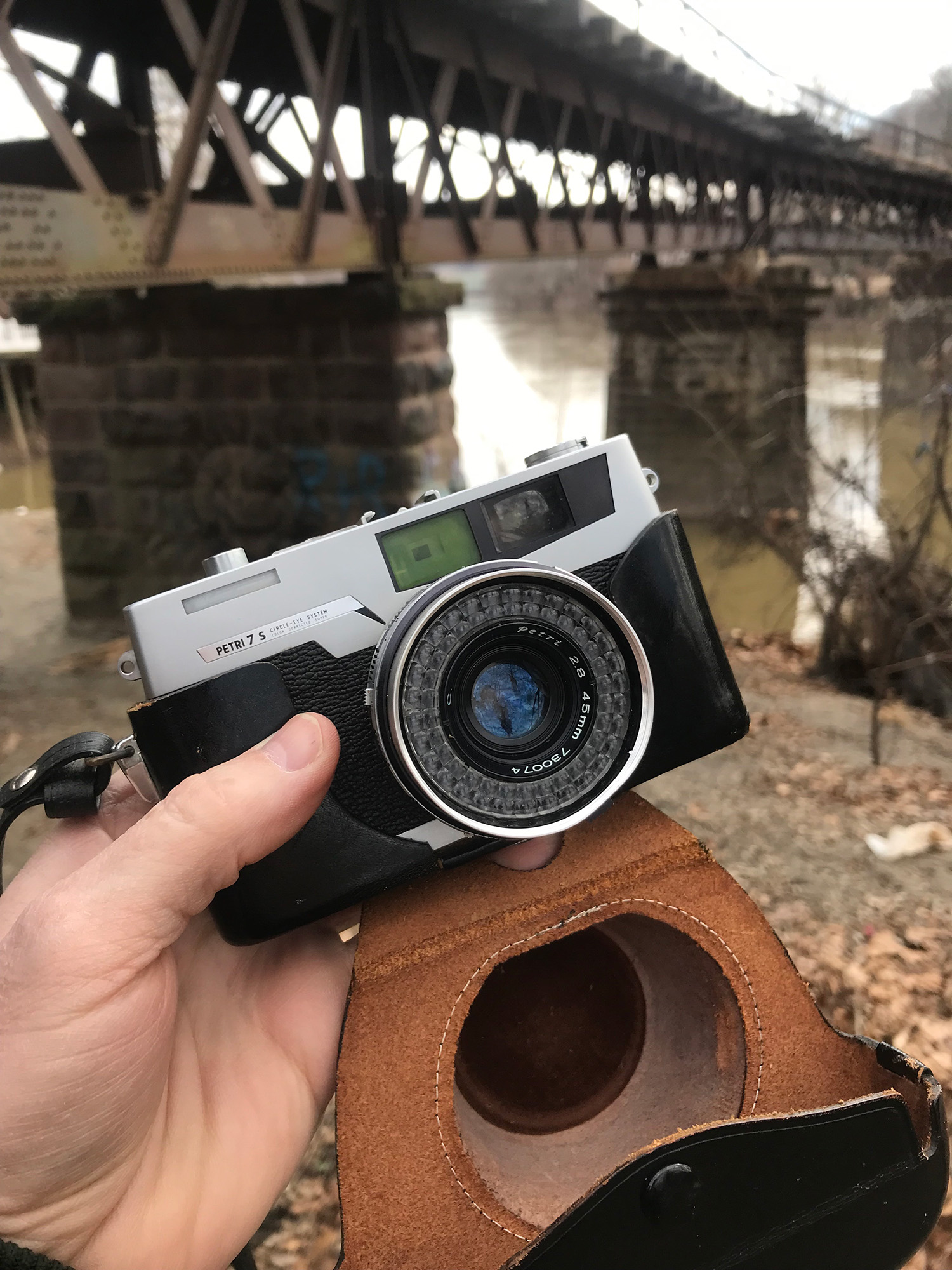

My girlfriend just inherited this camera from her dad, who we think purchased it during his service in Vietnam. The camera is in excellent condition aside from a dent from a fall when the strap failed. I don't think he used this camera much. She was convinced it wouldn't work at all, and I was convinced it would work just fine. I'm glad that I was right, so now she can use it. :smile:
The camera is fun! The selenium meter still works properly, and can be read from the top of the camera before you frame the image, or directly from the (very dim) viewfinder display. The shutter is in the lens, and does not disturb the camera at all when fired. Handholding at low speeds would be easy with this thing.
The lens performance is good-to-average I would say, but it flares, so keeping the sun behind you is a good idea. The lens has no fungus but it's also not clean, so I need to look in to cleaning it.
But here's the thing, it's nearly impossible to focus this camera due to an almost imperceptible viewfinder patch. I can do it with effort, but man you have to be so careful to focus it properly. I'm tempted to show her how to zone focus and be done with it, but now I'm wondering if there are any tips or tricks to make the rangefinder patch more obvious for her? Let me know if you have any suggestions. Thanks!

Put a coloured gel over the rangefinder window. That will colour the patch and make it easier to line it up.
I have a Petri 7s with the same problem -- very faint RF patch. I solved it by using a Sharpie marker to put a dot on the main viewfinder objective (toward the subject) exactly coincident with the RF patch. This makes the moving RF image visible, and you just match it at the edges of the spot instead of watching for one image on top of the other to align. if you get the spot in the wrong place, the Sharpie dye will come off the viewfinder glass with 91% isopropyl alcohol or a number of other solvents (isopropyl is probably the least prone to damage something else, but still keep it where you want it).
A similar idea is to put a piece of unexposed-but-developed black-and-white film over the viewfinder window (not the rangefinder window). The purpose is to dim the VF image some so it won't overpower the faint RF image. Color film would work too if you don't mind an orange viewfinder. You can also use window film, which comes in large rolls for dimming windows of buildings. That works well.

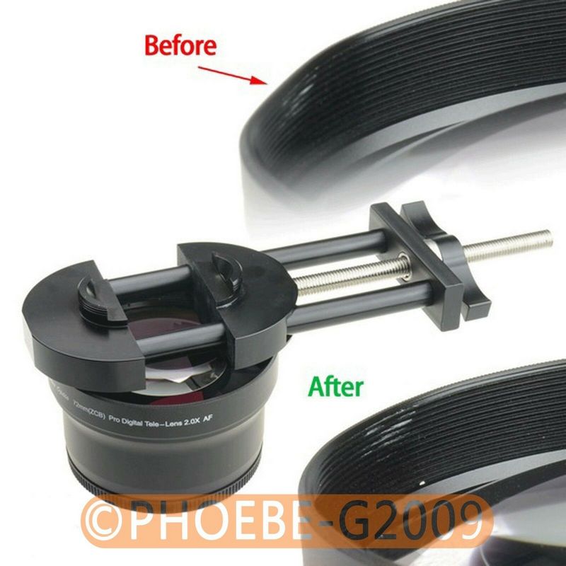

I wish I could, but when the camera fell it landed right on the threaded filter ring, deforming it. :-( You'll see the deformation at the bottom of the lens on the pic of the camera.
If you have a jigsaw and a clamp, you can fix the filter ring. You trace the correct arc of the ring (about 1/3 way around the lens) onto the edge of a piece of wood (1/2" to 3/4" thick) with grain running perpendicular to the arc. You cut the arc out. You cut off the leftover bit. You use those and a clamp on the bent part of the ring. It might get it straight enough to use and won't chew up the threads.

If you are really serious about the camera (that camera) get the lens clamp. You will want filters at some point soon.
Or you can use a lens vice tool.

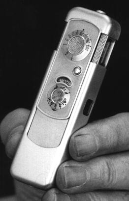

Donald, I'm sure the light meter in your Canonet is more useful than the one in the 7s. Selenium meters are great, but they just aren't sensitive enough for indoor lighting conditions. Hence the mass changeover to using CdS meters during the 1960s by virtually every camera company.
In my own case, the Minox B I had in the late 60s convinced me that Selenium meters were of limited value apart from bright exteriors. When I got my latter-day Minox camera in 1995, I specifically chose to get the older IIIs model because it didn't have the meter and was an inch smaller. Besides the fact that I first learned to estimate exposure and focal distance pretty well back when I was 11 on a Kodak Pony 828, the Minox had the advantage of its fixed f/3.5 aperture, so the shutter speed was the only exposure variable.
Anyway, I never regretted getting the IIIs vs. a B, it was a pleasure to carry, and I mostly did very well with the exposures. When in doubt, I'd bracket: since I was loading my own film (TMX) for only about a dollar per Minox roll, why not? (A few years later I got another Minox B and used it for color print film - and since getting that processed wasn't dirt cheap like my own b/w, I was glad to have the meter.)

The faded rangefinder patch has meant that my girlfriend has needed to learn how to estimate distance and focus using the scale only, which she is surprisingly good at. I’ll stand next to her and have her guess at focus distance of an object and then check with the rangefinder on my camera. For daytime photography at f11 or so that’s good enough and her pictures are focused properly, but fixing the rangefinder is still on my to-do list.
The Petri 7s was the first camera I ever used at age 10. It belonged to my father who bought it in 63. I don't have that camera any more. I have bought a few used one but although all are working fine and suprisingly the selenium meters are quite accurate. But the rangefinder patch is faded badly so it's near impossible to use it. When the camera was new as I recalled the patch could be seen very clearly.
Yes I love it.
Even after applying a small diamond of electrical tape in the main finder?
I used that trick in the P7s that went to Donald and made a whole world of difference
