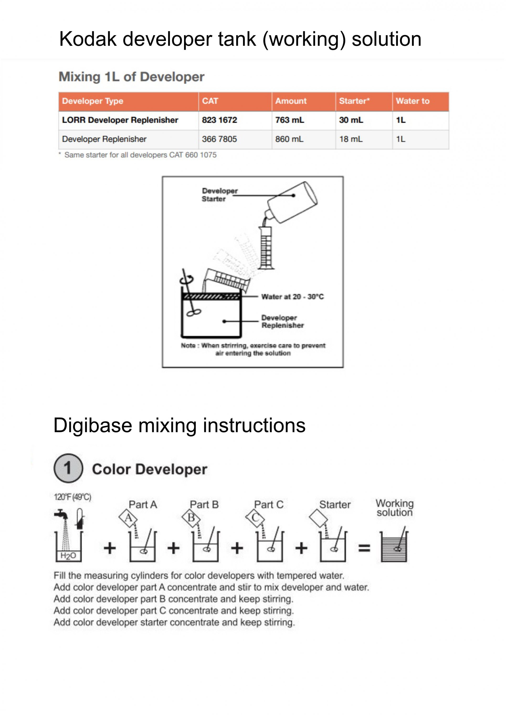

In a photo lab, C41 developer replenisher is mixed and used to replenish the developer tank solution. This dev tank can be called a seasoned solution or working solution BUT it is not a tank of raw replenisher.
If for some reason a new C41 developer tank solution needs to be made up, then the replenisher is mixed and the required amount of dev starter is added and then topped up with water, as per starter instructions. Now the tank is a working solution and can be used to process C41 films.
See below.

Everyone is either missing or dodging the question. Consider the mixing instruction diagram in post 34 above: Is, after adding Color Developer Part A to Part B and then to Part C, the resultant a "Color Developer?" Will it develop a roll of film without adding a starter? At one time Kodak made a C-41 developer that did not require adding a starter.
Yes, but there will be some colour crossover and it will be over-developed unless you reduce the developing time, which will in turn add a colour cast on top of the crossover.
It would be fine for the C-41 black and white films.
The extent of the colour issues may or may not be within your tolerance levels.
See below.
This is perfect!!
