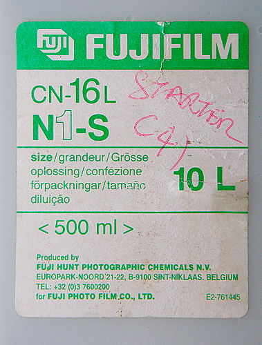

1. What exactly does the C41 Developer Starter do ? I use 'FUJI ENVIRONEG Replenisher Air + Starter cn16L N1-S ' at 30mls/Litre Replenisher given 2x10 Litre Concentrates Parts A.B and C from a mini-lab forced to close.
When I develop I find 3 mins 15 secs @ 100oF is too short -- get under-developed negs.
QUESTION :
Can I add LESS STARTER to make the Developer 'Stronger' ?

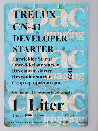

3 . I have : CPAC Trelux dev Starter left over fro when I used to order 'CPAC' chemistry .
Fuji Hunt NEGACOLOR Universal developer Starter 1 litre pack with instructions for differing'Negacolor'
Can I used these still for when my dwindling supply of the Fuji Environeg goes and can I use for 'MYDONEG' ?

I ask because due to the supply-line problems I ordered the Fuji CN16 N1-MV Developer Replenisher which is the only C-41 Developer I found available right now. Thinking that it was "expired" I recently disposed of the probably 1/4 bottle of Kodak Starter I had and hope that the Fuji works without using a starter. The Kodak Flexicolor Developer/Replenisher comes in 3 parts (A, B, and C) and to add 25mL of starter for 1L working tank. For a 1L working tank I mixed 700mL water, 400mL Part A; 17.8 mL Part B; 40mL Part C; and 25 mL of Starter and topped off to 1L. But as Matt pointed out above the Kodak literature says that you don't need the starter if not replenishing. I process with a Jobo and so didn't need the starter but made room for it in the 1L working tank The Fuji comes already premixed, you just add 600 mL warm water to 400mL of concentrate to make the Replenisher and then 225mL of warm water to 750mL of replenisher and 25mL of Starter for a 1L working tank. The amount of starter in 1L working tank is the same. If the Fuji concentrate is comparable to the Kodak Parts A, B, and C, then would I add 225mL of warm water to 775 mL of replenisher?
