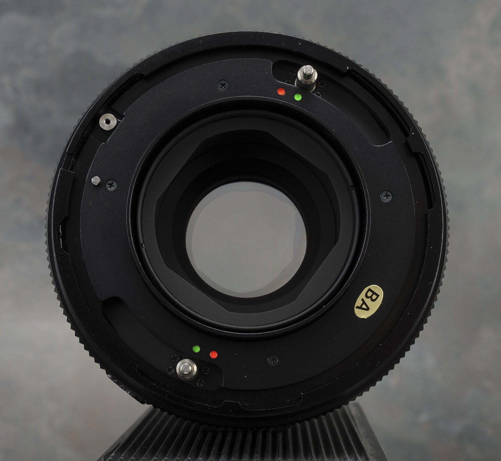

Last year I bought a Mamiya 180/4.5 - some dust in the optics - and just now I see a very minor darkening similar to what was shown above. It's at the very edge of the element(s) and I don't think it would have an effect even wide open.
Is the area likely to expand? If so, how rapidly?
Also just realized the shutter is behind the rear element - it could be touched.

This thread got me thinking; could lens element separation be accelerated by a warm/hot climate? Ie, too frequent time spent inside of a hot car, etc?
Theo, I have a couple of lenses that have minor edge separation, and it hasn't progressed in the years I've owned them, if that helps any. Of course, YMMV.

One needs to know what type of adhesive was used on the Mamiya lens cells and the manufacturer of the adhesive to find how to remove it.
Heat is a key component in breaking the UV adhesive bond. Norland recommends 400°F to 800°F and using a hot plate as described in SKGrimes article linked to in post #23. Norland also states soaking in liquid paint remover for several hours to a day or two will work, the length of time will depend on how large and thick the lens.
The separation may be caused by the bonding technique or type of adhesive used. If you have a black car with untinted windows and parked it in direct sun with the lens laying on the seat or dash for a few 100°F+ days then maybe the interior temperature of the car may have caused the failure.
tedr1
Feb 3, 2016
932
50 miles from NYC USA
Here is the example of a NIB Mamiya 180 showing element separation, this is a Sekor C for the RB67 so the age could be as little as ten years or as much as thirty years, very unlikely to have been outside the warehouse, it probably sat on a shelf it's whole life.
