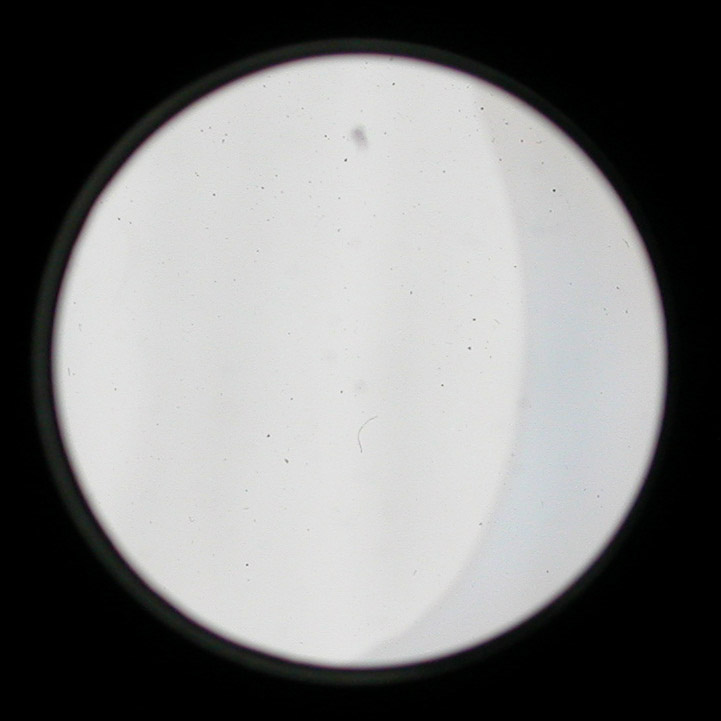

Dang... just noticed this, looking through the lens, unattached from the RB67, there is a light darken area hugging the edge of the lens, like a quarter moon shadow.
Haven't shot with this lens or camera since June, but looking at those c-41 negs, don't see any evidence of it in the shots that I used this lens on. Everything seems to be in focus ect, and no shadow or whatever showing.
Hmmm... So what could it be?
If I used some B&W film.. what kind of shot set up would I do, to perhaps 'expose' its condition and see if its affecting the image?
thanks for your help..

1) Off the camera shutter open..
2) Looking both front or rear its there
3) Off camera originally, it was at 2 o'clock.. put on the camera focused close and across room, took off and it was at 3 o'clock.. put it on again and moved and adjusted f stop ISO ect, then took it off it moved up slightly between 2 & 3
When its on the camera, through the waist level viewer, can't notice anything.

i am having trouble understanding what you mean by a "lighten darken area" as you look through -- does it seem to be a de-cementing of the lens on the edge?
In any event, I bet you anything the images you get will be fine. At wide-open, when you are using that area of the lens, it may introduce some slight softness, but not so much as to be noticeable ... it may cause some flare. I'd shoot with the lens and not worry.

Balsam separation.

Mount the camera on a tripod, open the shutter on T or equivalent, open the film holder and look through the lens. Is the defect visible?
Balsam separation will not move around unless the element is loose. Some shutters have secondary shutter blades that are short and go on over the ends of the main shutter blades to ensure light tightness throughout the blade movement. One could be loose or worn enough to let stray light reflect back onto the lens provided the shutter uses them.
Are any of the shutter blades silver colored?
Does the angle of the light entering the lens affect the defect position?
Another possibility is the shutter goes past full open off the camera and just goes to full open on camera.

I have seen lens element separation in a Mamiya 180 that has the appearance you describe. Exposures made with the lens wide open (f4.5) may be degraded very slightly by this optical defect. When the lens is used at smaller apertures (f5.6 for example) the separated region of the lens elements may be covered by the lens iris when it stops down for the duration of the exposure and the image quality is then not affected at all. Repair is possible, by a skilled optical shop, however the cost may exceed the replacement cost of the lens (about $100 - $150 in the USA)

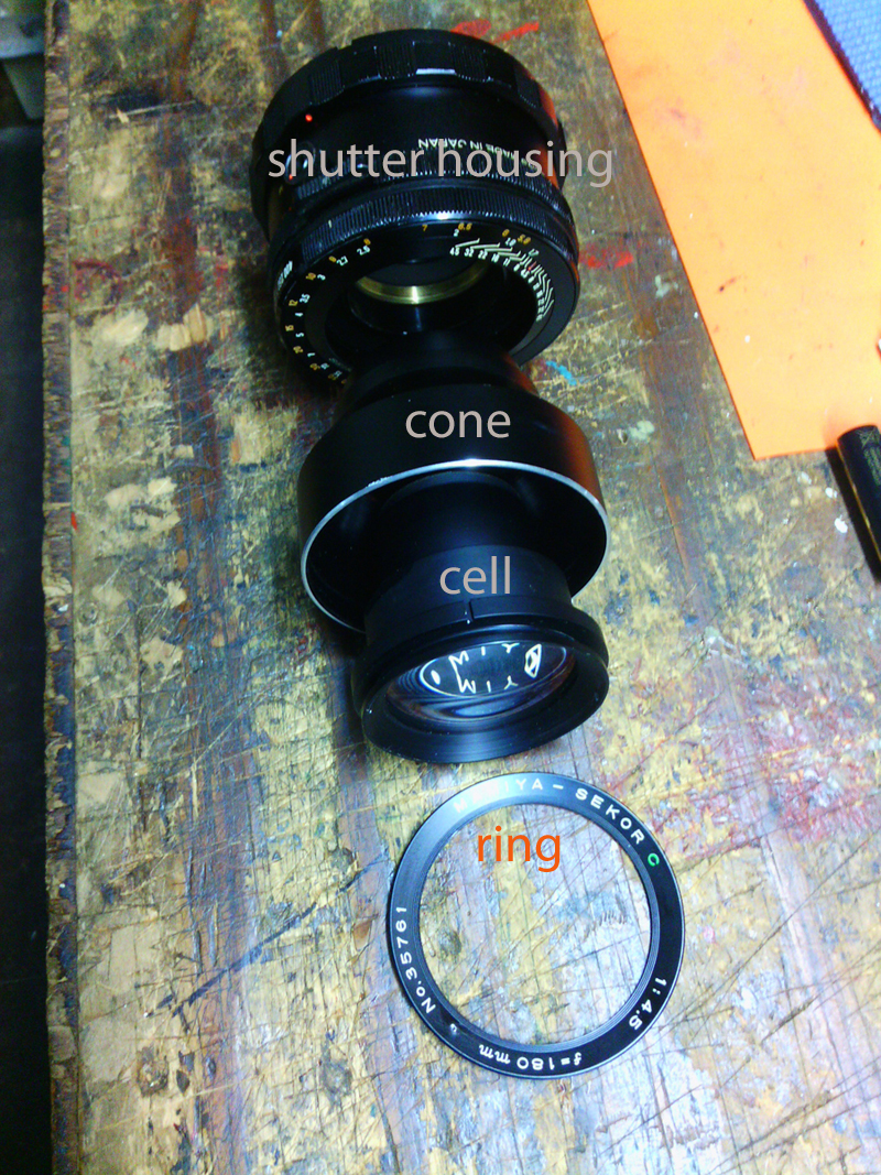

take a pic of the lens you have? Depending on the model, the front cell may unscrew like a light bulb. I may have a good front cell from my junker closet.
Sounds like it may be separation.

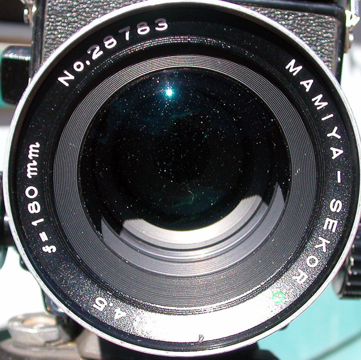

Well is it a light bulb... or a lens seeking the light.. :smile:
Have not tried to unscrew or see if its lose.. please let me if the lens matches what you think it may be..
thanks..
thanks..
Looks the same.. move the front of the lens around in the sun n see if that half moon shows?
The cell you the looks the same as mine. Mine has very little separation on the edge but its not enough to effect the image.
You need to take out that front name plate. First turn the cone to unscrew it a bit so you can get a good grip on the name ring. That will take the preasure off the ring. AFter teh ring is out you can unscrew the cell inside the cone.
Once the cell is out you can see it better in the light if its separation or whatever.

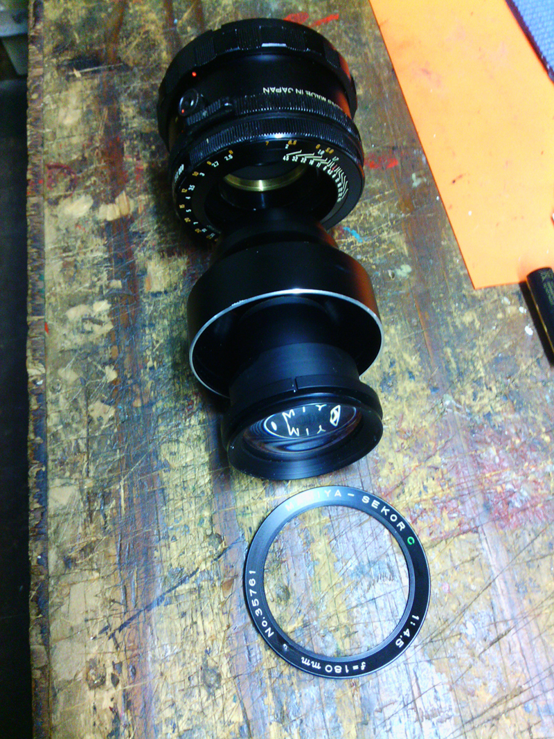

cone is the part closest to the body of the lens in my pic

Hmm ok loosened the cone, but how the heck do you get a grip on the name ring?
Tried an eraser.. not griping name ring..

Nope.. undid the cone as far as it will go.. to try to get a better grip on the ring... gonna try again with something else I have..
Hmm... there is a small mark on that ring.. think someone has been here before.. can't see it in my picture of the lens (#11) as it is at the bottom in the reflective sun light area..

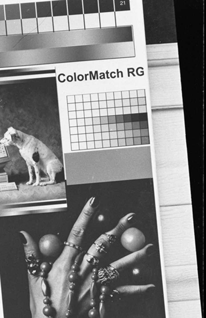

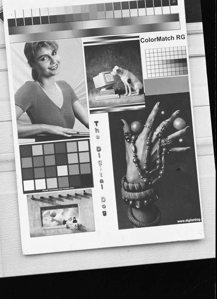

Tried a B&W..placed a sheet of 2x3 in the roll film holder.. as you can see it did not stay straight.
f5.6/8 @ 400
Simple Epson Scan, nothing done to it.. First is full image.
Not really a good test shot, as it is not consistent of just a light colored area as Shutterfinger suggested in post#2
But going to go shoot a roll, whatever is wrong does not seem to be causing to much stress in the image, so will give it a full roll and find some sand or large light area.

well if its not imposing on the image, leave it. perhaps using small apertures will minimize its effect.
but at certain light angles will reveal the defect either as flare or a soft focus haze.
