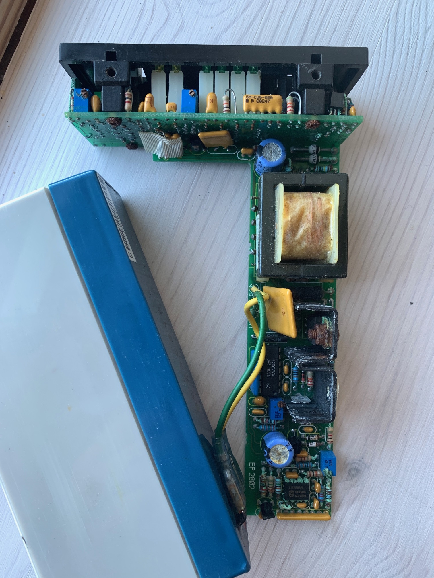

When I removed the battery I noticed a small amount of corrosion on the circuit board
Please post a photo. The questions are (1) what caused this apparent corrosion, if that's what it is and (2) which components may be affected.

Oh, I see. That's a royal mess. This is mainly moisture damage, so the unit was apparently stored in high humidity and/or it suffered water damage at some point. It's also literally all over the place, so definitely not a localized problem.
Sorry, I'd consider that a loss unless you want to try rebuild it. You might be able to clean it out and replace some of the heavily affected components, and this might actually help. But this would be hobby project taking many hours of painstaking disassembly, testing individual components and sourcing replacements, and then building it back up while verifying correct operation. Without specific electronics knowledge as well as experience/awareness of high voltage circuits (there's obviously some danger involved), I wouldn't even start. As it is, it's to be expected to malfunction and/or develop additional failures on top of what you're already seeing.
The realistic way forward is to look for a replacement of your flash unit.

Again, given the degree of corrosion in there, I'm not surprised there's some kind of malfunction.
I don't think the battery is the problem. I think the inverter circuit to generate the high voltage from the battery is bad. I believe the Quantum Turbo supplies high voltage to the flash directly and bypassing the inverter circuit in the flash.

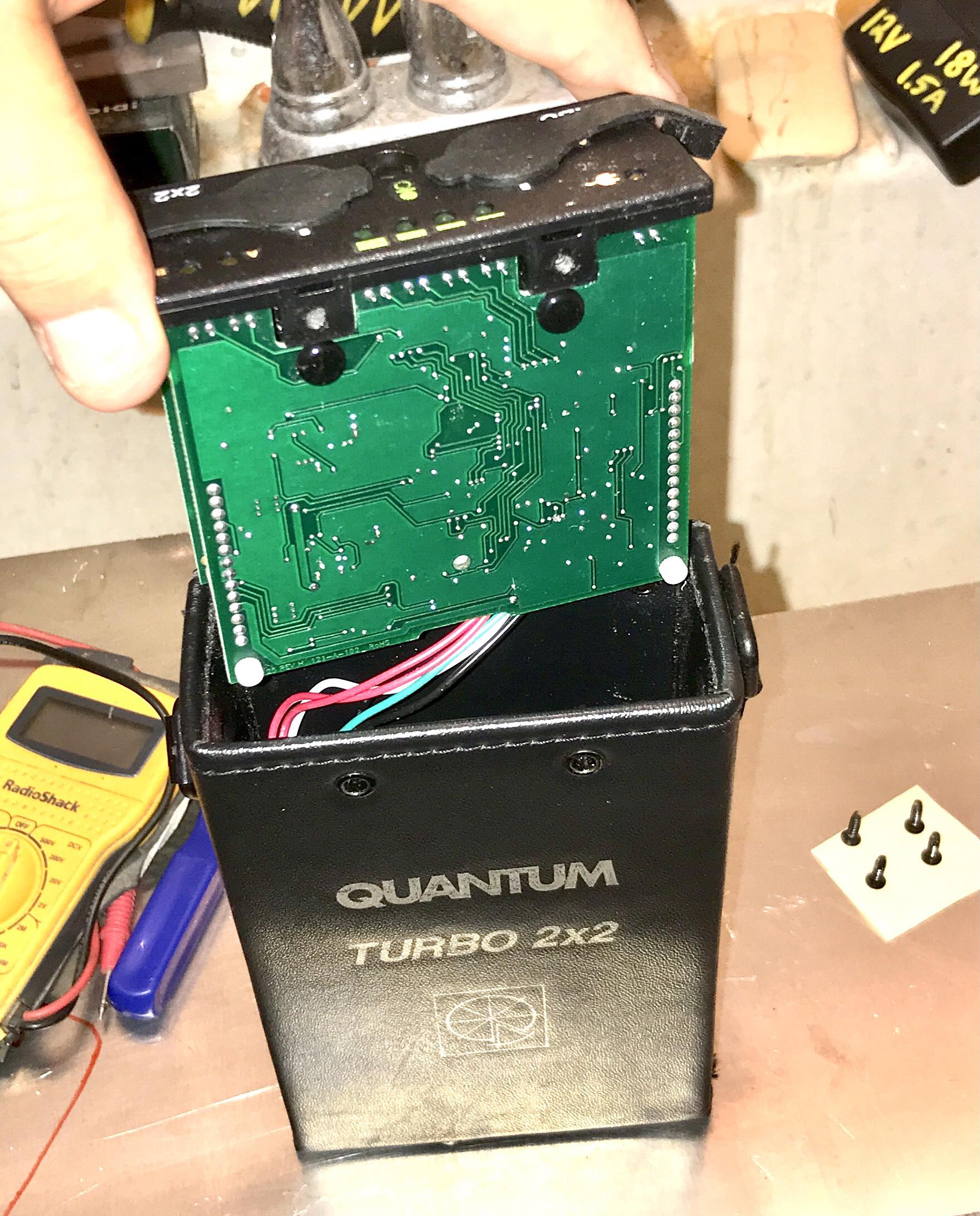

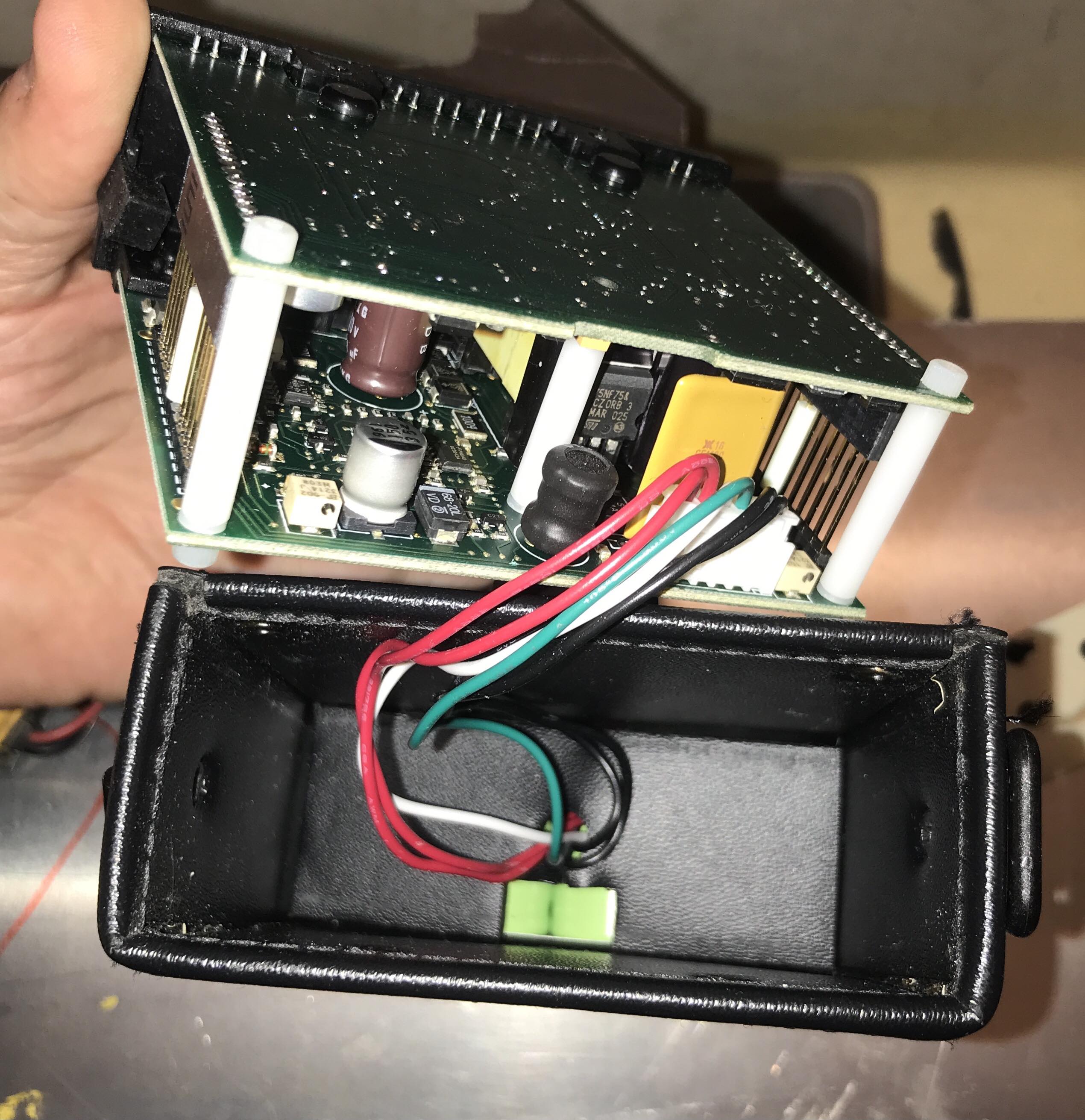

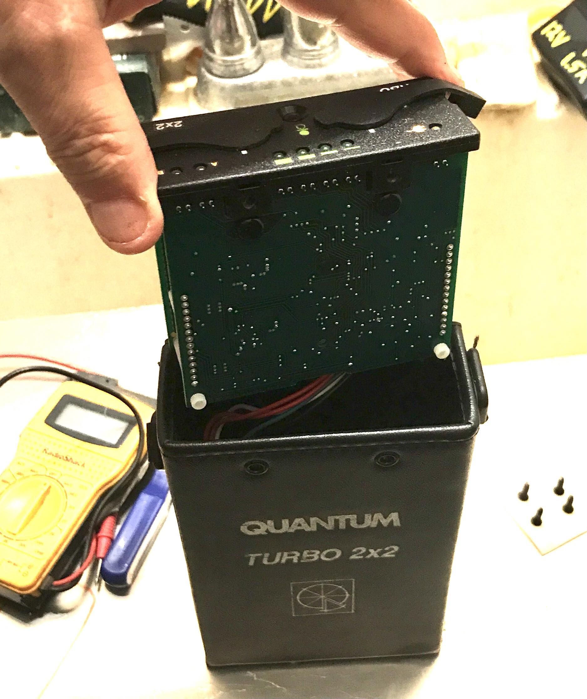

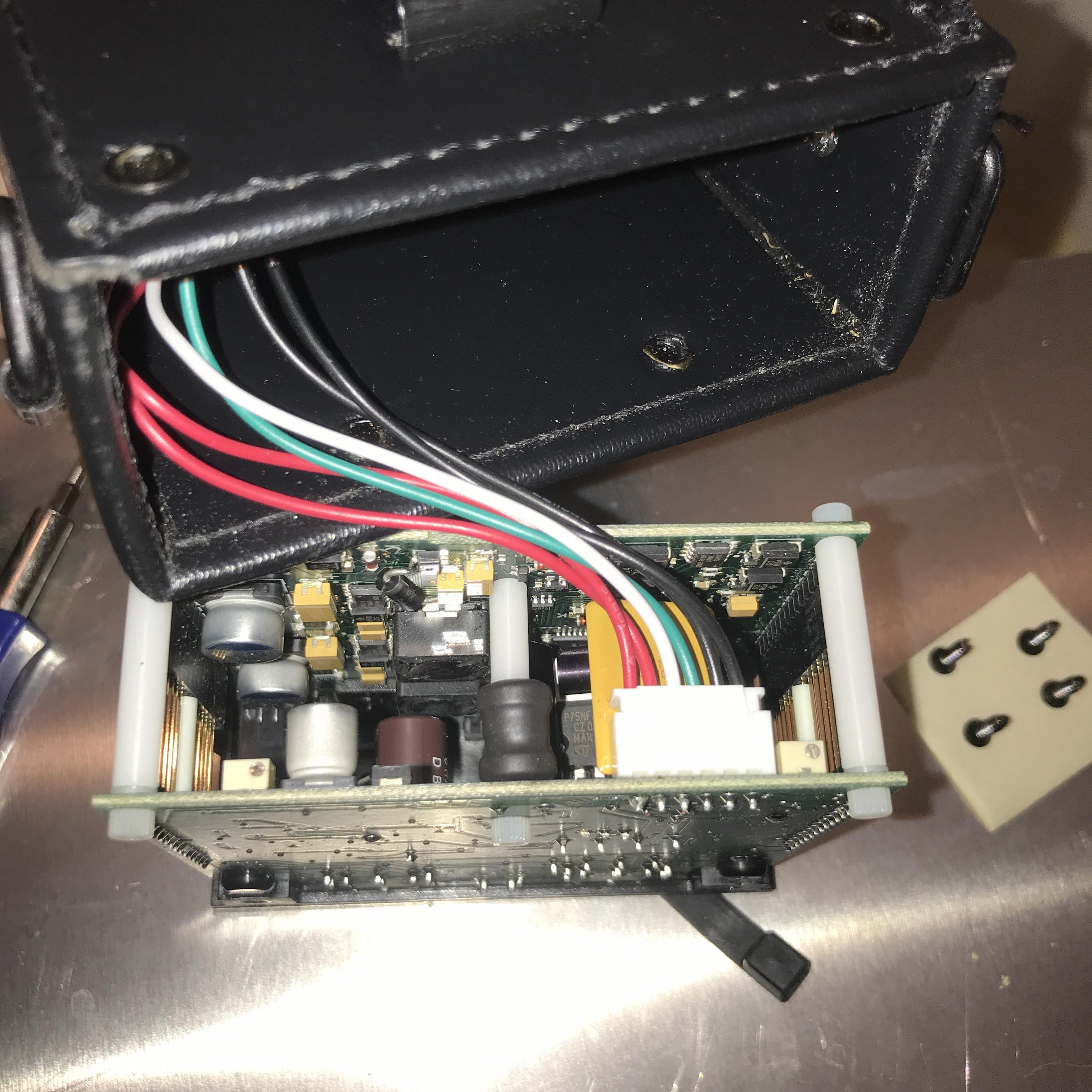

Hey WH.... I have a NEW Q Turbo 2x2 I bought new for a wedding. Shot it... charged it, stored it... 5 years ago.
Pulled out... dead, duh... charged... all 4 green lights... unplugged... dead. Nothing... no lights, nothing.
Okay... dead batt right? (right).... so... Sonic Power 8v 3.2 for THIS pack too? And... any trick to pre-heating pack to release the glue so I don't have to cut out the butt like some other video guy did? Thank you!!! -Steve Bigler
(BiglerRaw on IG)
(BiglerRaw on IG)

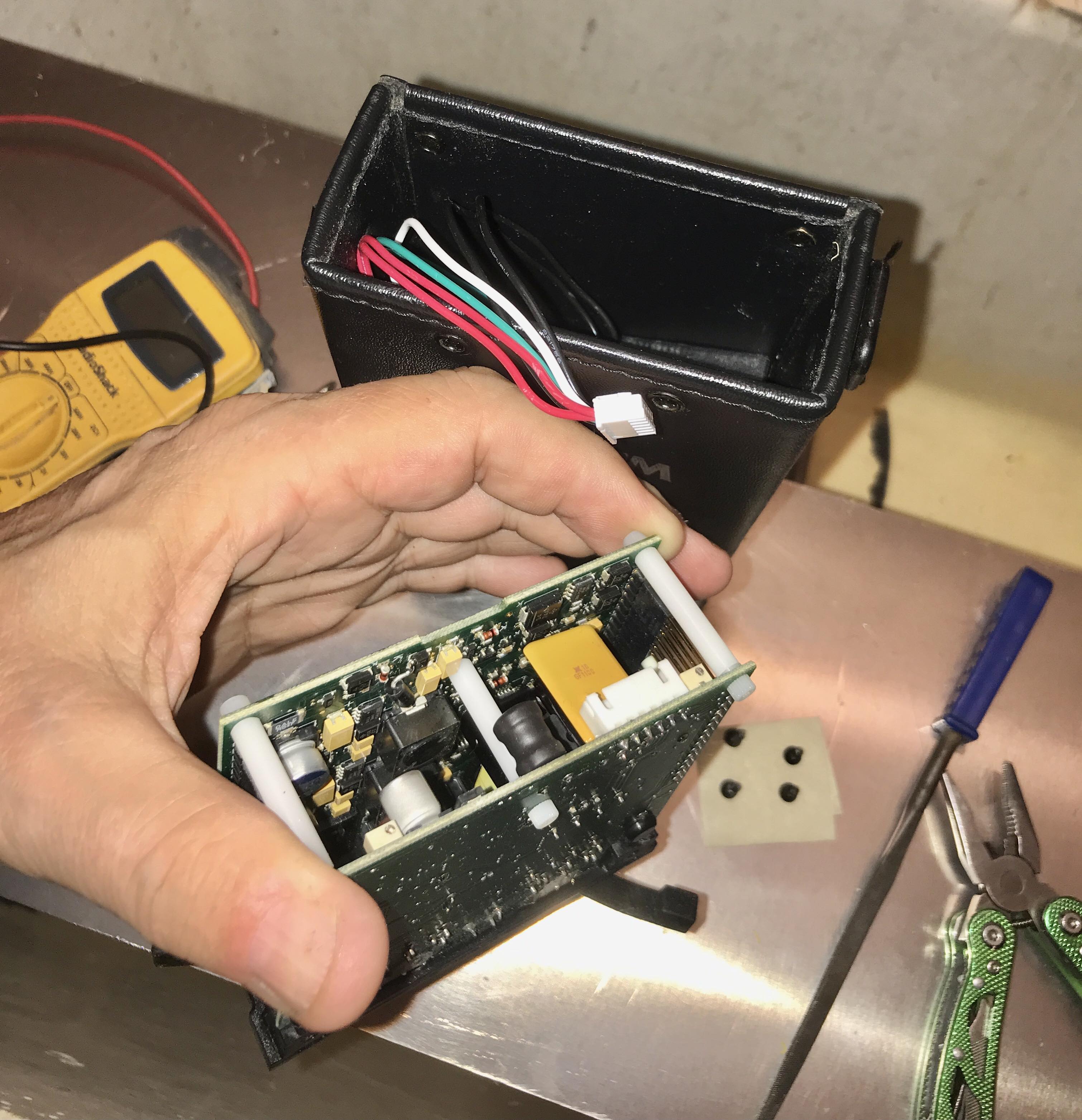

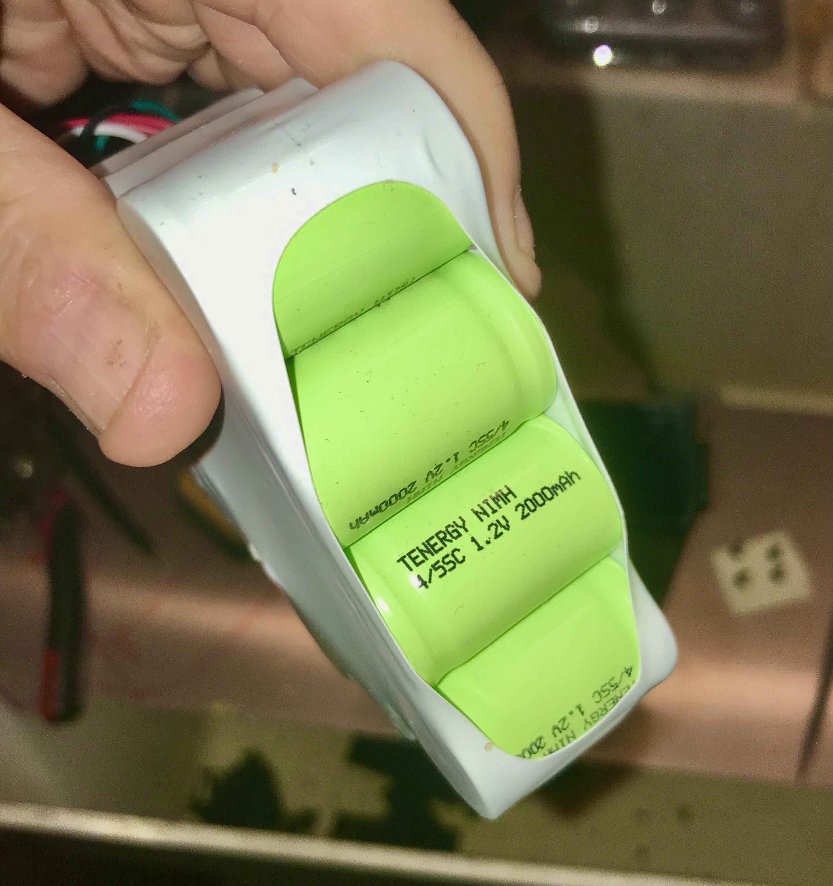

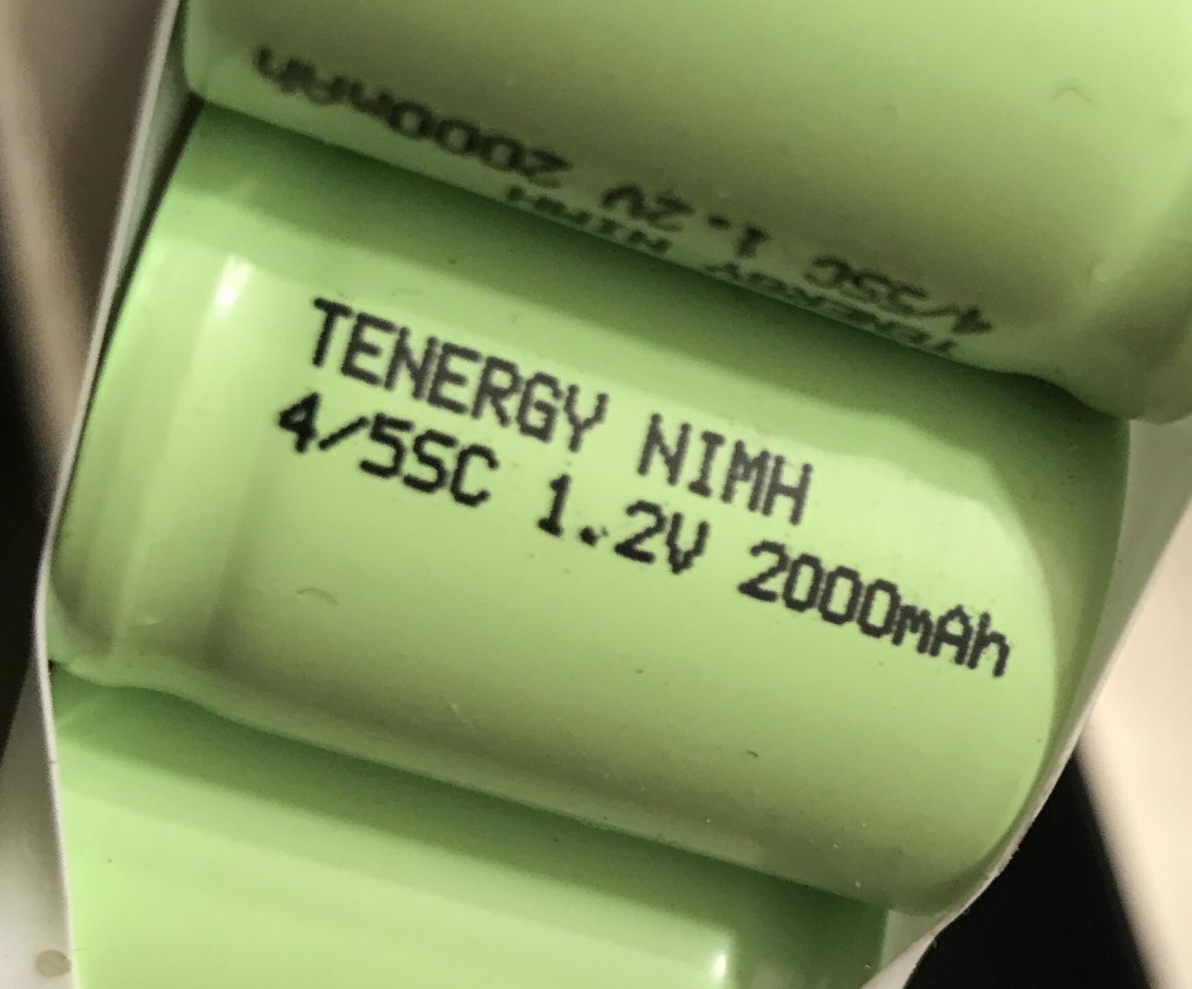

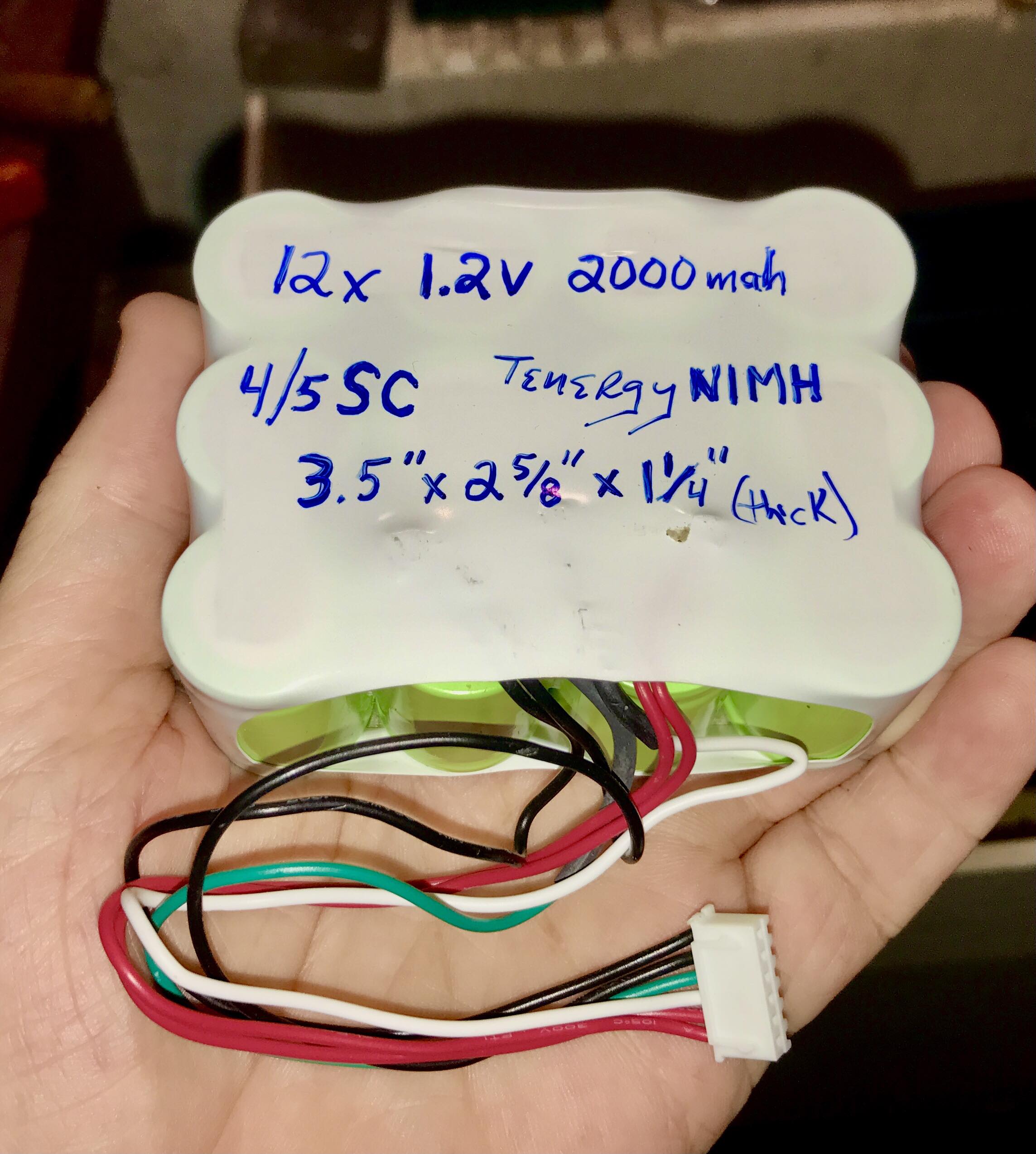

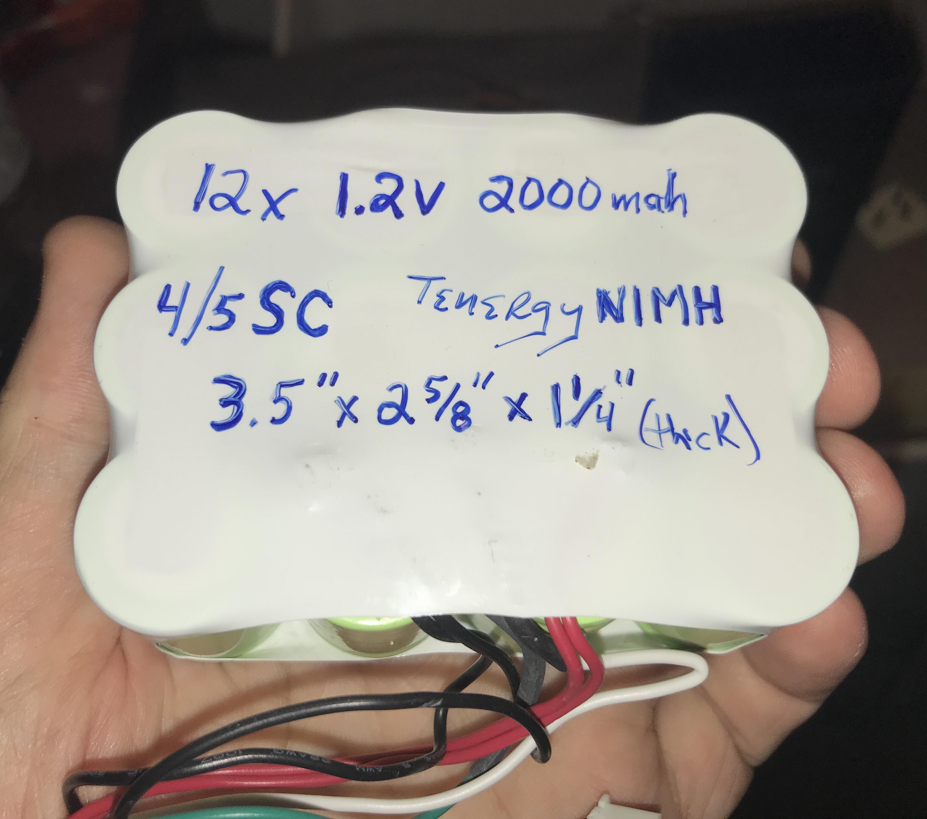

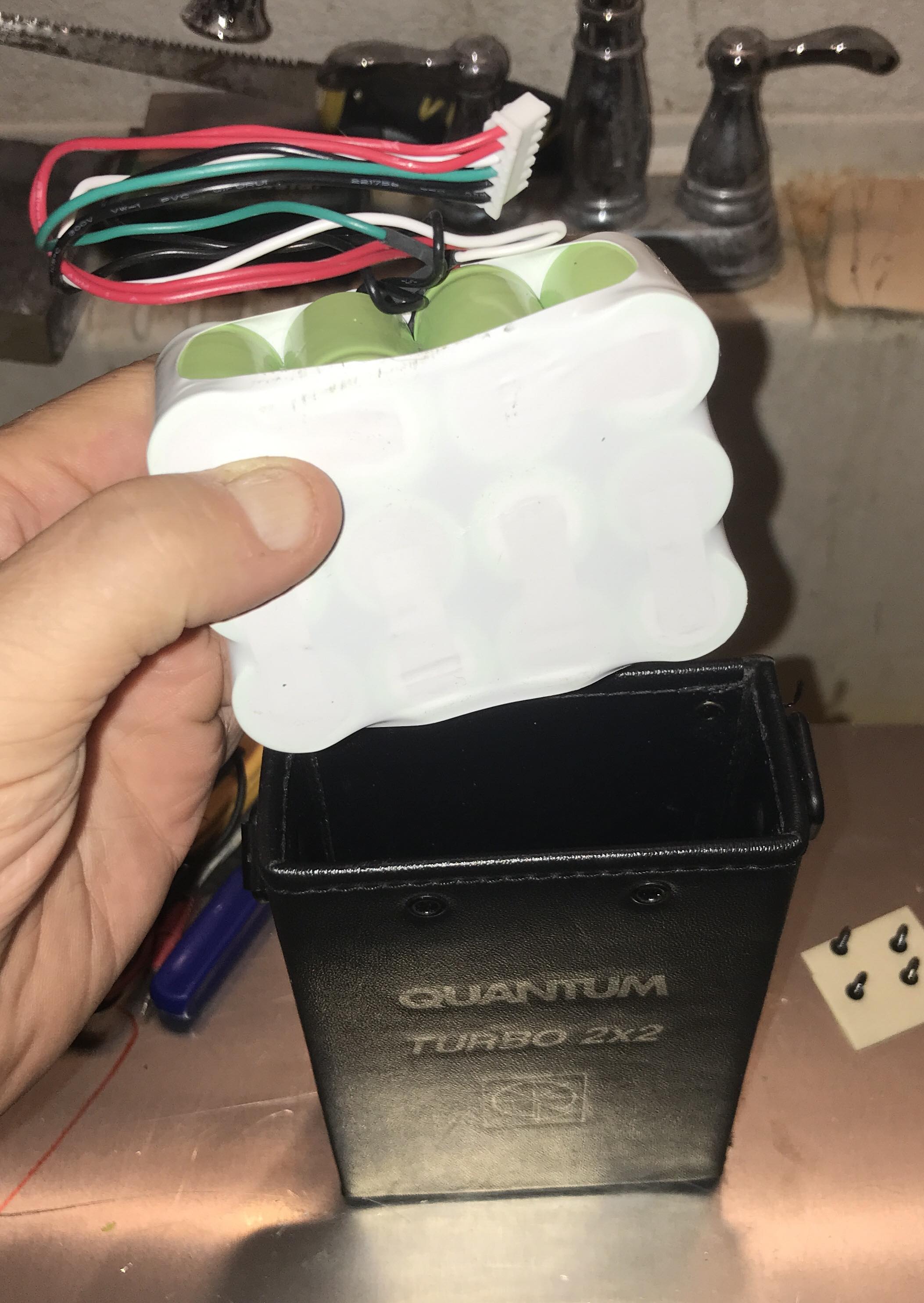

The Quantum Turbo uses a single PS-832 lead acid cell, but the Turbo 2x2 switched to a different rechargeable battery chemistry and IIRC it uses 12 welded-in 1.2V 2000mAh NiMH cells
The Turbo seems to use a bit of double-stick tape to adhere the battery body to the inner surface of the case, and a metal shim can break that seal to ease removal of the battery from the case. Never having done a rebuild on the Turbo 2x2, I cannot provide tips on the rebuild process.
Yeah I have it all apart now. I think one of the battery shops (Battery+) can do these on the retail size... or some chinese group with photos. I got the bundle loose with a firm gravity smack on the ground too... no cutting req!!
Maybe these will help other pre-make a pack they need.
