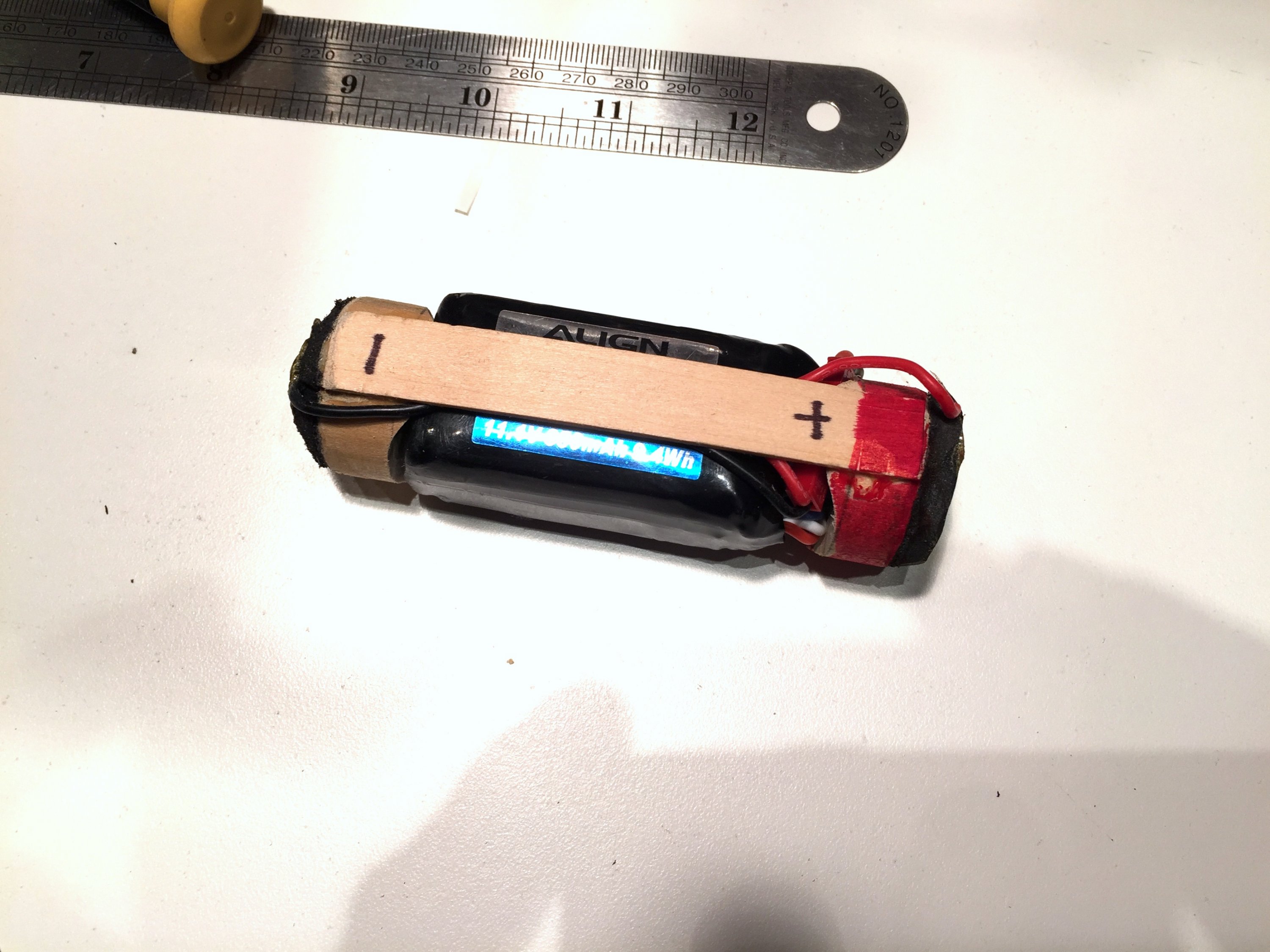

If you know about Lipo and know how to charge them, that could be an option. I'm using this LiPo in my Rollei Flash. It can be disconnected from the adapter for balance charging on a dedicated charger. No protection circuit, so I just have to remember to turn the flash off when not in use. If I do trash the battery from over-discharge, a new one is less than $10. That is less than the 'throw-away' batteries for my Nikon

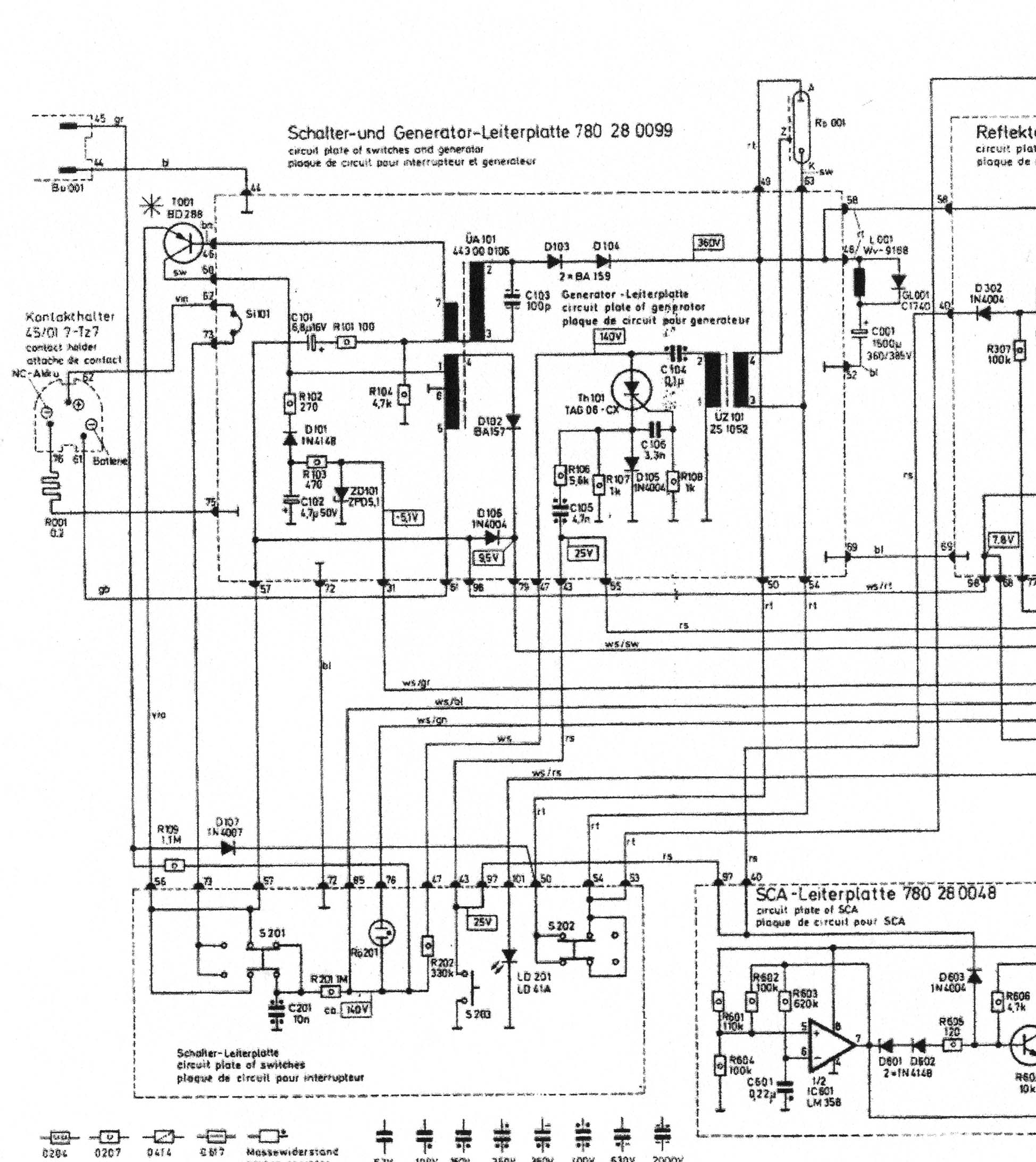

A copy of the service manual for the Metz 45CT1 can be purchased here: http://www.metz.user-manuals.com/list-of-manuals-682-6783.html
Attached is the power/flash tube portion of the schematic for the 45 CT5. The PDF only allows printing so this is a scan of the print on plain paper. I speculate the same or similar is used in all 45 series Metz flash.
