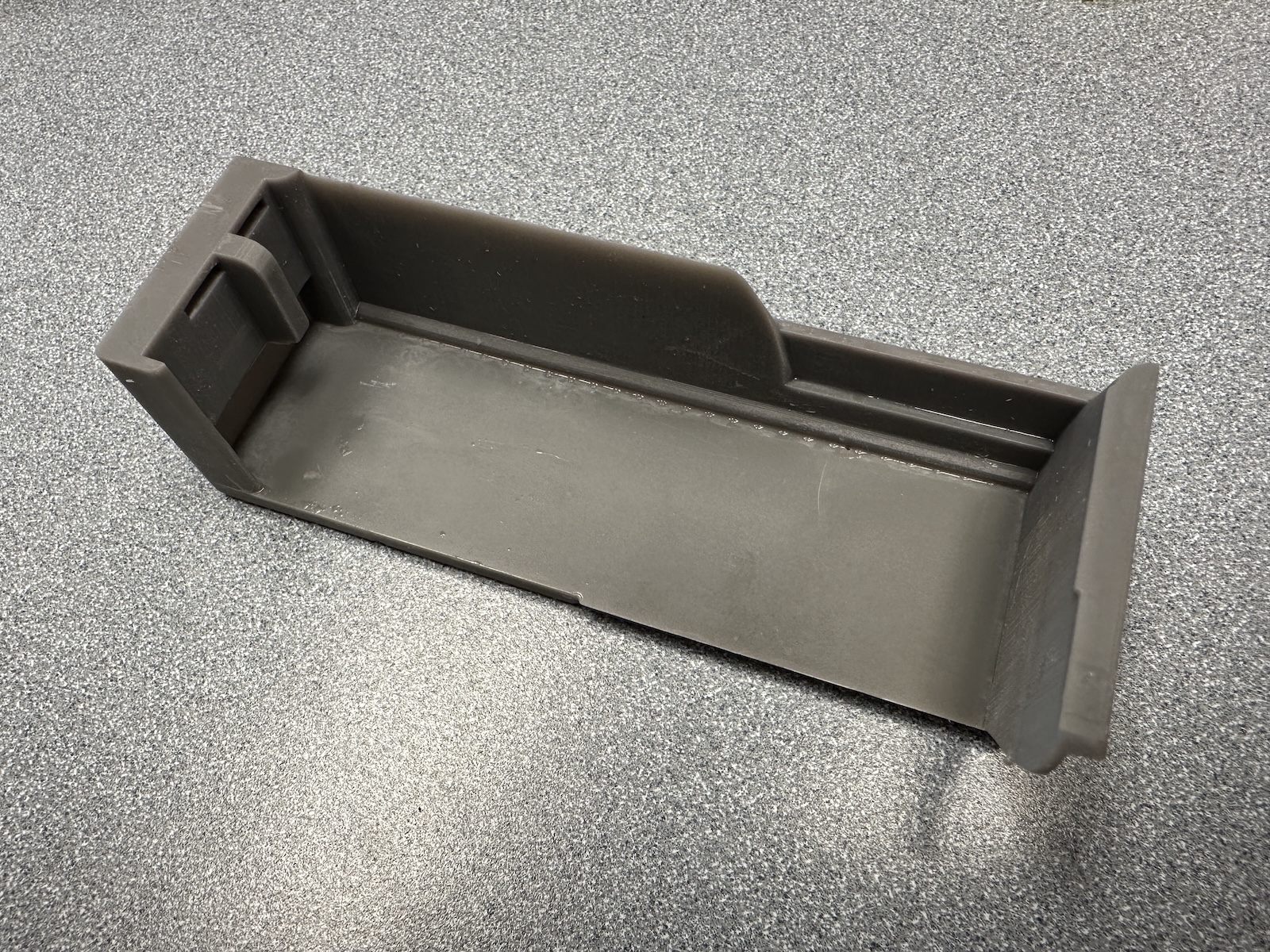

Hey all I don’t know if anybody was still looking for it but I did create a ms-30 I think… (8xAA batteries). I haven’t looked into it for a while but despite never seeing or having a battery compartment I was able to create a working sled from photos.
If anybody wants the file reply and I’ll post it with additional instructions.

Yes, it’s still working since the day I made it. The design isn't perfect, but once it's up and running, it's been very consistent. Occasionally, the contacts shift, so I have to adjust them a bit to maintain a good connection.
Are you having any issues building it? If so, I can help.
Or are you referring to modeling the original 8-battery holder?
