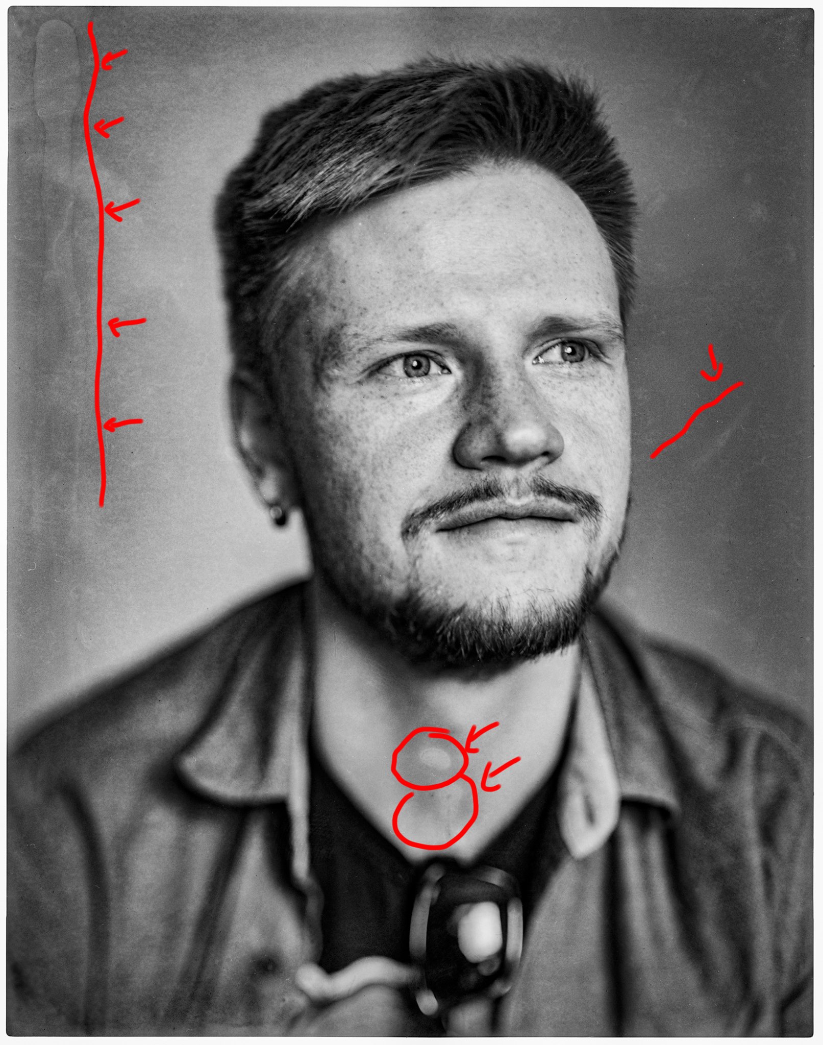

Hello,
Need help :smile:
I've mixed one liter of pyrocat HD in glycol and I'm getting strange steaks, mainly in highlights.
9
This one developed 1:1:100 @24celsius, extreme low agitation, 4cycles, first 1min, later three cycles 10sec each , total 14min.
Fomapan 200@100. (I emphasized those steaks in photoshop)
Was searching forum with no luck and recently read in Anchels cookbook, that it could be aerial oxidation, but no examples in that book.
Should I increase part A dilution for example 30%?

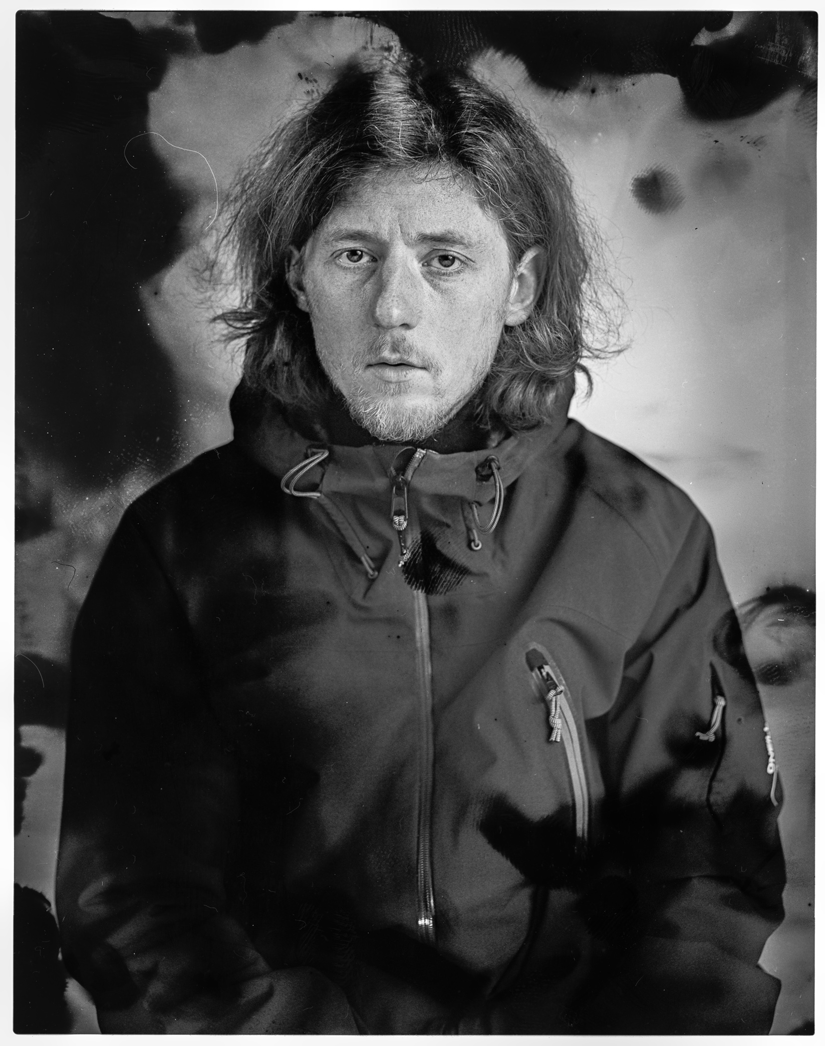

Another example, this one more extreme, but it was tray developed
9
Thanks in advance for your oppinions !

The upper left in the first image looks like dry marks from water to me. How do you dry the negatives ? Can you give a more detailed description of your development process (start to end) ? I would change to a more vivid agitation scheme, e.g. constant agitation (reduce development time by 30% or so). This will give you a quick reference, whether agitation may be the problem. Many development issues discussed here in the past were related to agitation in one way or another.
The second looks like it was not fully covered with developer in the tray.

I'll take a guess - uneven wetting of the emulsion at the start of development. The suggested cure is to presoak in water for about 3 min with some agitation and then agitatate again when the presoak is first replaced by developer, then proceed with the reduced agitation as before.

Highly dilute developers are subject to aerial oxidation. With stand or semistand development they are also subject to bromide drag.

Thanks for reply, I've dry them in room temperature, just leaving standing holder of combi-plan's tank. These streaks are also on other negs from the same developing batch, on the side where I was pouring developer to tank.
My agitation scheme is constant tank inversions for the first minutes, second is 10sec after 3mins, next is 10sec after 4 mins, and last is 10sec after 4 and half minutes and left standing still. Total time 15min, temperature 23celsium

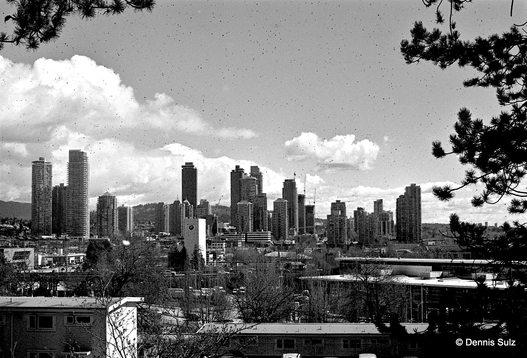

I do my Orwo N75 & N74 as well as Delta 400 with this method but for some reason the Orwo UN54 develops pinholes when I use Pyrocat to develop it. There have been posts here about that problem also and what I tried was ordering a 400' roll from Germany so I knew it had to be fresh but still pinholes.
