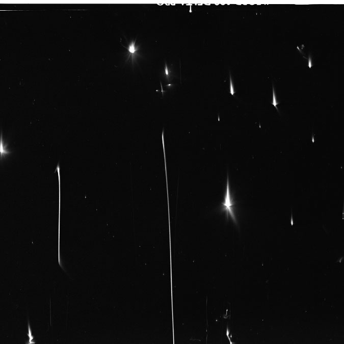

I just mixed up a batch of Pyrocat HD (Sandy King formula) and got some horrific results. I've used this formula with great success in the past. I'm suspecting that the chemicals are not fully dissolved. This example is an unexposed section of film. The film is Ilford Delta 100. The frames that were exposed look great with the exception of this same nastiness. Curious to know if anyone has experienced this. I will be having a real close look the A and B mixes to be sure that the chems are fully dissolved.

It seems that the B part (Potassium Carbonate) had some undissolved critters swimming around. I've re-stirred the A and B parts, filtered them and ran a roll of Delta 400 and it came out clean. More testing with the Delta 100 to be sure......
This can happen with any developer home made or pre-packaged, it's one of the reasons it's usually suggested powdered developers are made up the day before use.
I've seen a similar problem when developer's contaminated by residual hypo crystals from poorly washed college developing tanks, the comet like trails are the same but the effect is the opposite.
Ian
I use the liquid concentrate. (No problems.)
Not sure if it was contamination or undissolved chemistry but all is well now and the negatives look great. :smile:
Concentrate B is essentially a saturated solution which will cause problems like the one mentioned. There is no reason why you cannot make this solution as half strength and just use twice as much to make up the working developer. In fact if you do this you can use sodium carbonate instead of the more expensive potassium salt.
