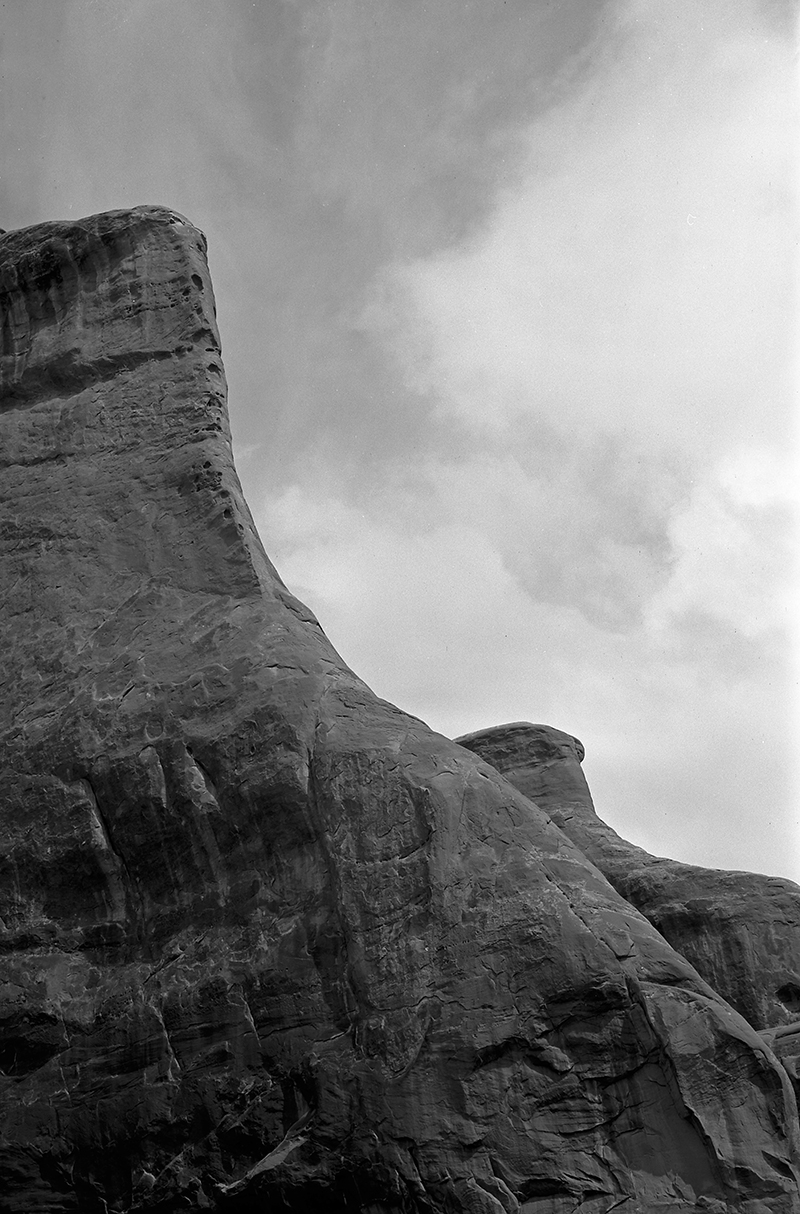

Here's an example from a handheld 6x9 taken in overcast. The actual print is way better, but you get the idea.
