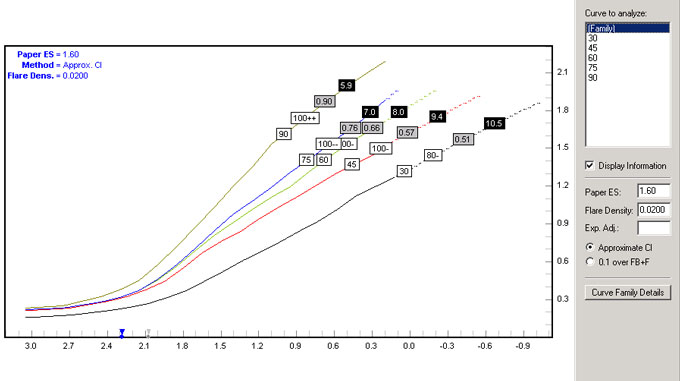

Hi, during this week(here rained cats and dogs) I tried to do an experiment with fomapan 100 in pyrocat-HD with semi-stand agitation in 1:1:175 Paper ES 1.60 diluition,after I read the density and this my result:
SBR 7 EFS 90 developed 75.30 minutes NORMAL
SBR 5.95 EFS 100 developed 90.00 minutes N+0.60
SBR 8.70 EFS 95 developed 52.00 minutes N-1
SBR 10.54 EFS 80 Developed 30.00 Minutes N-2
I hope this date are for you useful, and I'LL try it on the field when the weather will be better...
Bye
Stefano
I attached pictures of my winplotter curves. :smile:
