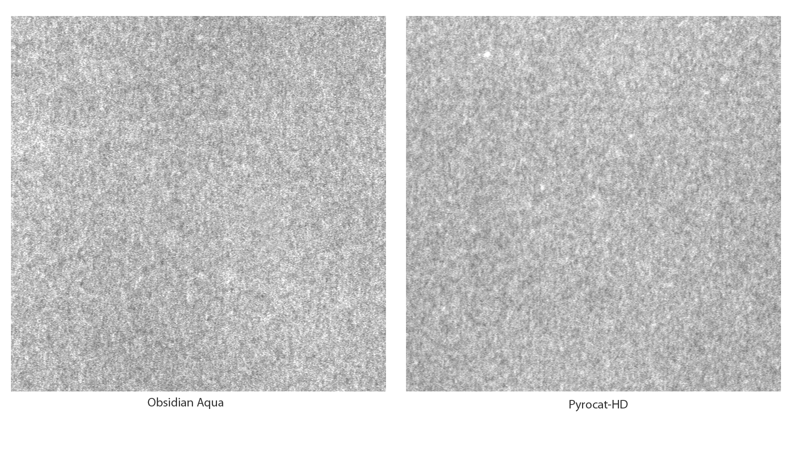

I posted this over at the LFF and I figured I'd do the same here. Wanted to get up close and personal with grain after developing a sheet of 8x10 FP4 in pyrocat-hd and another in Obsidian Aqua. From my eye, it appears that OA has a slight edge in sharpness. Pyrocat-HD's grain appears softer. But, you be the judge.
I'll keep playing around with it. Particularly interested to see how it behaves as a stand/semi-stand developer.

Andy,
I read your comments sometime back on the LLF forum, but this is the first time I've seen the results. It does seem to have slightly sharper grain, but how are the tonal qualities compared to Pyrocat-HD. I like Pyrocat-HD, but I think I like the looks of Pyrocat-MC a little better. Both HD and MC negatives print very nicely and that's coming from a so-so printer. JohnW
I've started working with PMK Pyro. And so far, loving it! Used it with Efke R50, TXP (At ASA-250), Ilford Delta 100 (4x5), and Adox CHS100 (35mm). Plus I can get it shipped up here to canada as it comes in powder form from Formulary. Below image is TXP at ASA-250.
Andy,
John, I can't really say until I print the negative. But, going by the negatives, tonally speaking I would say very, very similar. If you are happy with pyrocat-hd and MC, I'd stick with them. My main developer has been pyrocat-hd for years. I only tried OA because I ran out of the Chemical for stock solution B, and I always wanted to try Jay's Obsidian Aqua.

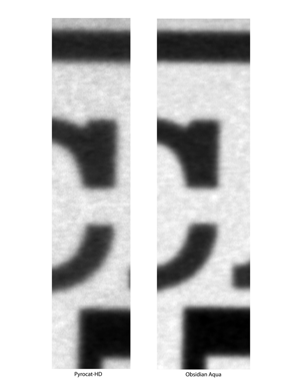

Here are some better comparisons: The image on the left is the pyrocat-hd negative. OA neg is next to it. I indicated in red on the OA neg where the crop came from, from both negatives. That translates to quite a large enlargement. The difference is there, but very subtle.

Andrew, thanks for the comparison. Could you tell us more about your development procedure for OA, what EI you are getting and any other observations.
