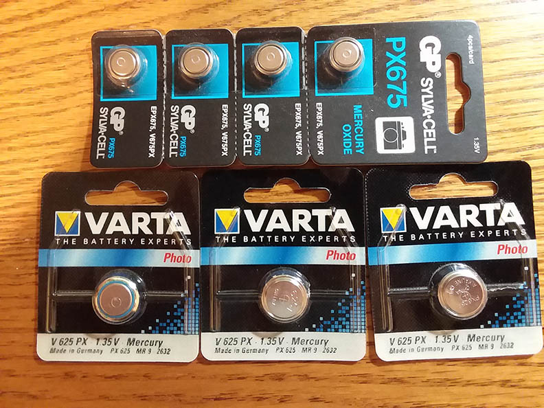

I am looking for the same, anyone with experience dealing with this same guy. I have need of both PX675 and PX625 batteries as I am running precariously low on my stock. My Gossen LunaPro and Konica cameras use these varieties. The remaining few I have came from "The Battery Guys" in Mississauga, Ontario, Canada but they no longer list these numbers for sale.
