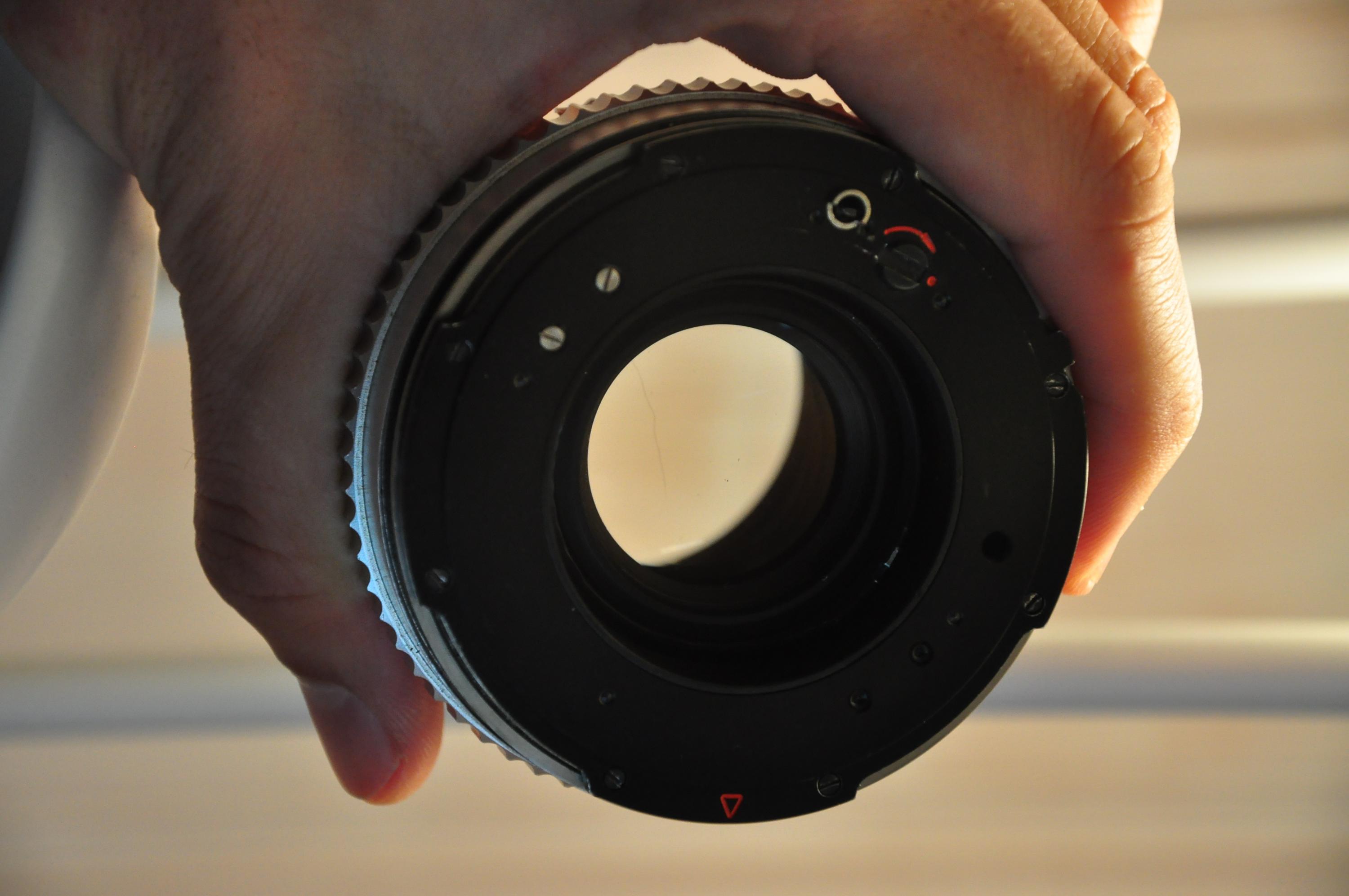

Hey,
So I'm trying to put together a 500cm with 80mm setup from various parts that I have, and am wondering which setup is best when comparing age, condition etc.
Interested to hear how you guys would choose...
Lens:
80mm C in excellent condition except for a small hair (i think) inbetween some of the glass elements OR
attachment.php
80mm C *T lens in good condition but with sticky aperture blades. Shutter times are good
Body:
All 500c/m in about the same condition. Newer bodies better than older bodies? Or should I go with an older body if I feel it's in better shape?
As always, thanks for the help!

Welcome to the world of the Hasselblad V system!
You certainly can't go wrong with a good 500C/M. I've had mine for about 25 years and it has always performed well. The newer bodies in the 5xx series will provide options like a larger mirror (I think they called it a "floating mirror") that helps with vignetting of the viewfinder when using longer lenses, add-on motorized winder capability, etc. If you think you'll need/want any of these options, then you'll have to research which body will fit your needs best.
Lenses? That's such a personal choice that it's hard to provide recommendations. The upside is that there aren't a whole lot to choose from; there was, at least, one zoom made (can't remember any of the details) but I'd personally avoid it...too heavy.
Good luck!

I'd go with the T* and send it in for a cla that shld take care of the aperture issue.

I would say that condition trumps age for the body.
For the lens, if the prices are similar, get the T* and have it serviced.

Thanks everyone! I'll put the C on until the T is serviced then :smile: May be a while until I get it serviced though as prices in scandinavia are through the roof. Averaging about $350 for a service I believe.... What effect do the sticky aperture blades have? I'm so ignorant about the actual workings it's embarrasing. Do they go up and then stop down again when shutter is released or stay stopped down if I press the DOF preview?

Do you know if the iris goes up and then stops down again if I have it in DOF preview prior to pressing the shutter?

If you stop down to see the DOF, the iris will open back up unless you locked it in the stopped down position. Either way, after the lens is fired and recocked the iris should completely open up.
Yep that happens. What I'm wondering about is this mechanical swooshing noise when turning the shutter/aperture ring. Is that a normal sound on the T lenses? Or is it sticky blades? If it is sticky blades I was thinking that I could take the shot with DOF preview engaged so the blades are already in position. Assuming that they don't open back up before starting normal firing sequence...

The swooshing noise I believe is made by the whirring of gears in the timing escapement as you change shutter speed settings.
Yep, I just read that online. Is it a normal sound or a sign of wear and tear? My C lenses don't make this noise but the *T does...

Several of my leaf shutter lenses make this noise, so I'm hoping it's the former. You're sending in this lens for a CLA eventually anyway for sticky blades, right?

Thanks Frank. Actually I thought that noise might have had something to do with the blades as my C lenses don't make that noise so I guess it's actually fine. Will kit it up with that lens!

Can you defeat the EV lock and determine whether the noise comes from the aperture ring or the shutter speed ring.

It only happens when turning the aperture ring (which is connected to the shutter when turning). The shutter speed rotates around without sound when I separate the two.
What he says, it's winding the slow speed escapement.
