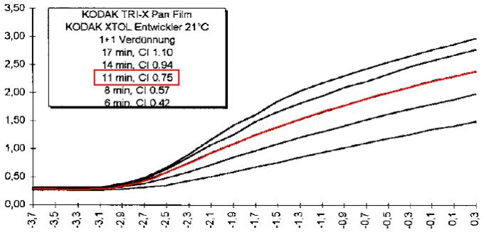

Kodak Xtol & TX graph

Here is a Kodak Xtol publication (in German ).
I've highlighted the CI .75 curve in red, Kodak's suggestion for EI 1600.
