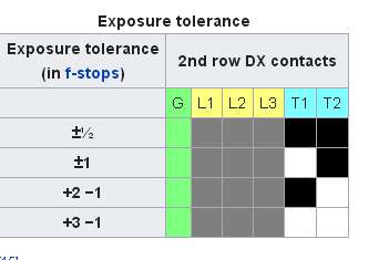

First, you may see the sensitometric curves manufacturers usually publish in the dataheets, this explains how film behaves, but you should know how to interpret those curves, read Beyond The Zone System by Phil Davis, you will practice with Logarithms.
Second, 35mm cartridges (135 format) having DX code have basic film latitude encoded, so when the camera uses Matricial metering mode the camera knows how to balance exposure in that metering mode.
