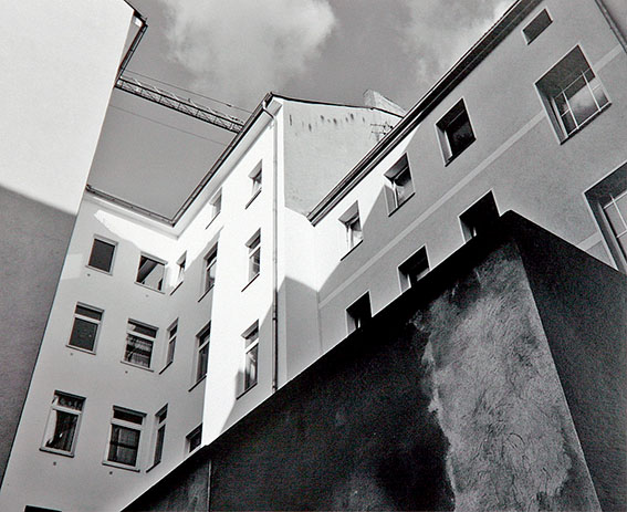

OK, let’s take a different approach.
If you meter a 400 film at 200 you will achieve more shadow detail. This MAY cause your highlights to become too dense and therefore difficult to achieve details on the print. If this is the case you reduce the development time to compensate and bring the highlights under control. The starting point for ascertaining the correct development compensation time is to begin tests with 20% less development time.
If you meter a 400 film at 800 you will loose shadow detail. As there is little to no shadow detail you will quickly achieve a black on the print but you will find that the mid-tones and highlights will look grey and the overall print will lack contrast. If this is the case you increase the development time to compensate so that the mid-tones and highlights are denser, have more contrast and therefore look much better on the print. The starting point for ascertaining the correct development compensation time is to begin tests with with 20% more development time.
However, you have to be aware that all of the above relates to a scene with a 'normal' range of tones. A low contrast scene will probably benefit from push processing (look at Matt King's example photograph).
A scene with high contrast (such as this one attached where the bottom right hand side is in shadow and depicts an old plastered wall darkened by smoke form the bombing of Berlin and over 40 years of soot from the brown coal that was used for heating in East Berlin and the rest shows a newly painted white wall with part of it in full sunlight) will probably benefit from pull processing.
So specifically to your questions:
Shooting at box speed of 400:
  • metering for 200, over exposes film, so you're pushing it? No, the correct term is pulling the film because you are pulling back the development and density of the highlights on the negative
  • metering for 800, under exposes film, so you're pulling it? No, the correct term is pushing the film because you are pushing the development time to ensure that highlights have more density on the negative
Is shooting and metering it at 400, and adding +1 or -1 EV (Nikon F5) the same thing as the above? Yes, this is exactly the same. 1 EV is equal to one stop.
  • Therefore, setting +1 EV on your Nikon will deliver one more stop of exposure and is the equivalent of exposing your 400 film at 200.
  • Setting -1 EV on your Nikon will deliver one stop less of exposure and is the equivalent of exposing your 400 film at 800.
And:
  • if you meter for 200, you decrease development times by 20%? Yes, this is correct BUT ONLY if you find that normal development time causes the highlights to become too dense on the negative.
  • if you meter for 800, you increase development times by 20%? Yes, this is correct BUT ONLY if you find that normal development time causes the mid-tones and highlights to have a lack of density and contrast on the negative.

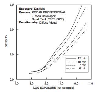

my question is about pushing and pulling polymax 400. this film seems to have very limited changes when pushed with +1, +2, -1,-2. what say you?
MattKing
Apr 24, 2005
52,124
Delta, BC Canada
Welcome to Photrio.
I don't recognize that film. Are you perhaps meaning to refer to TMax 400?
If so, you may note that Kodak recommends no change in development if you under-expose it by one stop. I certainly have seen change when I've tried to use it with two stops of under-exposure and the two stop push development recommended by Kodak.
I don't do enough pull developing to help you there.

4 or 5 stops is a lot less than is available with T-Max 400 exposed and processed as a negative.
Even slide film can record that range.
