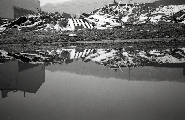

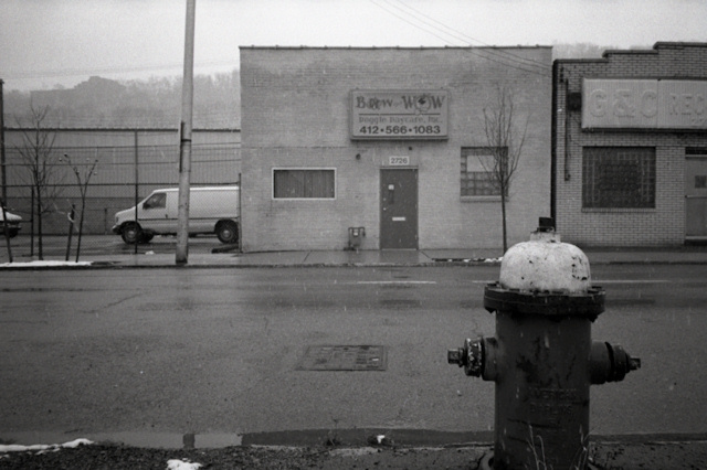

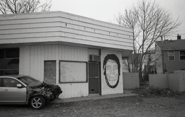

Again, thank you all. Least I could do was share some of my results, I thought. These unfortunately are scans; I feel the urge now more than ever to get an enlarger. I've already started scouring Craigslist. Meantime, these are about as unmanipulated as I could get them.

Aw, hell. Nothing to worry about. I would push as a matter of course in that type of light! You actually got better negs by making your mistake than if you had done everything "properly."
