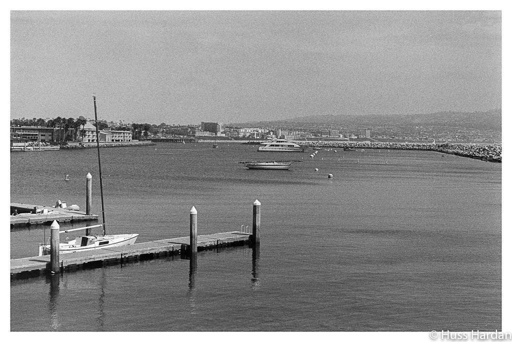

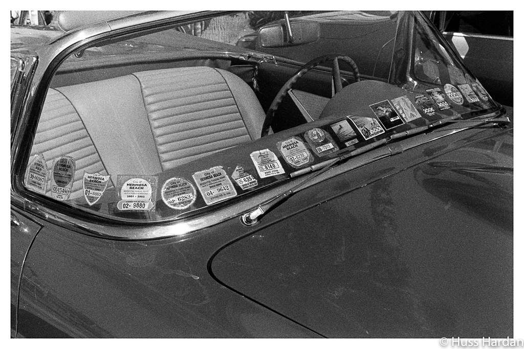

Shot another roll of Kentmere 400 @1600, dev in DF96
Leica M3, Summicron 50 DR
Pushing to 1600 in those lighting conditions is kind of pointless. And it’s also completely different from pushing for low light performance.
Contrast and total light flux is completely different.
