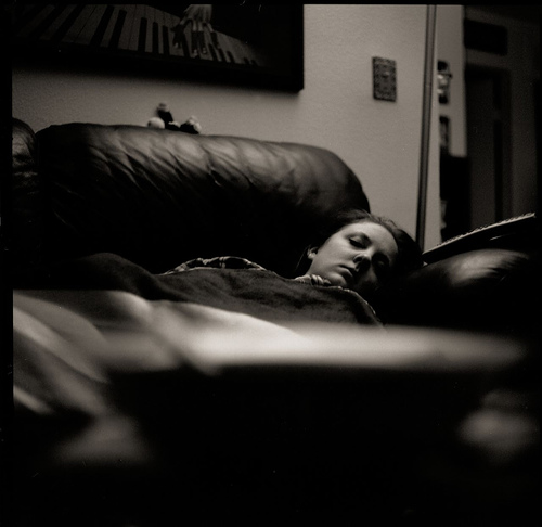

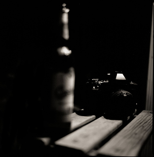

A while back I pushed Neopan 400 to 3200 in HC-110 Dilution B for 18 and had very minimal grain. I think I could have easily gone 6400 or 12500 and had reasonable grain. Shadow detail was pretty null, but the negs were not too dense and printed easily. So far though it only seems to work with 3200, I tried pushing neopan 400 to 1600 and 800 and both times there was far more grain than at 3200, very strange. I'll soon try 6400.
