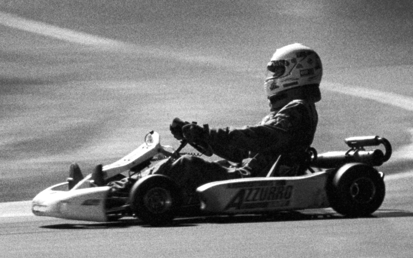

Karting
Nikon FM2n, D3200 @ 1600, DD-X (1:4) 8mins @ 20C(2nd image is 1:1 crop of image 1)

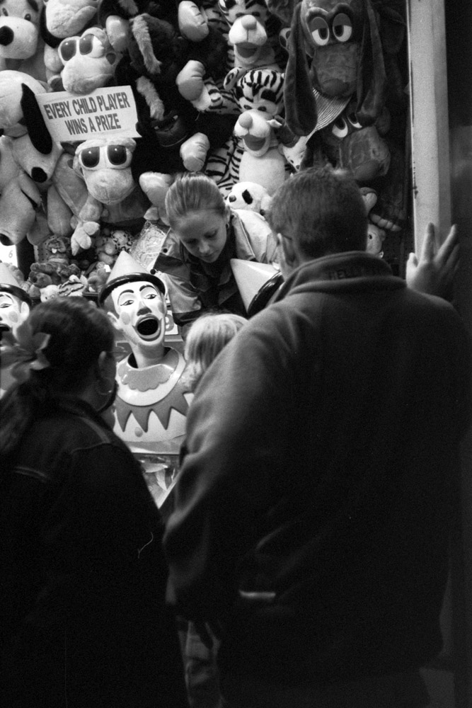

Moomba Carnival
Yashica ME1, HP5+ @ ? (set camera to max aperture of f2.8 and hoped for the best) , LC29 (1:9) 11mins @ 20C
