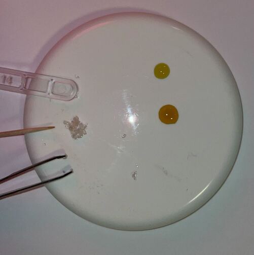

Thanks for these very interesting replies Frank !
I have made a small test with 2 drops of 20% ferric oxalate, and added a couple of crystals of ferric nitrate to one : the color shift to amber is obvious, which should indicate that the oxalic acid is indeed getting eliminated from the ferric oxalate solution :

I am not an authority on the subject by any stretch of the imagination, but the brown color would also mean you have an excess of ferric now. Ferric oxalate is not a simple compound with 2 Fe(3)'s and 3 (C2O4)'s but kind of bunch of them associating to form a structure that gives that green color. If you add more of iron and the structure gets broken up and the color changes.
Rather than doing an experiment on drops, I would do one using ferric nitrate solution and adding it to the sensitizer solution in incremental amounts (not worry about whether there is "excess" oxalic acid or not) and see if precipitates redissolve. Once you have found a minimum amount, then study its effect on the speed and contrast and hope they do not become impractical.
