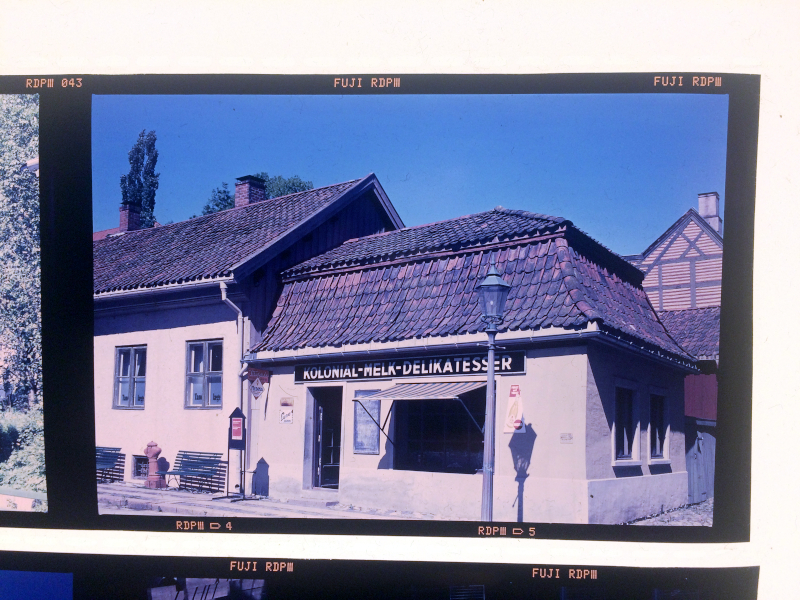

one of the image did show how the film does look like after development. A closer shot (taken on a light box with a given light temperature, with a mobile phone, so already "renderings") of a frame:

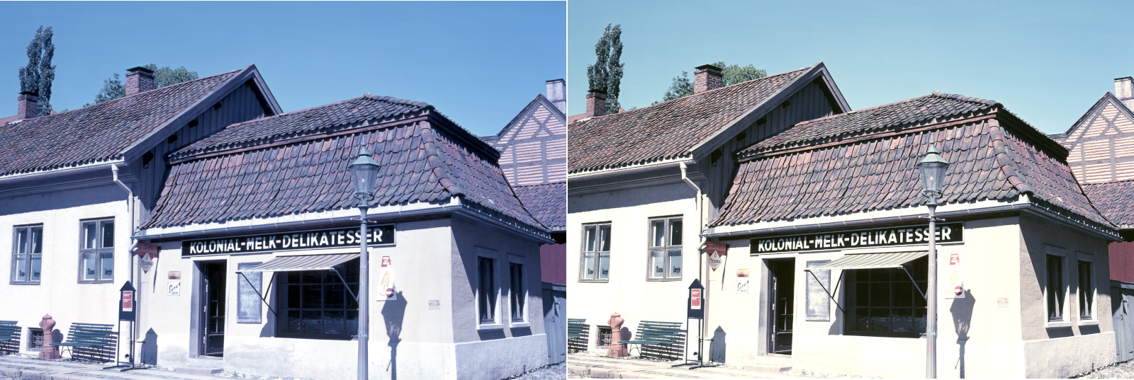

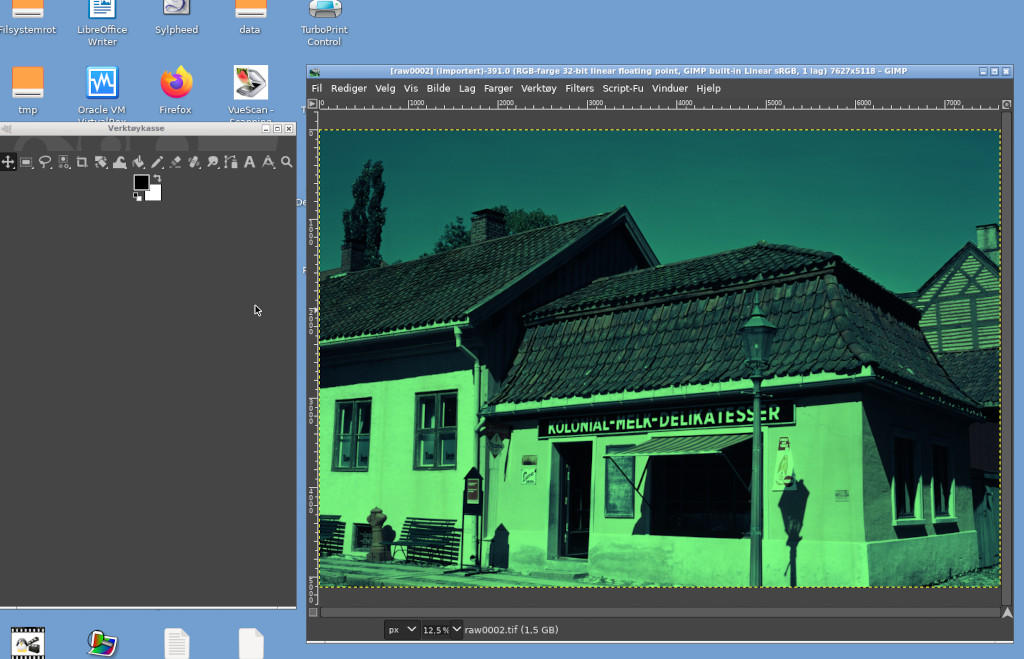

anyway, let's take the case of this film frame with the old kolonia-melk-delikatesser shop. Here is the raw file of the V700 scan:
https://disk.yandex.com/d/YUTIWvDnS2-swA
loaded into a graphical editor it looks like this:
I have to processs that.
the obvious is to auto-level the channels and set the gamma to 2.2 (sRGB), but there's almost always a blue cast. Here to the right further adjustements bring the actual colors of the tiles, walls, brick, street lamp, foliage back the house, keeps the strong sunlight reflection on the wall, but gives a cooler sky.
The image to the right is not the best possible, but bad? no.

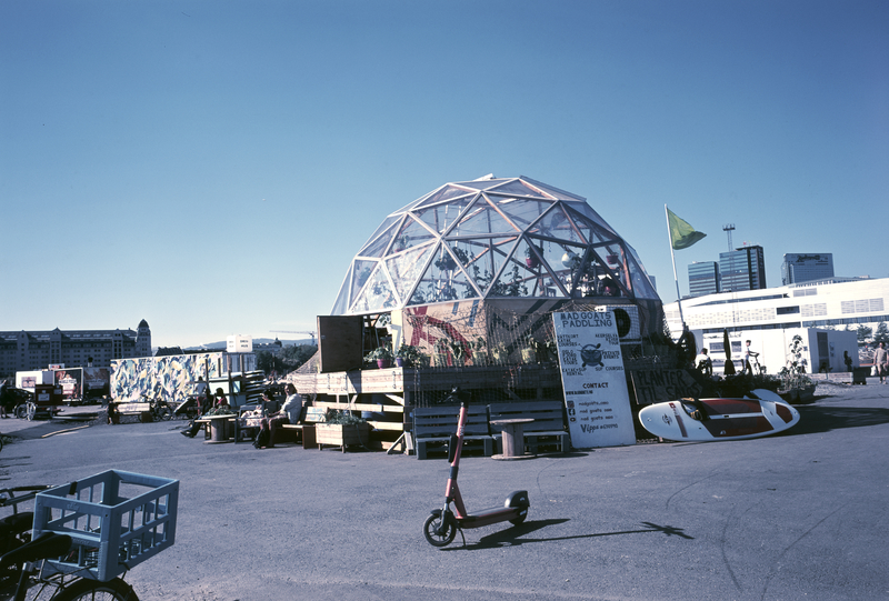

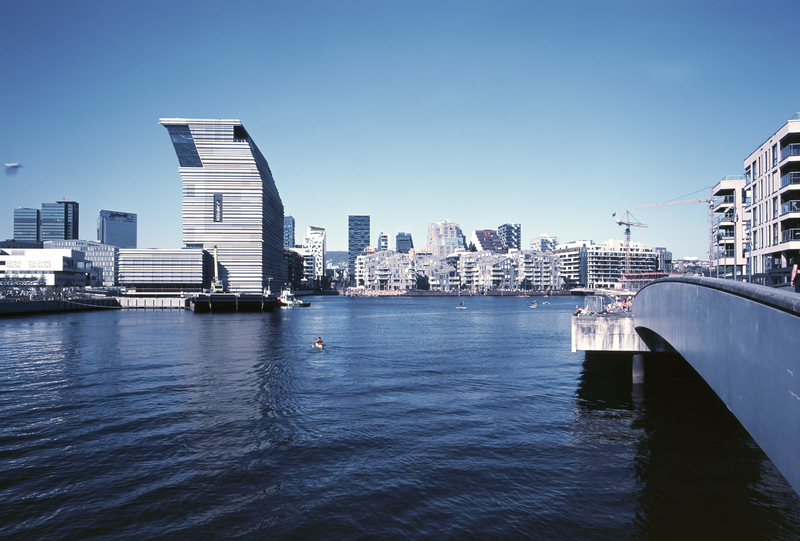

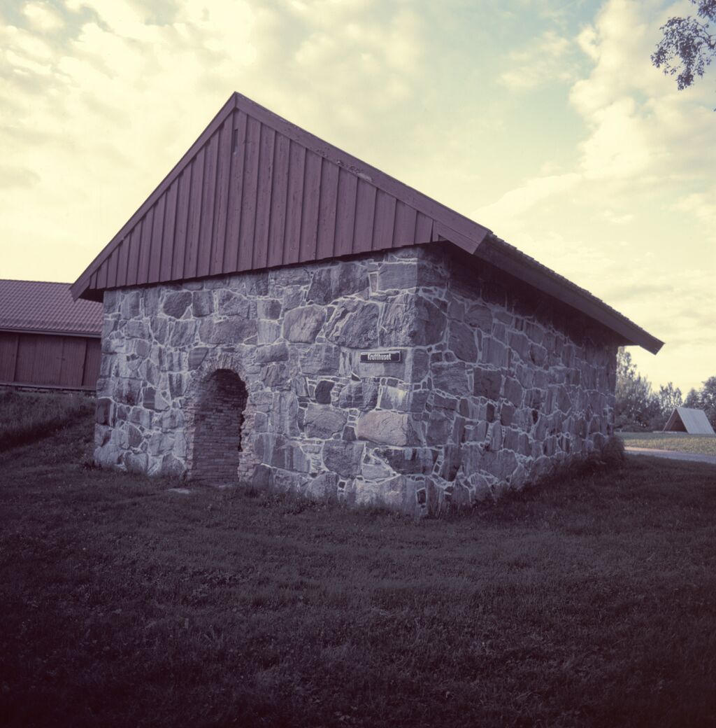

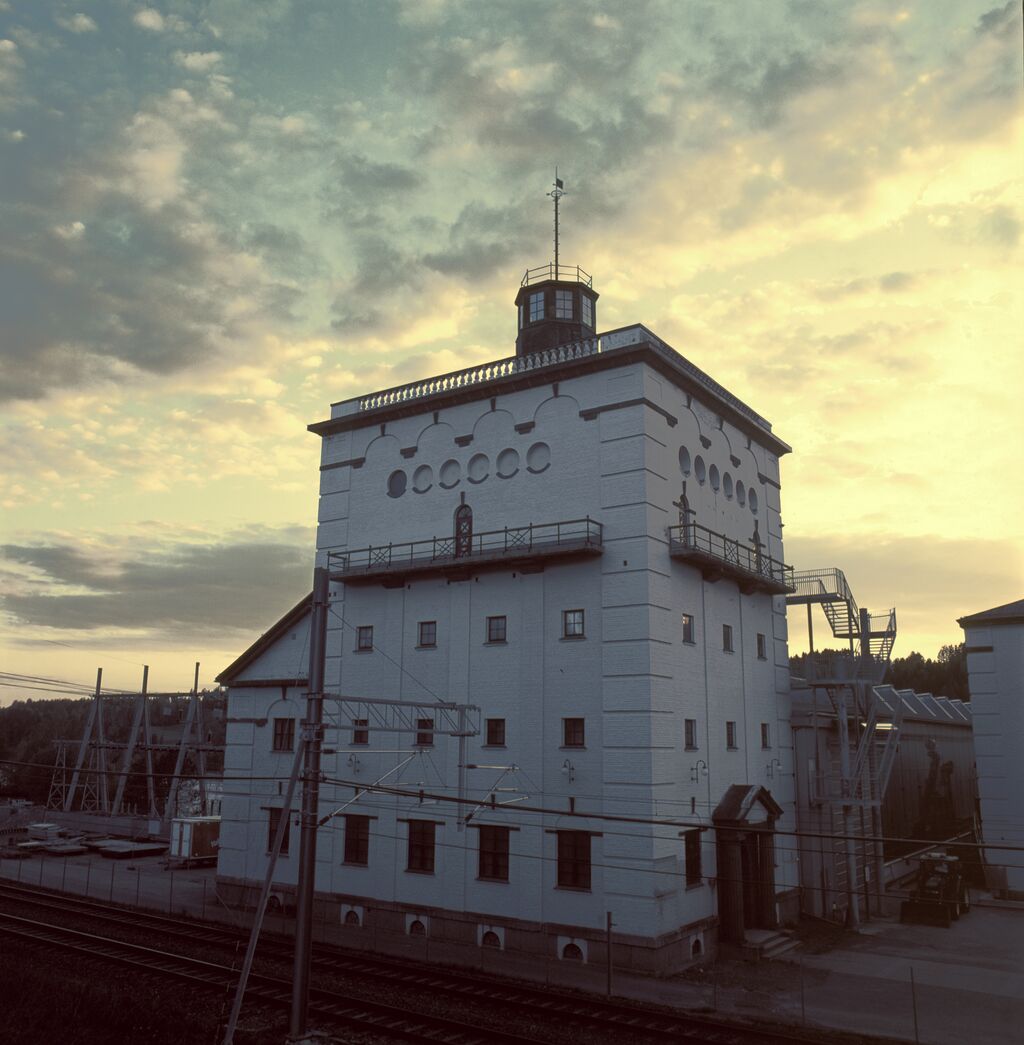

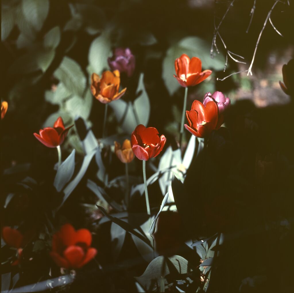

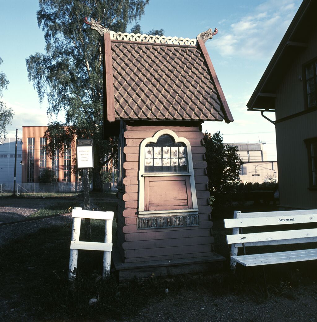

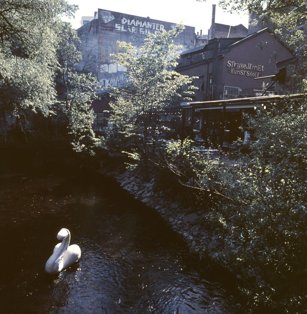

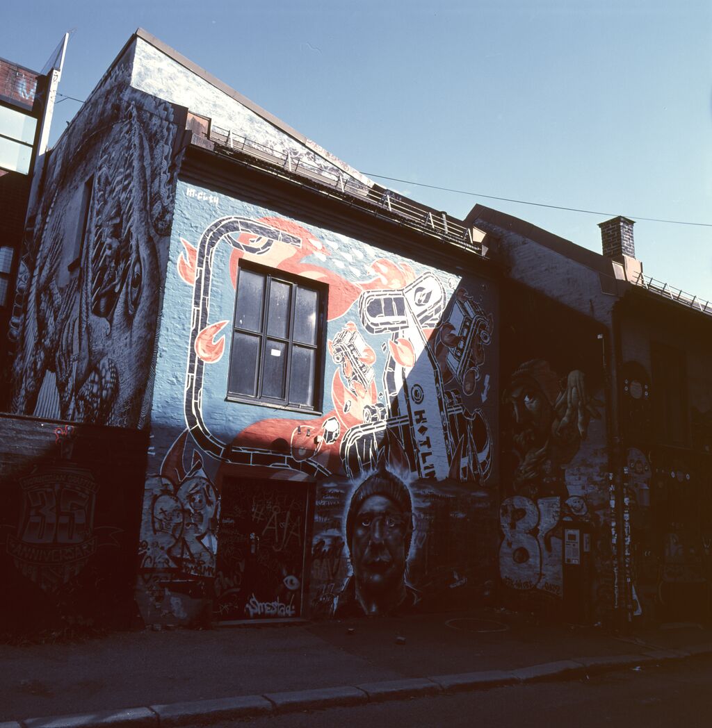

I have a bunch of 2006 and 2009 expired Provia in the fridge, did shoot another roll, and also a fresh Velvia-50. Developed and scanned exactly the same way.
Metering can be tricky with scenes having a wide latitude shadows/lights under strong sunlight, in evening sunligh and after sundown. Reversal film has a narrow exposure latitude and low iso, so I wanted to play a bit with this, in order to see what one can get.
processing of the scans did involve first auto-level and gamma to 2.2, then more or less colour balancing or curves adjustment, temperature, vibrance, exposure corrections. I mostly work in Gimp, or just in the command line with ImageMagick, but also Photoline has proven very convenient. It went fast in fact: do corrections on one of the frame of the film and save as an "action", then batch processing.
2009 expired Provia-100f:
fresh Velvia 50:

well thank you. As I commented in OC these posted images were not optimal.

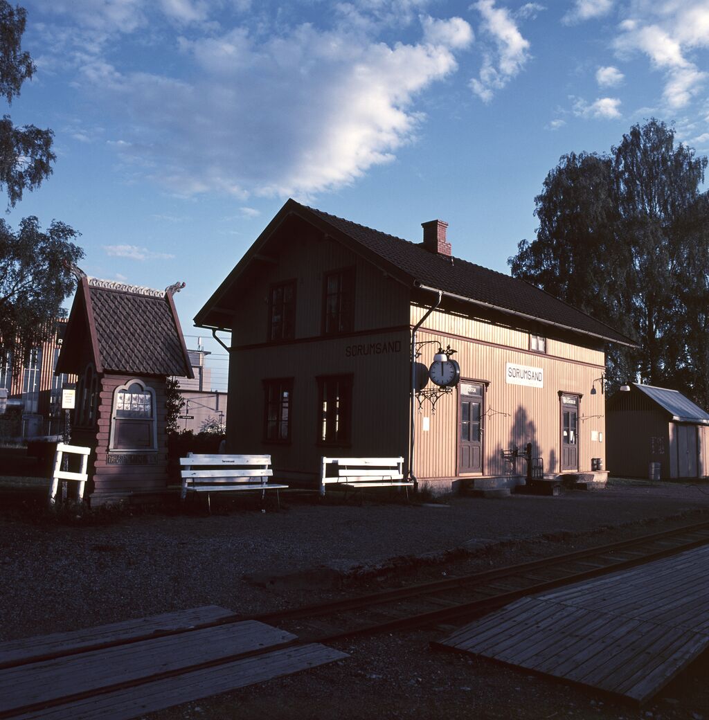

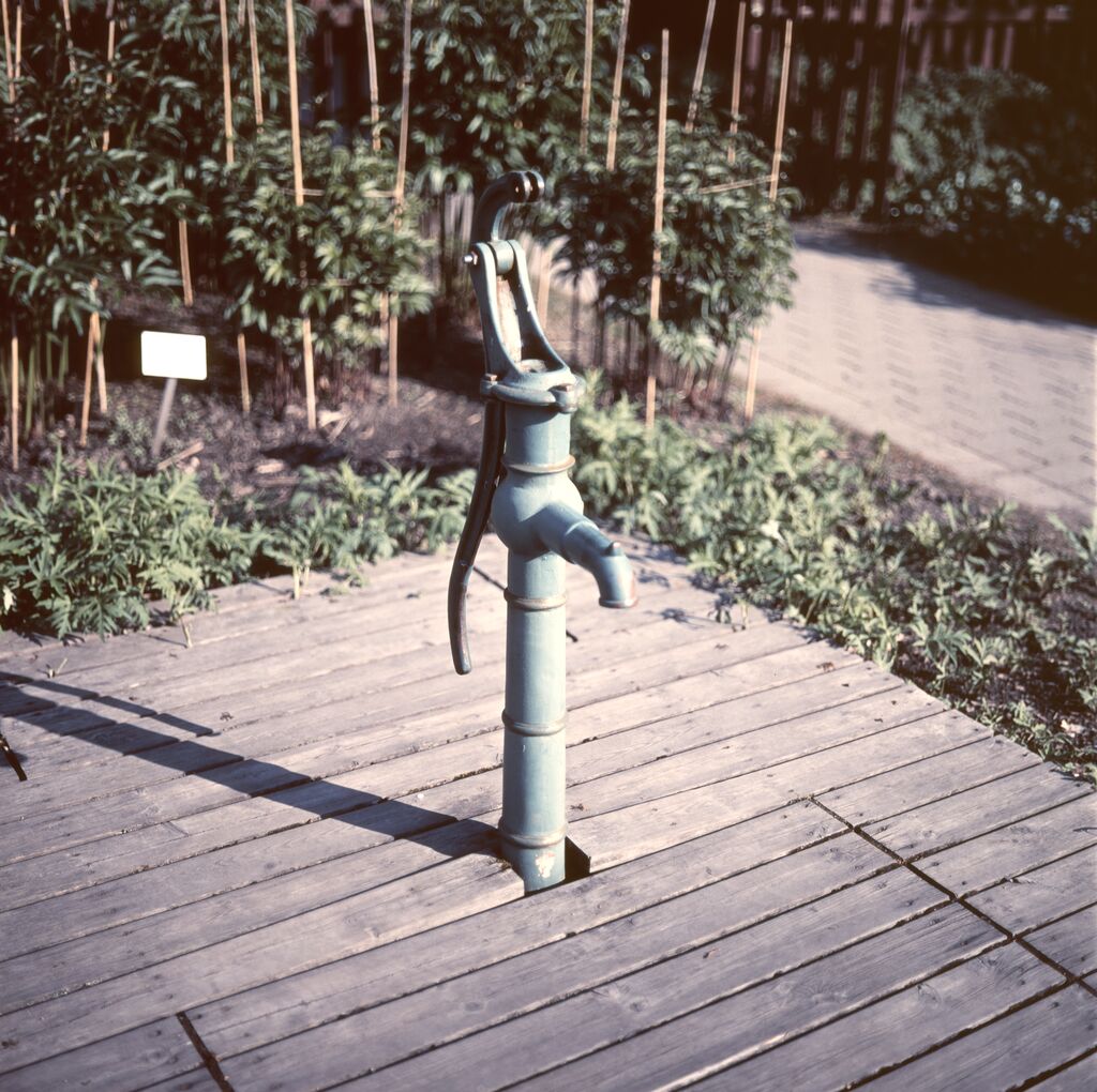

fresh Velvia 50:
