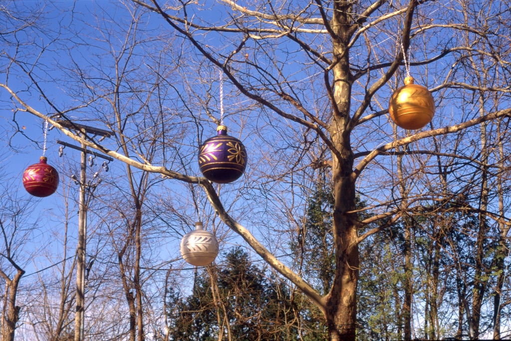

this is how it looks (120 film, 6x9):

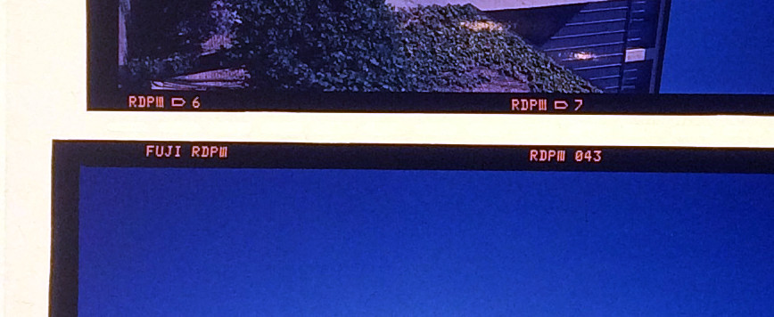

detail with film code:

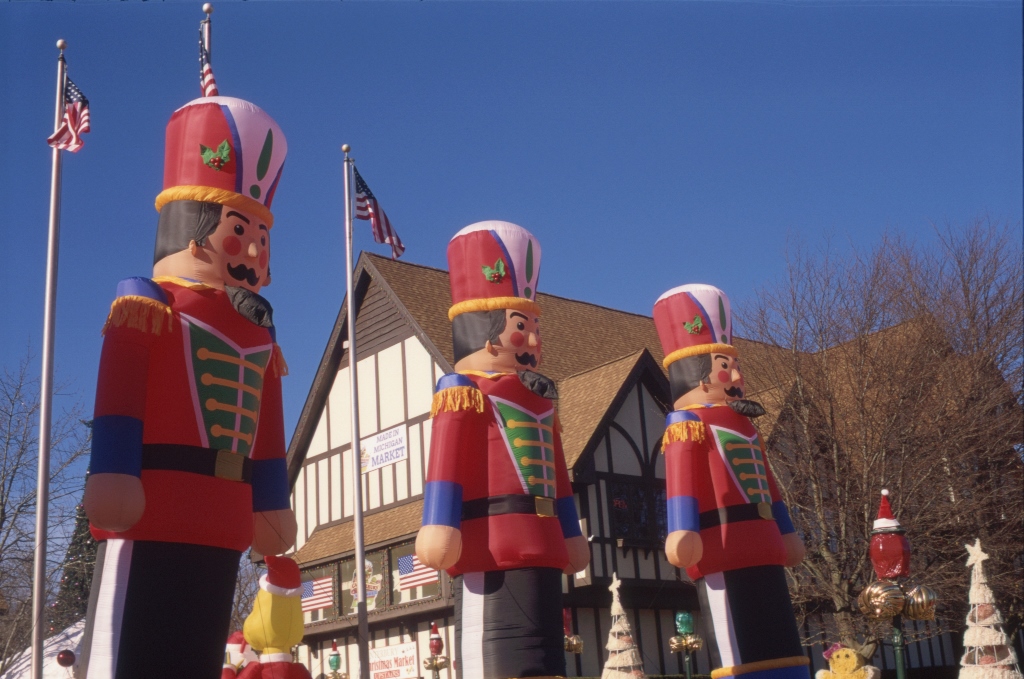

some scans, Vuescan with Epson V700, ColorPerfect inversion (ie. ColorPos module) and slight tweaking with Gimp, mainly had to adjust the gamma betwen 1,80 and 2,20. Requires a bit more tweaking.
