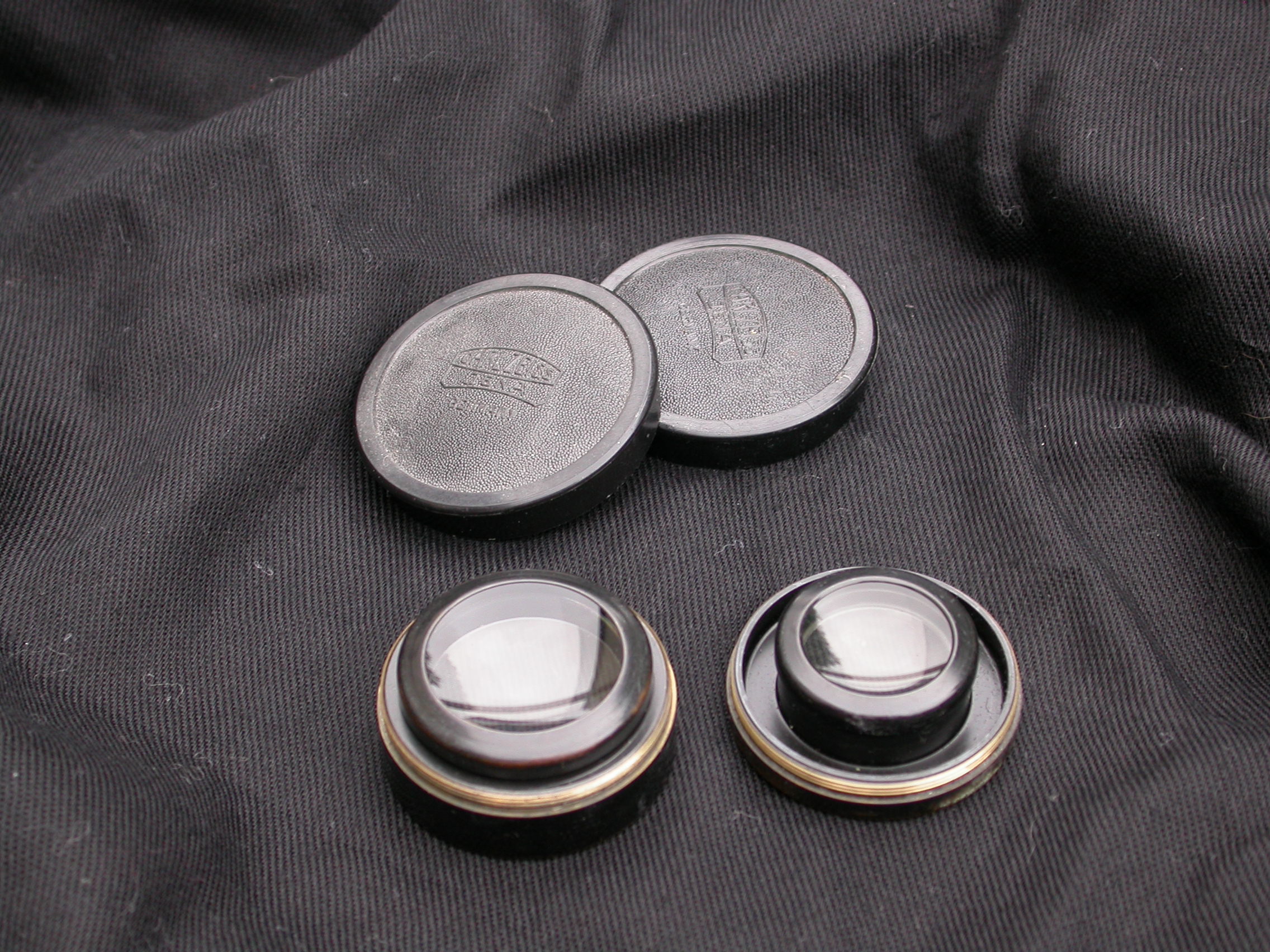

I have one each Zeiss Protarlinse cell in 22cm Series VI and 29cm Series VII. I assumed I could use these together but it appears this may not be true. Any advice is appreciated.
According to Kingslake, the series VI was nearly identical to the Dagor, and was only manufactured for a year or two and then discontinued when the series VII was introduced. The problem here is that the series VI was discontinued several years before Zeiss started using the Protar name. The series VI was called Satz Anastigmat. Maybe someone had a bad day in the engraving shop that day, and the cell is actually a series VII.
Could you post pictures?

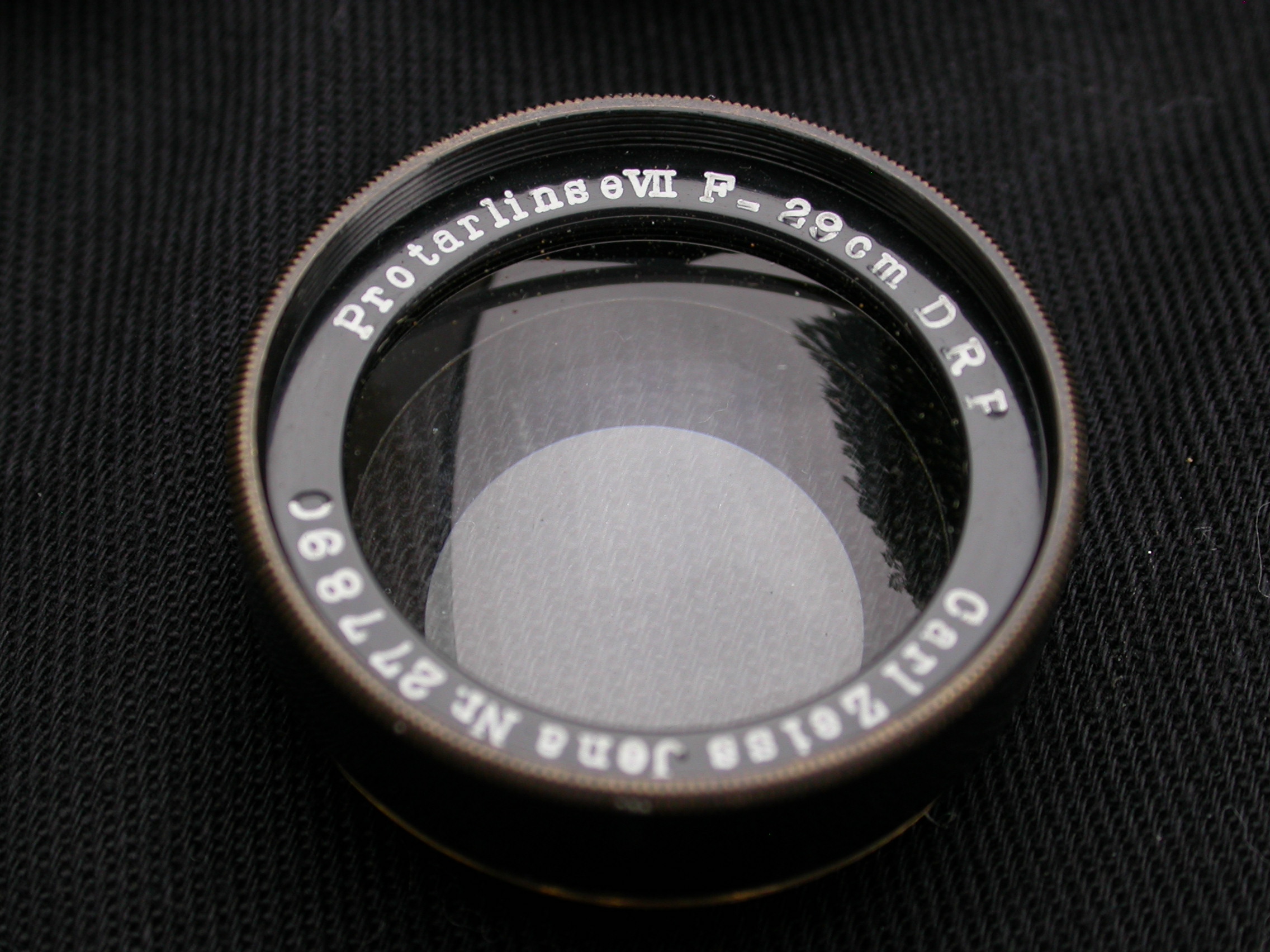

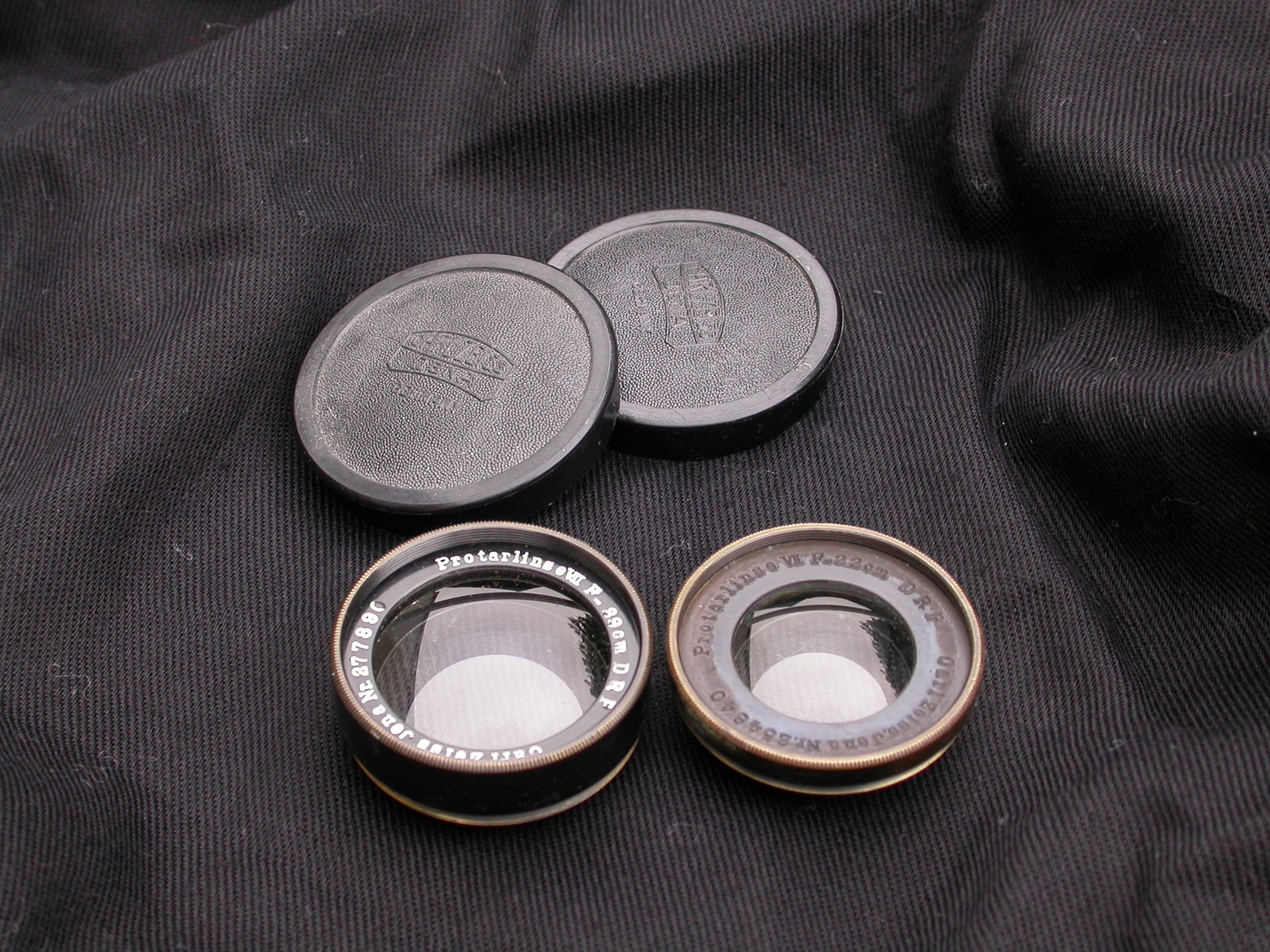

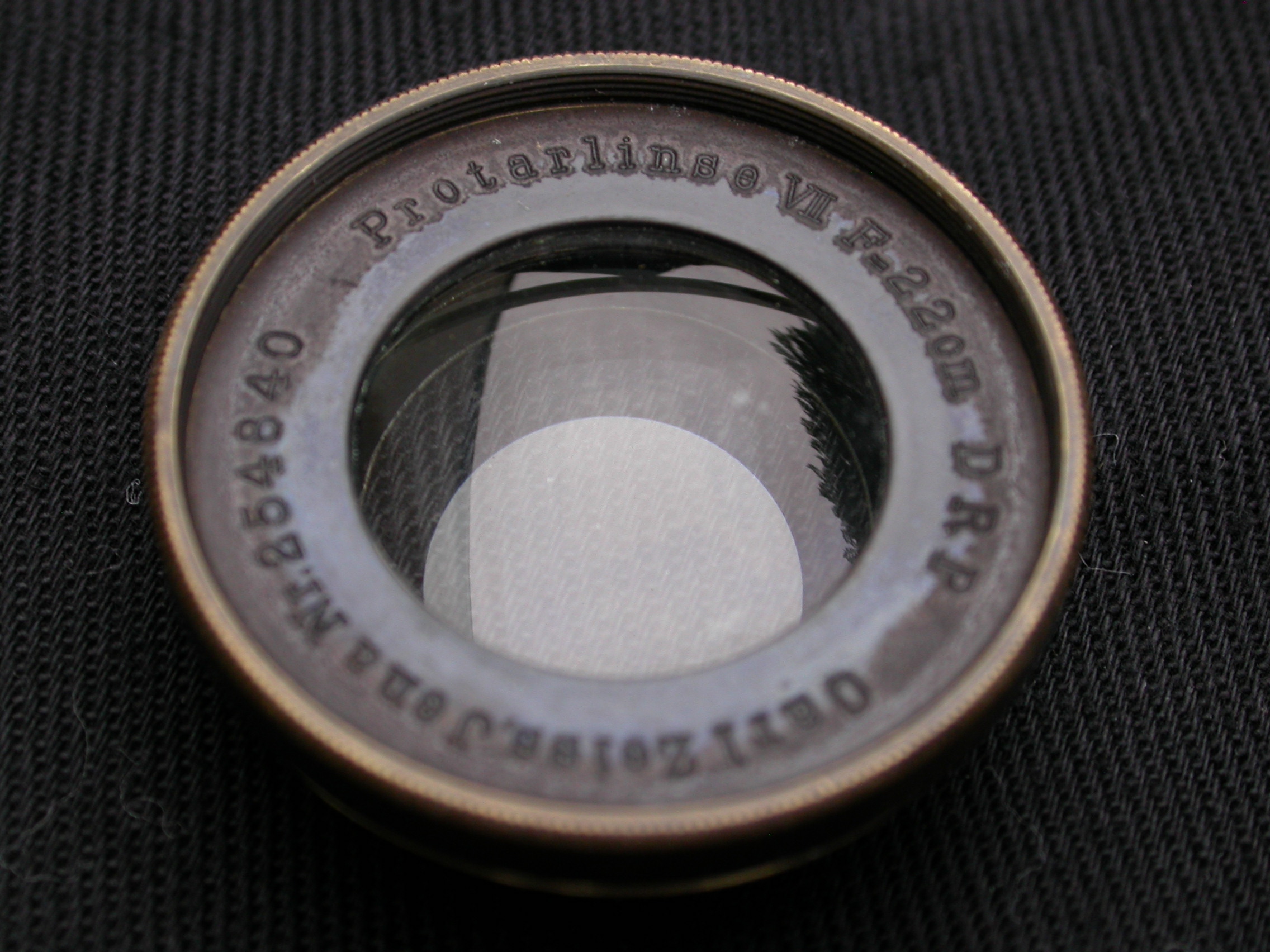

Thank you, desertrat. I goofed. After photographing these and taking a closer look I can see that both are Series VII but one appears to be of older construction. Does this affect compatibility?
View attachment 94630 View attachment 94631 View attachment 94632 View attachment 94633
Not sure what you mean by "older construction". Let me know, I might be able to help. If I'm reading the serial numbers correctly as 277890 for the 29 cm, and 254840 for the 22 cm, well these are not very far apart.
David
Thank you, David. I didn't notice the serial numbers. I guess you're right. One just looks older than the other.
