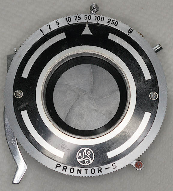

I tried to flush the Prontor-S with lighter fluids and I am afraid slow speeds still very slow after a day.
Complete dissembly can be challenging...

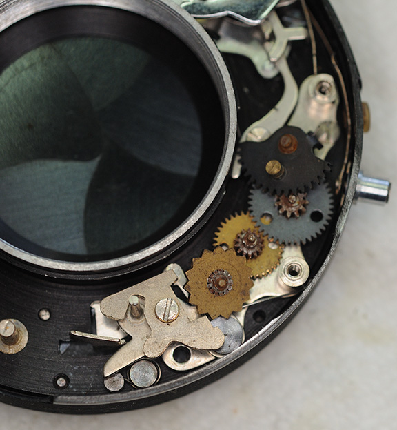

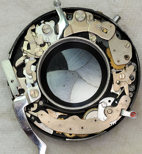

Take good pictures as you disassemble, makes reassembly much easier even with a manual.
Images from Nikon D300 60mmf2.8 macro, Phoenix ring flash
Rusted parts soaked in cider vinegar for 15 to 30 minutes then rinsed in cold water, dried and rubbed down with TriFlow oil.

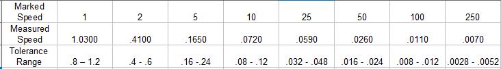

Would not fire at first then at one speed only regardless of speed setting. All parts were removed from the case, delay gear train was not disassembled, flushing with solvent and light oil is all it needed.
Now its this

I do not mess with folders either, nor do I service 35mm. The bulk of the shutters I have serviced are for large format from the late 1940's through the early 1960's. They are Graphex (Wollensak Rapax rebadged), Kodak Supermatic is its various forms, Synchro Compur, and Ilex. The usual is 1 second through 1/100 - 1/125 in tolerance, 1/250 a half stop slow, 1/400 - 1/500 1 to 2 stops slow. Shutters run until they stop working don't clean up and work this good most of the time.
