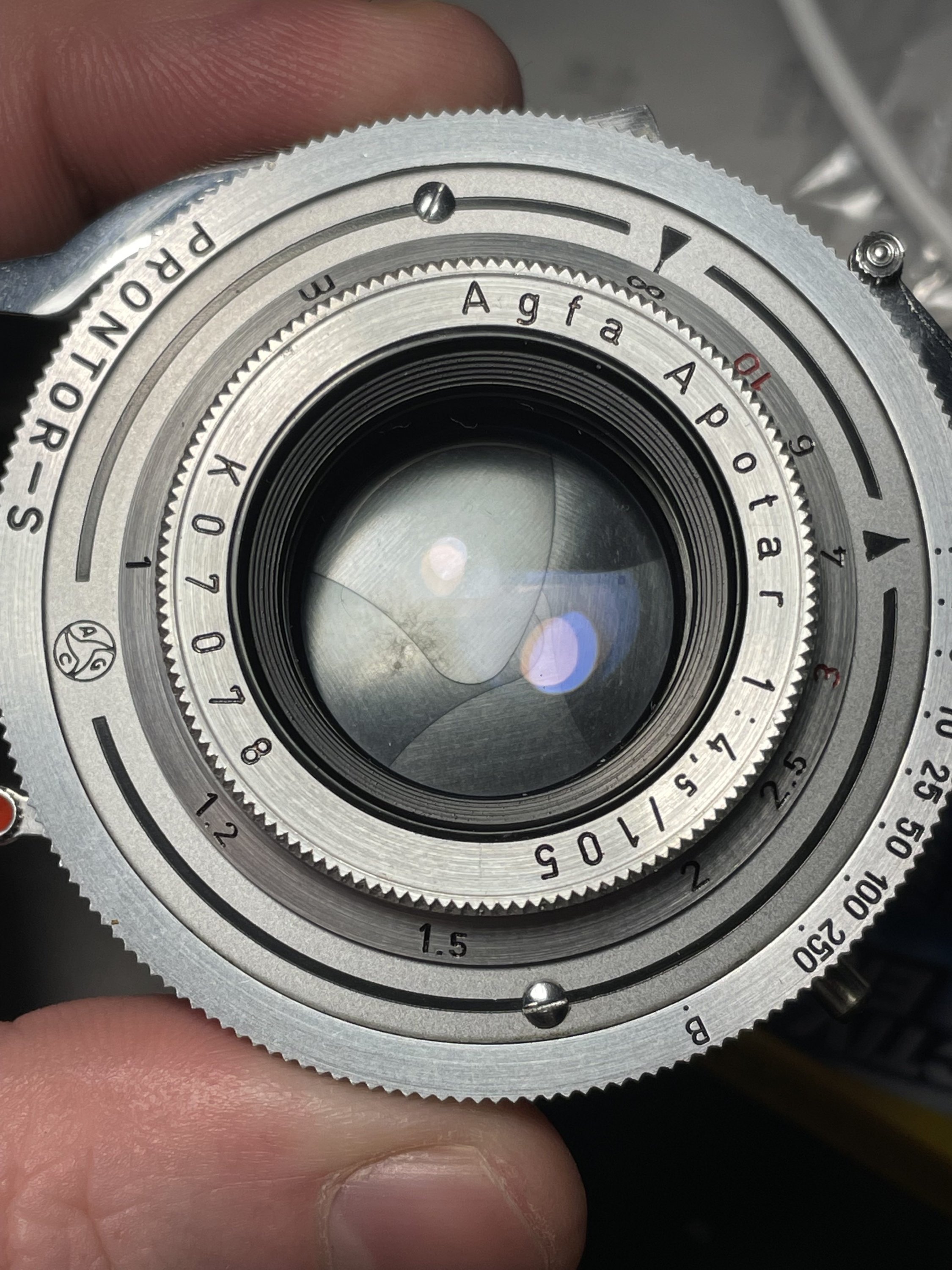

This is the position of the blades when the shutter is cocked with the self timer.

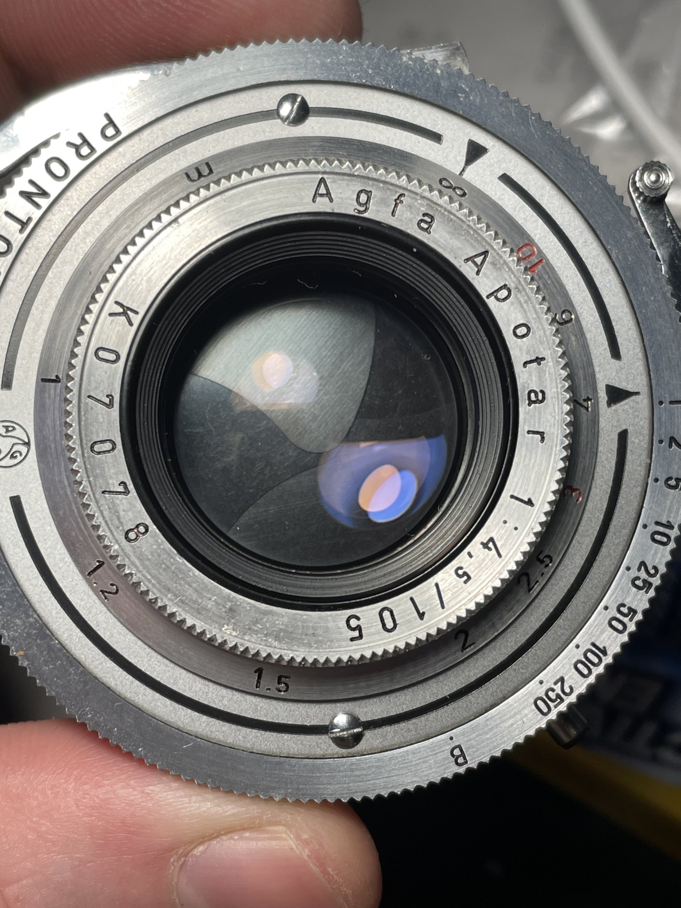

This is the position of the blades when I release the shutter
The blades do open for a bit but there should not be a 2mm hole I think. I also attached a video hope that helps you somehow.

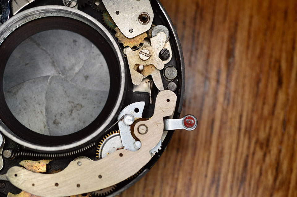

My Prontor S uncocked
Self timer set, shutter cocked No blade movement!

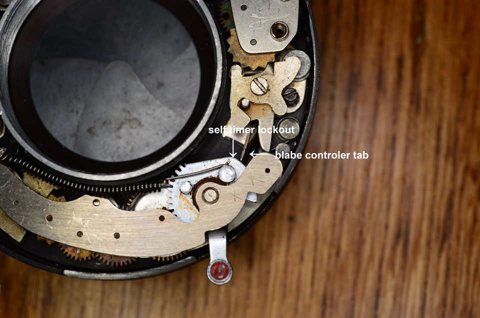

Self timer set, 0 clearance between self timer block and blade controller tab.
Self timer not set, blade controller tab has about .010 inch overlap of the self timer set/lockout, a potential problem, should be .0001 to .001 inch clearance.
