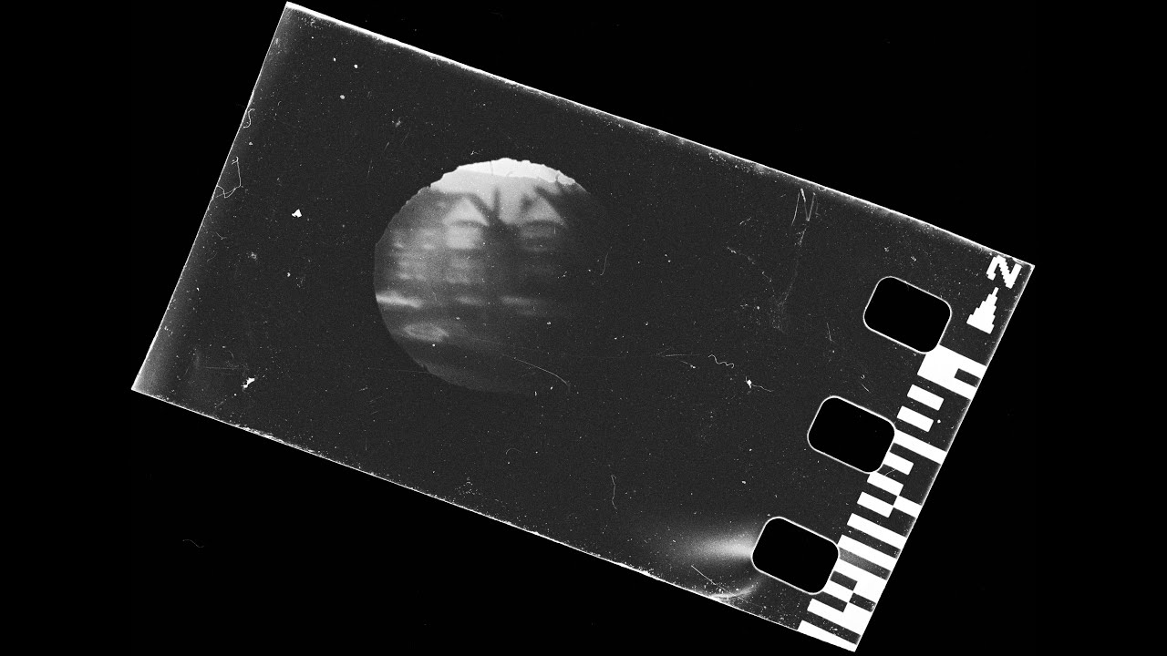

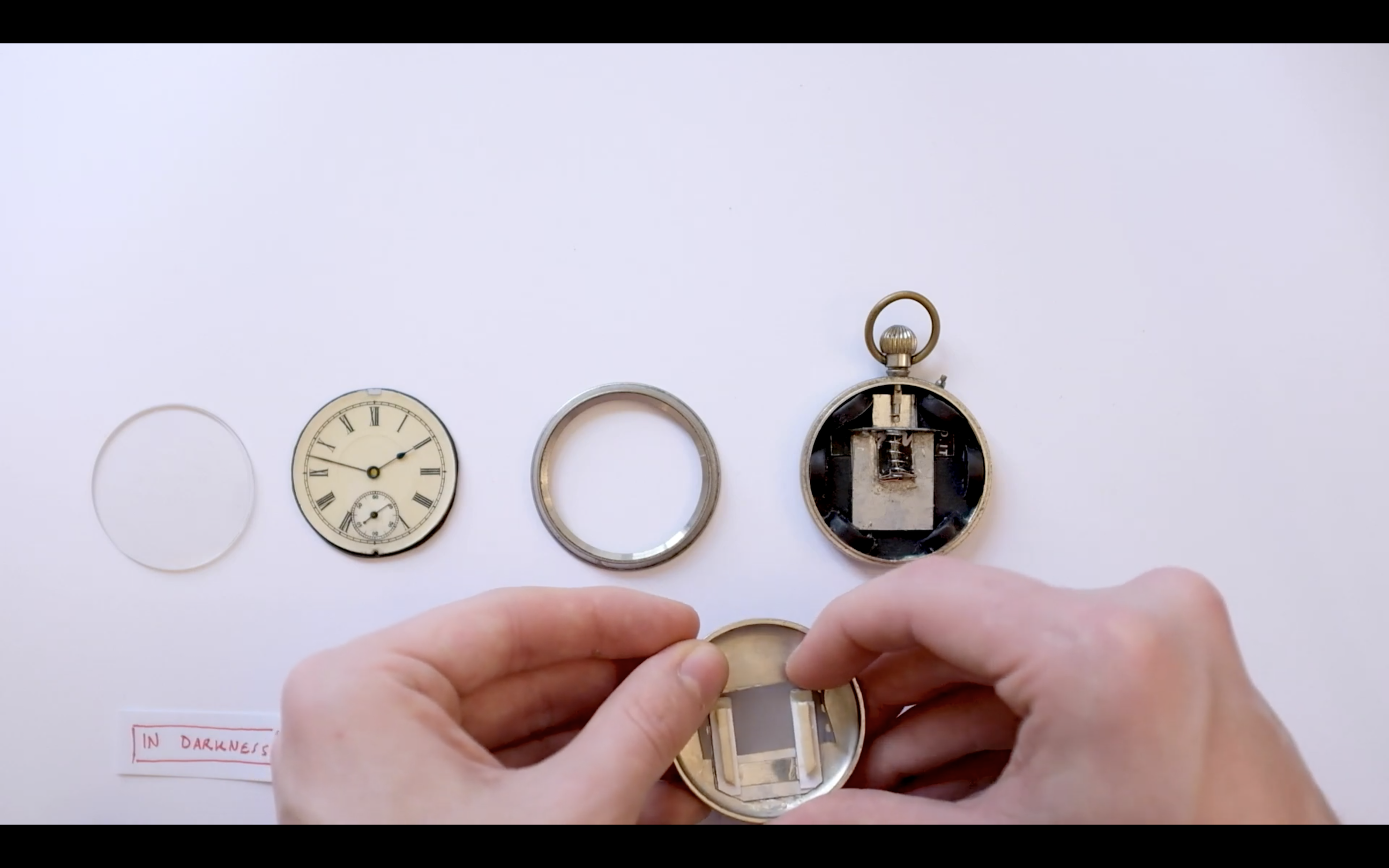

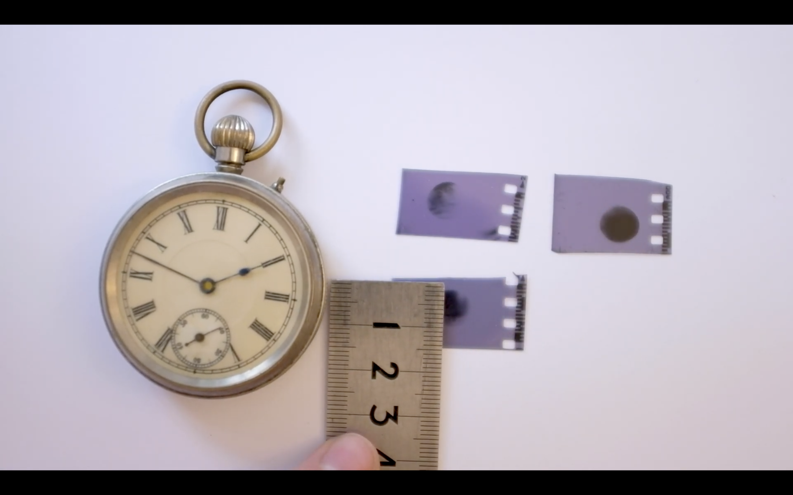

Hi - I recently did a project where I made a pinhole camera from an old pocket watch - inspired partly by a scene in the film Dr Strangelove.
I also filmed the project for youtube:
Part 1:
Part 2:
I'd like to made another version of the camera and I just wondered if anyone had any tips on how I might improve it - the images I managed to get out of the camera were discernible but not particularly good. Thanks!

An image that small has its own limitations. The general rule with pinhole is that the bigger the film the better it looks, because you don't have to blow up the pinhole blur.
That said, that doesn't look bad for a pinhole image comparable in size to a 110 frame.

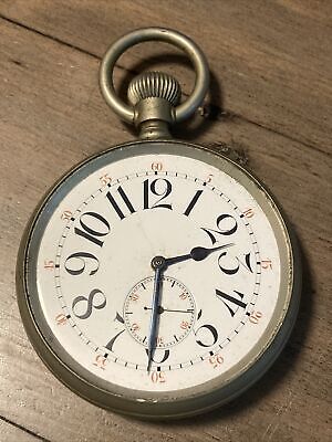

Yes, I see what you mean - I think if I could find a pocket watch that was much thicker though the focal length would be longer and I could get a larger image

You just need to use the right pocket watch. 120 film should work, and maybe you could put a roll film holder on the back.
