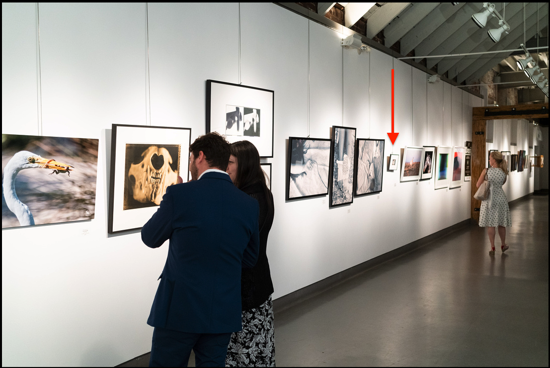

I had a tiny print accepted in a show, mostly with much larger prints...it looked like this...
