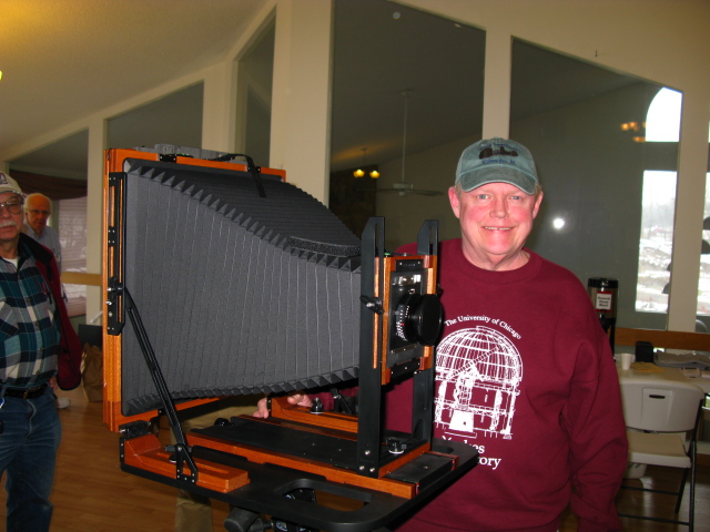

New toy
Somebody finally made me a digital pic of my new camera..
eclarke
Jun 11, 2004
1,950
New Berlin,
ULarge Format
Of course by decree of international law you have to start posting pictures made it with.
its true
nice camera ec, hope you have many years of great light with it.
monty
HA, Never get me near a scanner!! Waste of time when I could be in the darkroom!!!:D..EC
