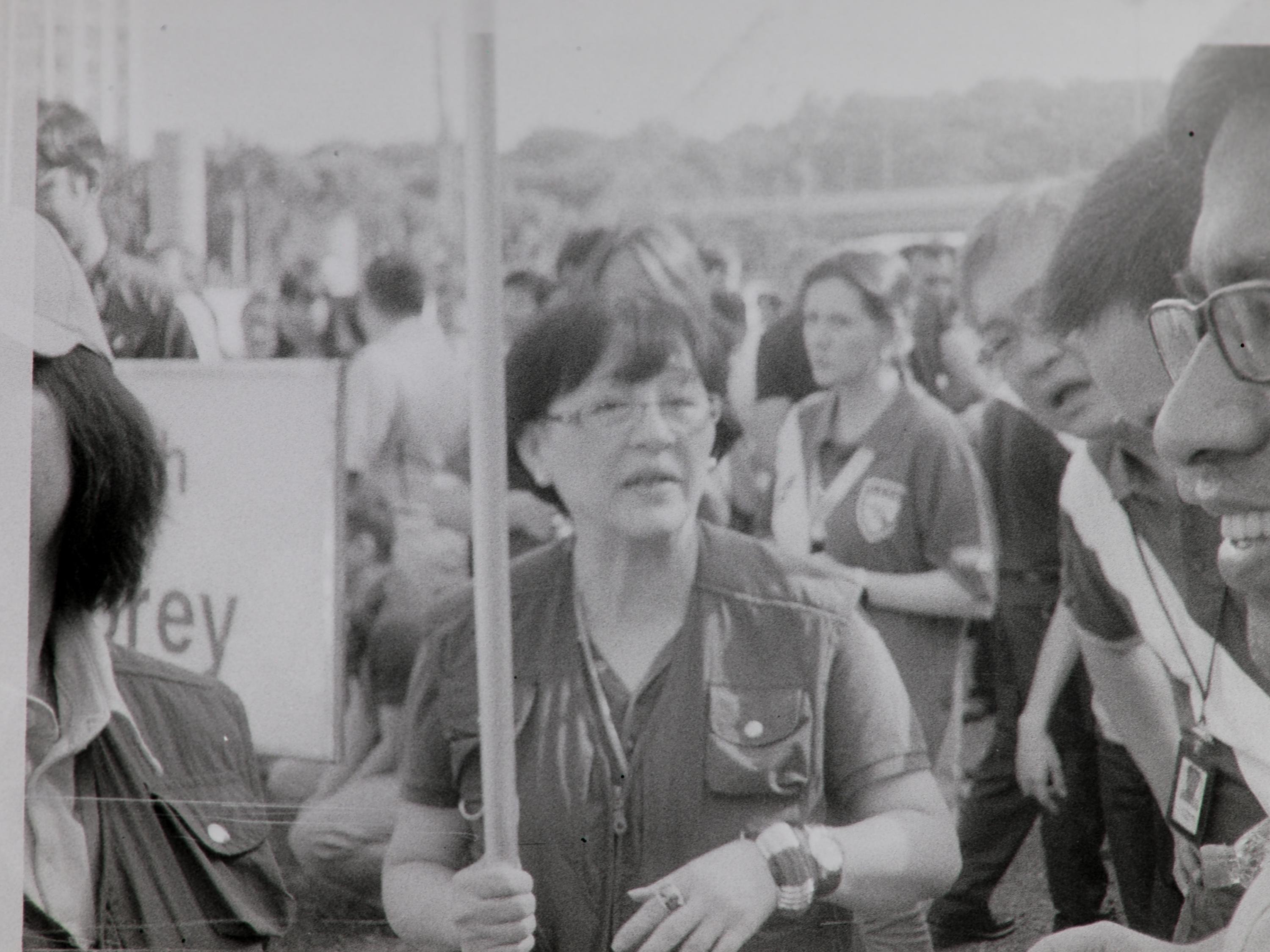

Ok tried 16 minutes at 25C, and got good looking negs with good tonal variation. On scanning found large areas of grey tended to be 'dotty' rather like newsprint, doesn't look like grain. Could this perhaps be overdeveloped?
16m @ 25C does sound excessive to me. But you haven't said what dilution you used. Might be just fine and you're seeing a tad of reticulation. Temperatures can be a trial I know when the tap water is close to 30C as we have in the summer. Good luck, seems you are on track.
Sorry, dilution 1+9 Ilfotec dd-x. If it is reticulation is there anything that can reduce it? I have seen some quite passable images in b&w on 110. Will post an example later so you can see what I am getting at?
Processing in a temperature controlled jobo rotary processor with continuous auto reversing agitation.
Dev time is 16 mins @20C, I processed for about 12 mins @25C
If you view the photo full screen, you can see what I am getting at. the grey areas. particularly faces appear "dotty". is that a function of frame size or development?
Looks over developed ... That's what mine look like when the film is too dense from overdevelopment and scanned.
Pretty good detail for 110 though.
Not being too expert at this, I thought that might be the case, get a similar effect if a PCB is left in the ferric chloride too long the copper tracks get eroded.
Reckon I'll shave two minutes off of the dev time at 25°C and give that a try.
