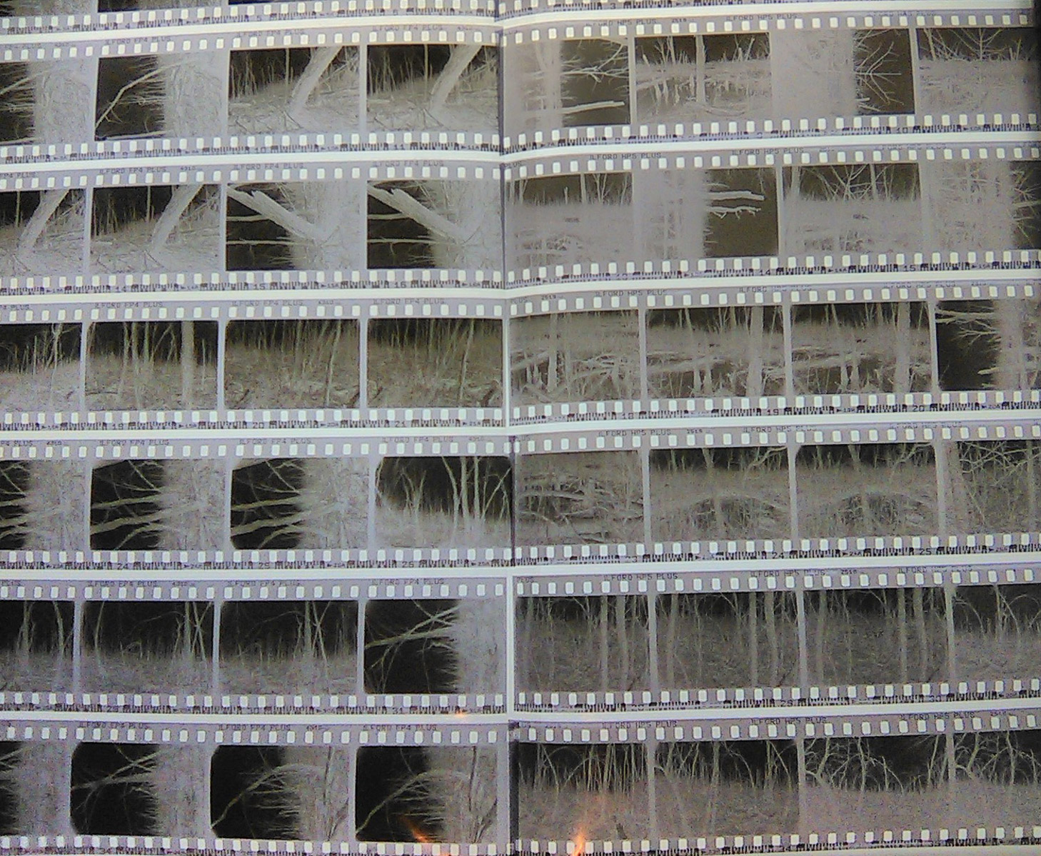

I tried it out the other day, and the results seem fine. With the water at room temperature I was getting development times around 25 minutes.
FP4+ looks to have more contrast than the HP5+. Hp5+ looks similar in contrast to the results I got with Tmax 400. I still have to scan them.
FP4+ is on the left, and HP5+ is on the right.

As was to be expected, there's a very big difference in the gamma/contrast between the films. Processing them in the same tank was evidently not the optimal solution.
However, underexposure is a bigger problem on both films.
