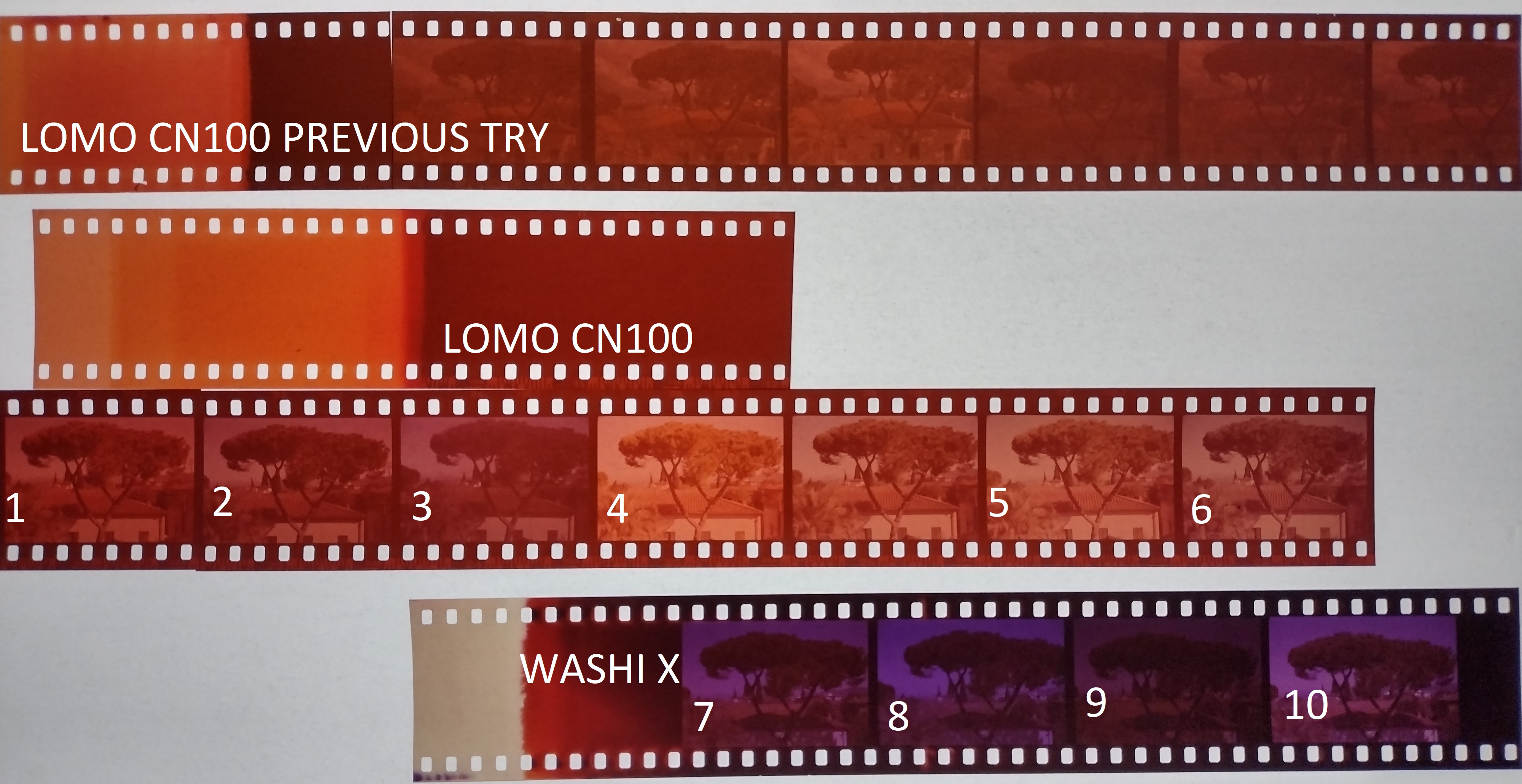

Following (not really) your suggestions, I made another attempt using XT-3 (Xtol) as FD. I bracketed with and without cyan filter (cokin 050) and used two different films: Lomo CN100 (as before) and Washi X (Kodak Aerocolo IV as far as I know).
These are the times (everything was developed at the same time):
-XT-3 Stock 15min 20°C
-CD 9min 38 °C (I still need to determine the exact time for developing to completion)
-BLIX 15min 38°C
These are the results:
Lomo CN100
1: +0 stop, no filter
2: +0stop, 1 cyan filter
3: +0 stop, 2 cyan filter
4: +2 stop, no filter
5: +2 stop, 1 cyan filter
6: +2 stop, 2 cyan filter
Washi X
7: +0 stop, no filter
8: +1 stop, no filter
9: +0 stop, 1 cyan filter
10: +1 stop, 1 cyan filter
My oservations:
all these photo scan really bad (I'll let you know which ones are the less bad when I am done scanning).

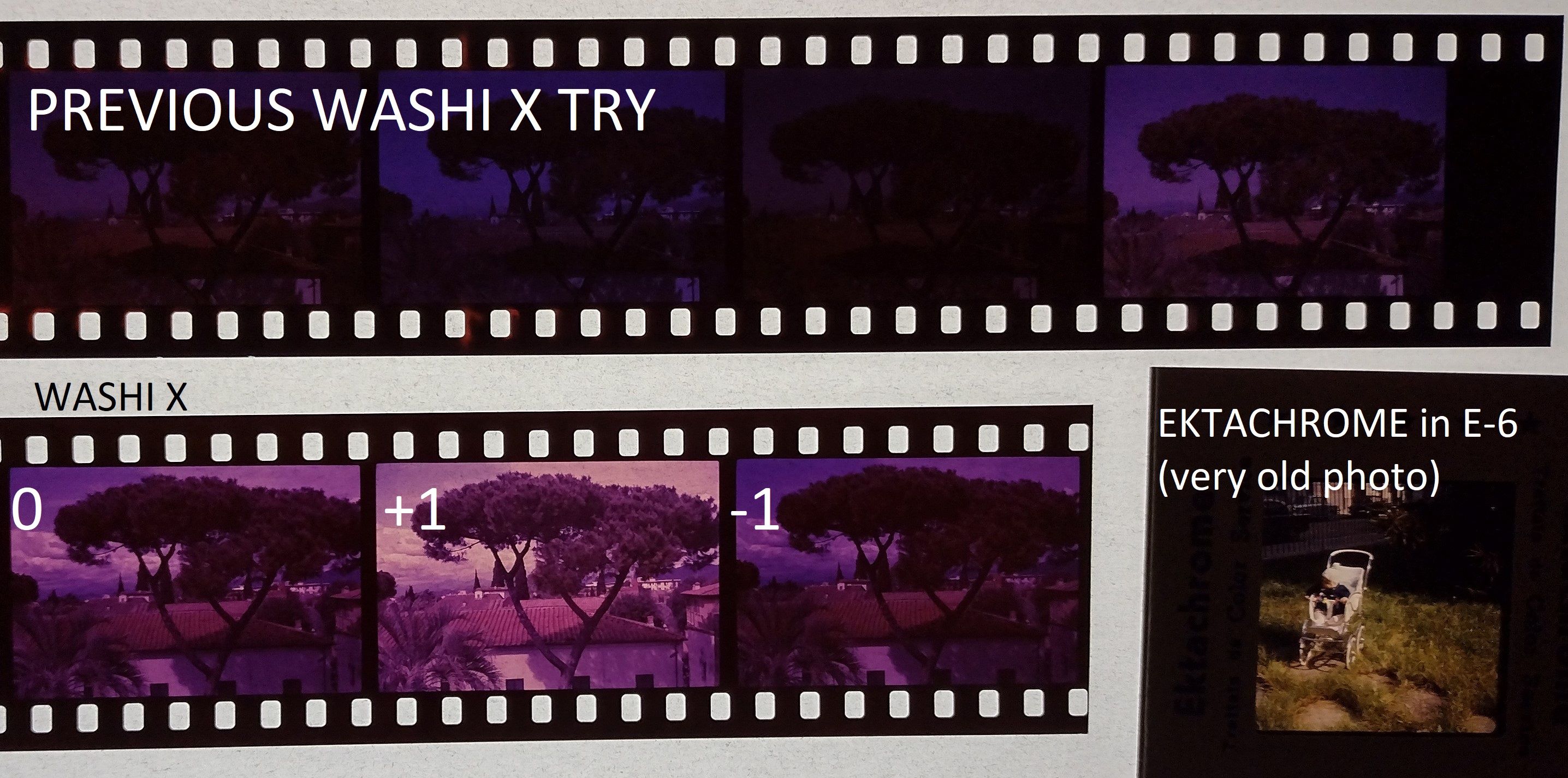

Washi X was really disappointing, but for sure it does not need the filter, I don't know what I did wrong there.
The leaders are almost identical in Rodinal/Xtol development, so I guess that Rodinal doesn't affect in a significant way colors.
So, what did I do wrong with Washi X? How can I get decent slides with it?

Done. My sincere apologies for doubting. By far the best results I got. Xtol stock 6,5min 38°C, light, CD 12min 38°C, BLIX 15min 38°C.
No filter was used.
