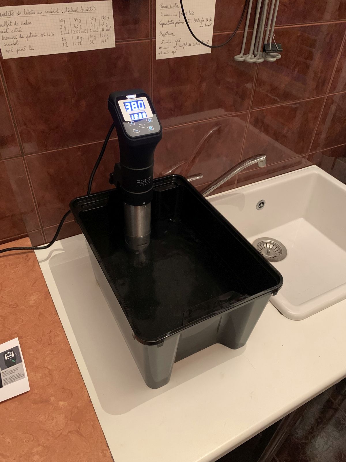

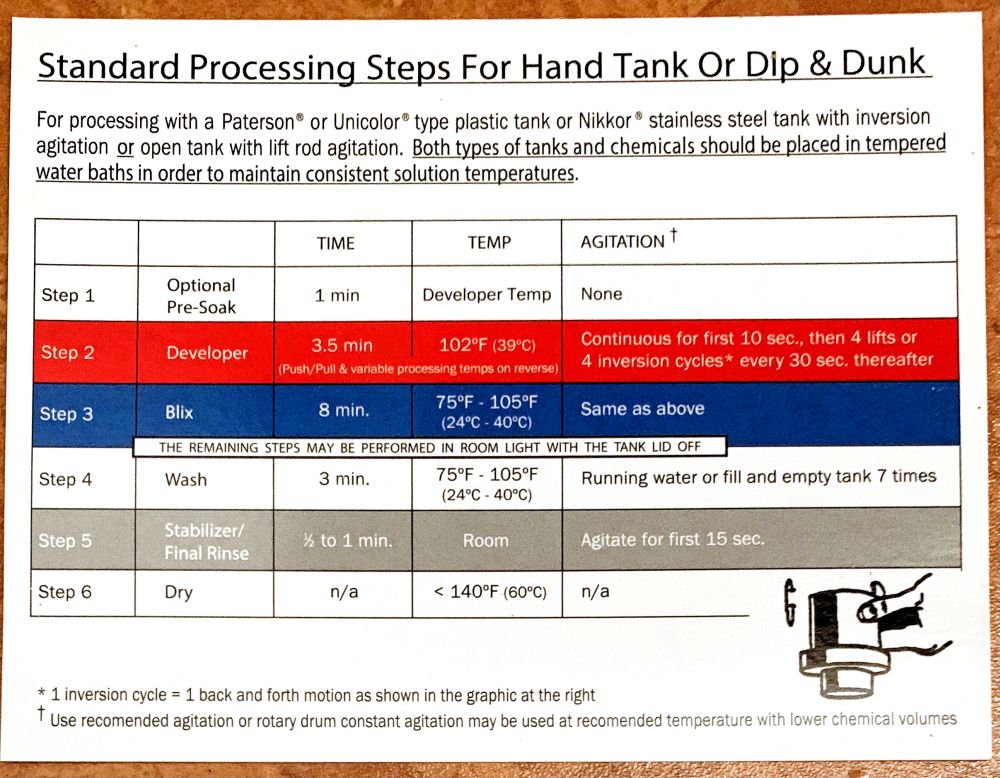

Update: I got a sous vide device with a rated maximum capacity of 30 litres, plus a 20 litre plastic container that's large enough to hold four 1 litre bottles and the development tank.
Then I got a CineStill CS41 colour simplified kit. It consists of a three-component developer, a three-component blix, and a stabilizer. The instructions couldn't be clearer.
What strikes me is that they recommend a temperature of 39 degrees Centigrade, rather than the standard 37.8. But anyway, it's their kit, so they must know. I'll trust them on this.
But I have a problem. I've got a professional Greisinger digital thermometer, which is supposed to be accurate to a tenth of a degree. When the sous vide device says the water is at 38 degrees, my thermometer shows 35.6. And I don't know which of them to trust.
Should I trust the thermometer? Are these sous vide sticks known to be inaccurate? Or are they known to be accurate, and my thermometer is off?
There is usually significant heat loss during the pouring of the liquids which means its better to aim for a higher temp since you will lose about 1c when you pour in the liquid. And then if you don't have a water bath for the development tank, you will lose yet more temperature. So that is probably why the recommend 39c instead of 38c.
Trust the thermometer for sure, my sous vide shows about 1c hotter than it actually is.
AgX
Apr 5, 2007
29,972
Germany
As you said, Greisinger make professional tools, and they give in detail the error for their tools. Even their cheapest model was stated to be used as reference for other systems. It is them to trust and not a unknown kitchen appliance manufacturer who only states the resolution of his device.
Yes, but on the other hand there's a note in the instructions (I mean the complete instructions, not the quick guide I posted above) which reads: "When not using a temperature control bath add 2 °F (1 °C) to the developer before processing". This seems to suggest that 39 °C is the actual development temperature, not just a starting point under the assumption that it will drop.
Or maybe they expect the temperature to drop anyway, even with a water bath, just not as much as without one?
As you said, Greisinger make professional tools, and they give the error for their tools. It is them to trust and no a unknown kitchen appliance manufacturer who only states the resolution of his device.
That's settled then. I will trust the thermometer.
Thanks.
