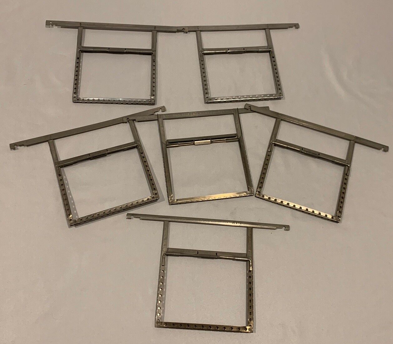

I saw one seller - "Black and White King 4x5 Reels" - but can't find them on Freestyle or B+H - and they seem to ship from China. Wondering if there are any other solutions.
I have the 4x5 B/W King tank, and recommend it.
Thanks, Alan. The B+W King is going to be my next purchase if the Stearman Press SP-445 I ordered yesterday doesn't work for me.
The Nikor tanks, and the the current production B&W King stainless tank (holds 10 sheets) both take a little over a liter; they're larger diameter and a little taller than a 2x120 stainless tank (though I have a pair of 220 reels for my large Nikor, for which I've never had the 4x5 cage).
B&W King is a very good tank, and in my opinion better then the old Nikor. I have both. The maker sell them only on e-bay and shipping very fast and affordable. The maker is a very responsible and nice person.

You can easily find stainless steel hangers and tanks on e-bay. You work in total darkness, of course, but it's not that hard once you practice a bit. Agitation consists of lifting the holders up out of the solution, then tilting them at an angle to let the developer run off in a corner, then repeating the process in the opposite direction. See:
