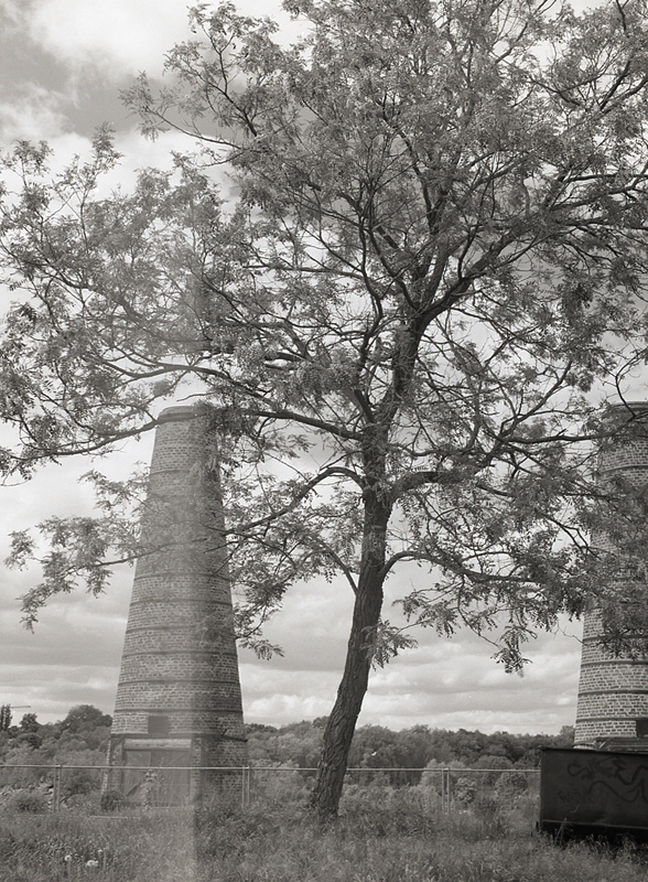

I have a Mamiya M645J, which gave me several problems lately and I am not sure whether it's a light leak or a problem with the shutter curtains - or maybe sth else. Any ideas?
(The problem occurred with the last 2 films. At the first film of these two, it was just one picture; at the 2nd film, it happened several times. I haven't used the camera since.)
Your help is much appreciated - thank you very much in advance.

This is a common problem but I don't know the cause. It is a shutter fault. I am hoping a comprehensive answer will be presented.
In the meantime you might try a fresh battery.
No its not.

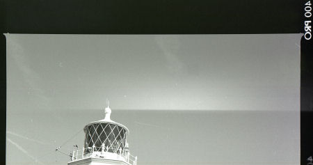

It's light leaking in around the catch for the back door. This exposes a strip of the film exactly as shown. I know this because I had exactly the same. I replaced the back door foams on my new-to-me M645J and stopped the foam strips just either side of the catch, figuring the bit of metal on the back door over the catch mechanism was a light trap - wrong!. First film I shot was OK - prob because I shot it over a short period of time in subdued light. Next film I was carrying the camera around in sunlight and ended up with exactly this strip across the neg. I bet if you look at the neg itself the dark stripe extends beyond the exposed area to the edge of the film. I re-made the seal making sure the foam was continuous around the catch. Get your seals sorted and all will be good.
quick scan of top of offending neg
Wow, thank you, Mr Rusty! Yes, it does extend indeed.
