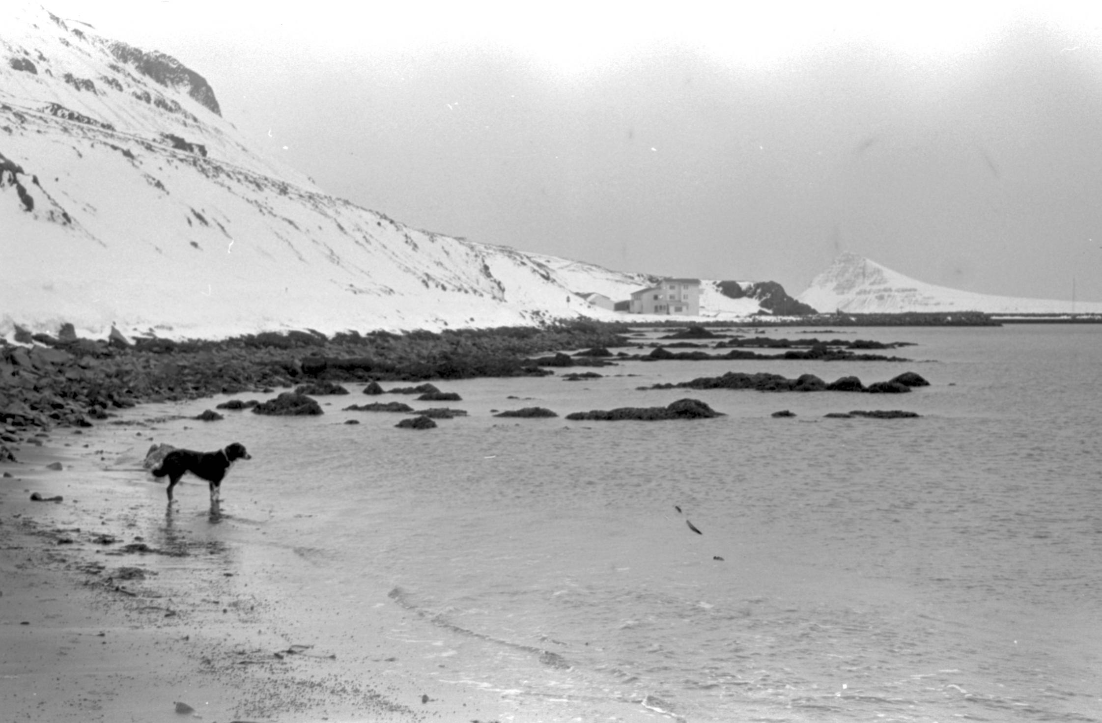

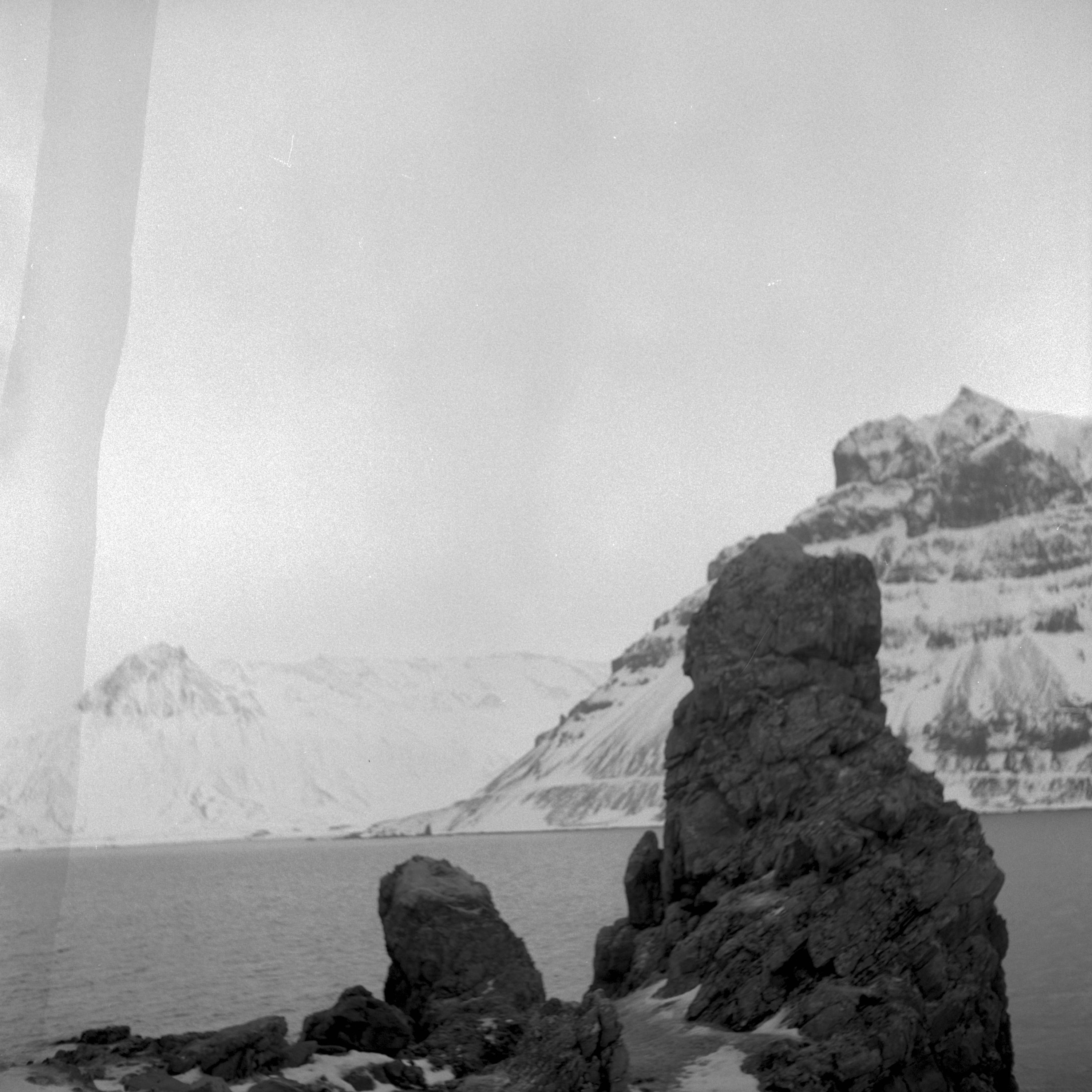

I first developed a set of rolls and it became clear to me I was getting something wrong, for some time.
I had white streaks on the side of the negatives.
Examples
I realised I am probably pouring in the developer far too slowly, and filling the tank so it overflows and maybe not agitating properly (although I think my agitation is alright), obviously I am doing something wrong, after reading and researching this is what I came to the conclusion what is wrong.
Please correct me if you think it´s something else.
Examples of above is the photo of the mountain and one with the dog, taken on and a Leica.
So I developed new set of rolls, and on one the white streaks were almost eliminated, and on the other a new problem occurred.
for the one the new problem occurred this is my method.

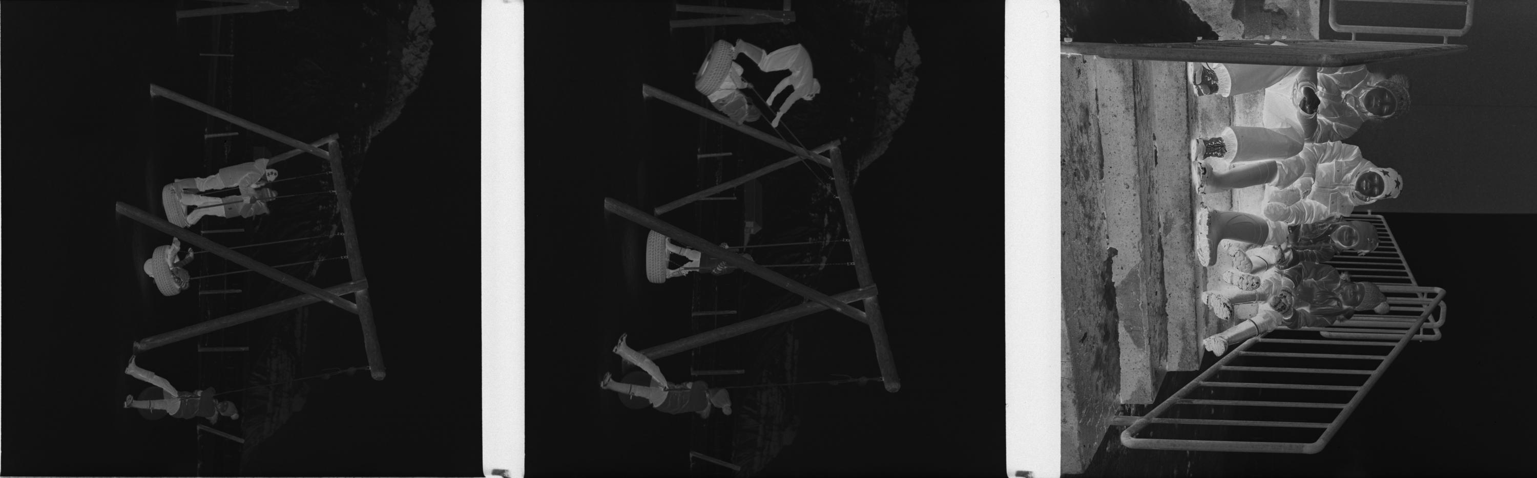

Photos are the ones with the blackish streak in the middle:
Foma 100 in Rodinal 1+50Fomapan 100 in Rodinal 1+50
Agitation: 0-30 sec
then twice each 30 sec.
Agitation method: Invert rap on table, invert rap on table.
Inversions are quite fast and according to this:
www.youtube.com/watch?v=tOUUO3dDLqA
Stop - Ilfostop 1 minute.
Kodak Rapid Fixer - 5 minutes
HCA- 2 minutes
Wash - Ilford Method
Flo - 3 drops swirl for 30 sec, stand for one minute.
The second roll my method is (photo of the playground) - streak is slightly visible:
HP5 in HC-110 Rodinal Combo
Developed in HC-110 H dilution 1+63 with 2.5 ml Rodinal added.
10 minutes. Presoak
Agitation: 0-30 sec then 4 times at 1, 4, 6 and 9 minutes.
Agitation method: w 2 quarter turns right with tank on table - invert rap on table then 2 quarter turns left invert rap on table.
Mixed 400 ml in a stainless steel tank.
HCA- 2 minutes

The light edges on the first two either came from extra exposure (maybe light leak) or extra development (maybe the developer not getting in the tank quick enough).
The streaks look like a little water or developer got to the film before the developer flooded the film.

Picture 1 - top right circular mark could be a kink in the film, perhaps from loading on the reel? Top band looks like a light-leak
Picture 2 - band on right looks like same light-leak
Picture 3 - is that a rinse streak artifact that has shown up on a scan? Was your developer can full enough to exclude uneven processing?
Picture 4 - same as above

The first two where you have lighter sides are from your developer handling. Getting it in and out of the tank and initiating your stop. I had the same issue when i started.... Took me a bit to figure out but since then I have had no further issues. Disclaimer: I am speaking from my experience with 135 film only, I have not developed MF:
1. Get your developer in and out of the tanks quickly.
2. Initial agitation is important, do it well. <--This doesn't mean hard, just good.
3. Stop quickly and thoroughly. I use a water bath stop. Before time is up for your developer make sure you have water running at a high flow (full open out of my faucet) and for long enough that temperature has stabilized where you want it to be (developer temp is what I use). Quickly pour out the developer and place the tank immediately under the faucet to fill. As soon as it fills completely with water begin pouring it out and agitating it vigorously while it pours (I actually cover the top with my hand and give it a good shake a few times before I start pouring it out). Repeat this at least 8 times. After the first few fill & drains you really don't need to agitate any longer. It probably isn't necessary but I do a running water rinse after the 8 fill and drain cycles for the remainder of the two minutes since I started or until I finish getting my fixer ready to go, whichever is longer.
Since I started doing this I've had no further issues as shown in your first two photos.

Ok,
So sometimes it's easier to judge what's happening if the negatives are well negative. :wink:
Here is the strip of 3 frames.
Also I uploaded a video showing how I agitate, perhaps that helps.
https://www.youtube.com/watch?v=1diDvZcK6ik
Also it took me 10 sec to pour in the developer and similar to pour it out, I did it again today, when I think how I agitate, I can hesitate, when I do it "naturally" like in the video it flows, but is it random and consistent enough?
I manage to do 3 quicker ones in 5 sec and 2 slower ones.
2 feels more natural.I have not been able to scan the results yet, it´s hard to see on the neg itself.
It would be great if someone could check the negative strip, perhaps it´s also enhanced by scanning and then using colorperfect. I use that and vuescan, but I want to print these later. Maybe as the neg has problems being flat in v700 scanner. Maybe I need to purchase those betterscan thingies, but they are expensive and I prefer to print. Or perhaps the scanner needs calibrating or something is wrong. There definitely was an issue with the first set of negatives (the mountains in 135), but I am starting to think maybe it´s also scanner related. Will book a time in our communal darkroom soon and check. As I think the second time, my method is not far at all from what the expert describe. Presoak or not, stop or not is not the issue and I did agitate enough (maybe too much), but I think better than previously at least.
I want to do something with this series from the north (I went to one of the most northern tip) At least this series from the north. Let me know by PM if you want a better quality of the negatives as I have uploaded it via dropbox in case.

I'm thinking that your idea of going to the commercial darkroom with your negs is probably the best way to find your problem.
The reason it's sometimes easier to judge a negative when negative is that you don't have to translate. Darker areas got more exposure or more development. Light areas less.
If there are issues on the last set the scanning enhancements seem to be hiding them now. Way to dark to see.

I definitely think my first two images (on the previous) page was due to pouring, I think I even hesitated once.
Maybe I should refix, it was a bottle that was previously mixed (bought last autumn) in a 750 ml wine bottle, full to the brim, with gaffer tape around the opener and it has done maybe 10 rolls.
For the very first batch it was a brand new fix, just mixed - done 6 rolls, so unlikely to be that.
I think - for the first two images it definitely is an agitation thing, now I have learnt by those mistakes and I am pouring quicker and for these two last rolls I also agitated quite firmly, maybe even too firmly.
