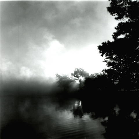

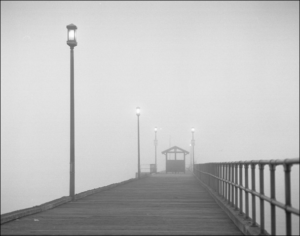

Excellent examples Steve! Fog is a great tool for exagerating or delineating distances in the same way haze on the horizon helps put some sense of scale to a landscape, only closer. My first example in B&W also had the sun shining through it, the second shows a fog bank shot from outside its influence. Experimentation will reveal more ways to utilize fog, this by no means defines all you can do with it.

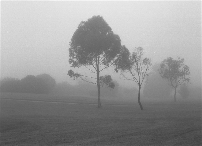

Of the few times I've been up early enough to see fog and had a camera handy, I've metered off something 'normal' looking (usually nearby) and developed the film normally. Thought I had a example of a valley filled with fog but haven't got a scan of it.
