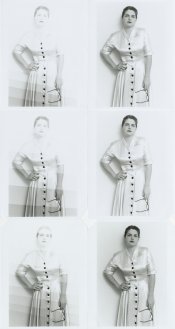

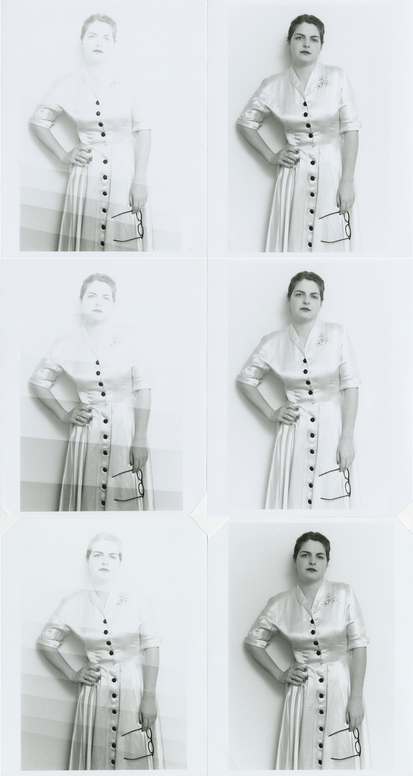

Here they are (not in any particular order, but marked so I can ID the method):

OK. Time for me to stop beating this horse.
